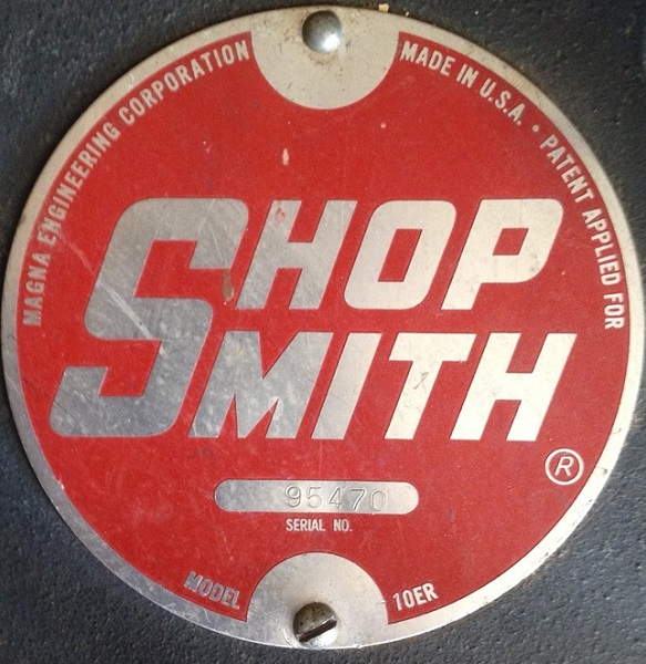

I recently was in communication with Skip regarding some of mine and he found it interesting as he put it; "You have one of the first 10E machines (1414) from late 1947 and one of the latest made (95470) from late 1953"

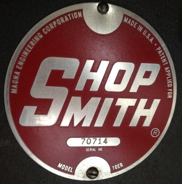

I have 10ER 70714 and another that is too far back in the stack to photograph at the moment. I will try to get that one and update it by the weekend.
Terry, after stating “My 10E has Serial # 8443; My Logo tag says San Francisco”, asked in the first post in the thread “Does anyone have a Shopsmith that has Cleveland on the Logo?”

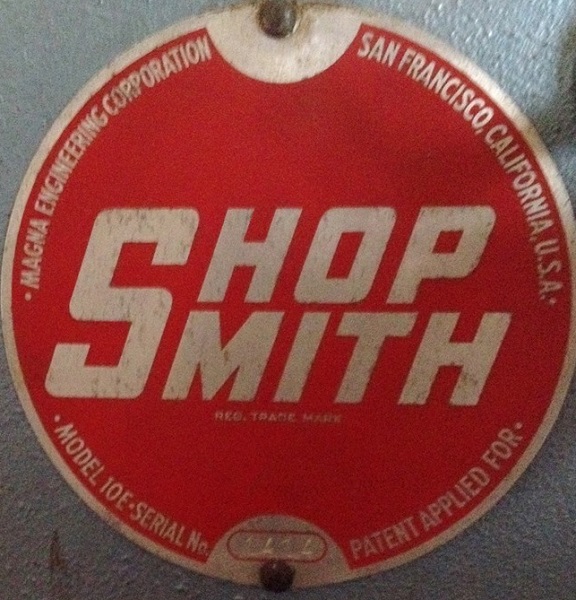

I can pretty much show with certainty, not badged for a 10E or 10ER in Cleveland, based on the badges I list below for mine, but there were retrofits, upgrades and refurbishing going on as well. There are some other badges, but I have not seen one with Cleveland yet.
As you will see, all reflect San Francisco and the later two reflect only “Patent Applied For” but my oldest 1414 also says “Registered Trade Mark” on the badge below the logo. That machine is blue.
Also there is a discussion somewhere about some of the earliest units being blue.

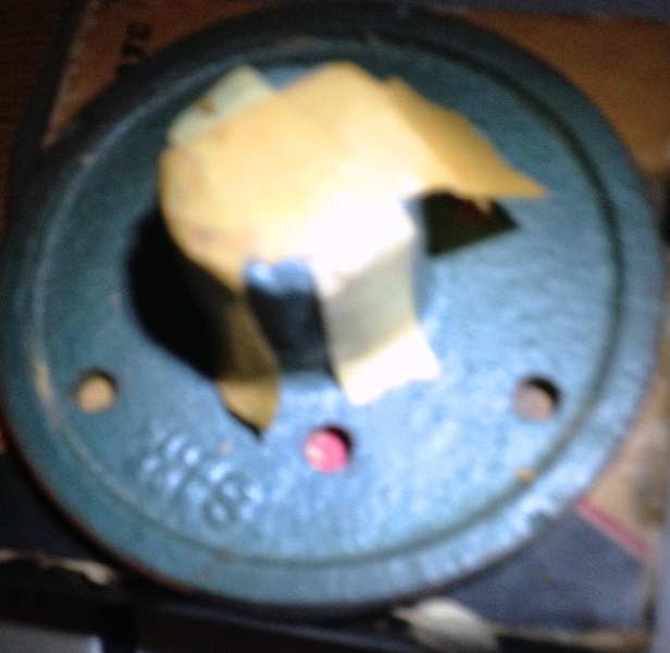

Skip and I had a conversation about 10E 1414 being blue, which it is, and thinking it was repainted as there was some overspray blue in areas. Now that I have done more research and closer inspection of it, I believe that overspray was indeed Magna factory painted.
In support of that belief, I also have a NOS 84-2982 Magna 3 ¾” Face Plate in the box with a segment of the original tape on it, that is an identical blue color that I acquired separately from stock in another state half-way across the country.
The paint matches, and it would not have been painted as NOS if it was not the color of that series of machines made at that time.
Like all paint it has faded some with time, but they faded to the same patina in blue and were 2000 miles apart. The early 10E’s, I conclude were indeed blue. Later units were changed as we all know.

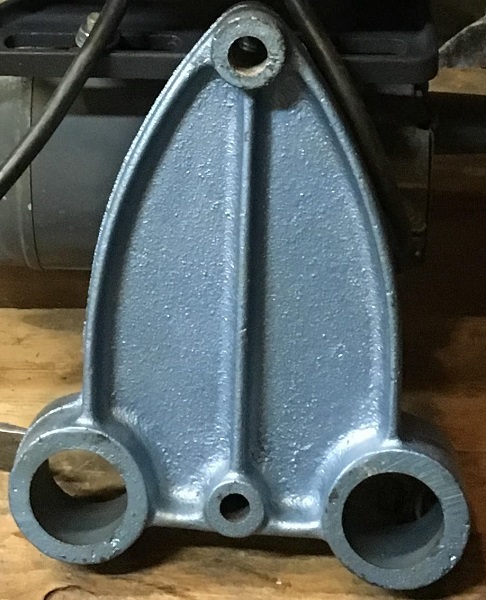

Tailstock from 10E.jpg (109.46 KiB) Viewed 8218 times

The Tailstock photo was taken by Dave H in his shop in Colorado before I got it to Texas. The Headstock photographed outdoors is that same blue as the Tailstock photographed indoors, with yet a different camera.

One more, for the record. 10E serial number 1750. Sand-cast headstock. Gray wrinkle paint on all the painted parts. To the left, in the background, see the white pegboard, white landscape tape, and blue landscape-tape housing for color references.

Interesting – The Badge on yours shows Reg. Trade Mark as well, but the Serial number field also has a Red E in Paint in front of 1750 opposed to my 10E (1414) that did not have the E.
I wonder when that changed. There are only 336 machines between the two.

I noticed sn 1200 from Australia posted last year is also a blue color and that photo has some other blue items in it to reference the blue variance. It looks a bit dirtier, and has an age tint, but very similar to my 1414.
It's badge is just like mine, but the serial number stamp looks pristine - 1200
