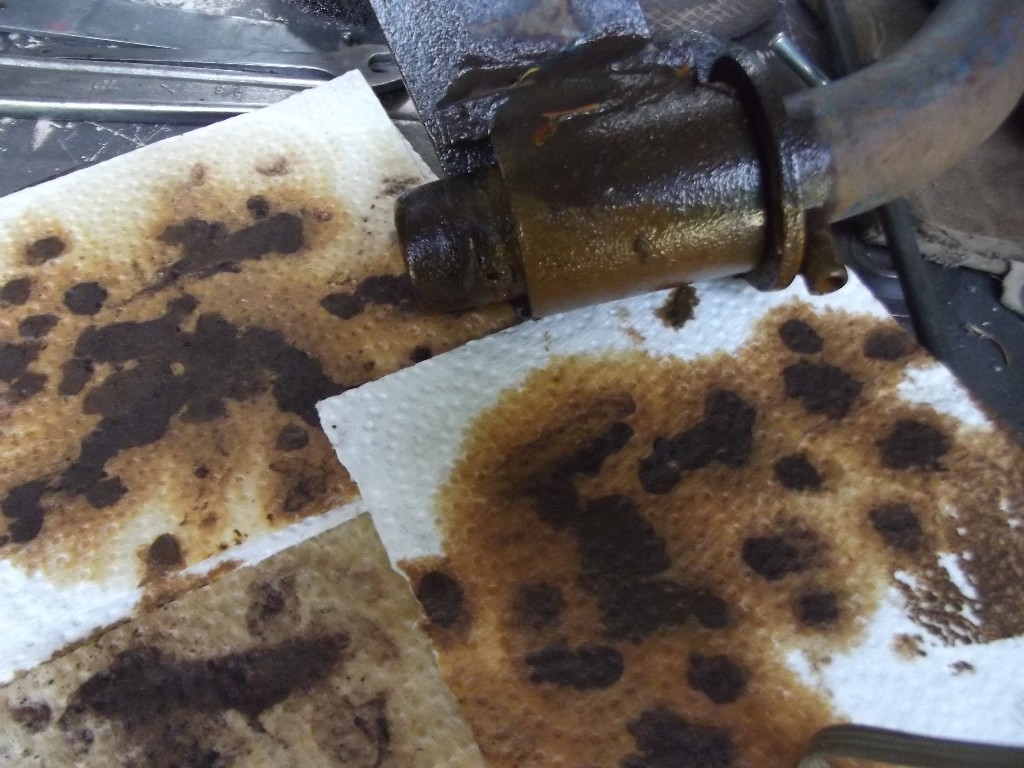

This was the seized Coulter wheel of my Ford 110 plow. I was just dribbling Amsoil MP on it and without rubbing this is the result . . . first the dark chocolate brown and then the lighter brown rust.

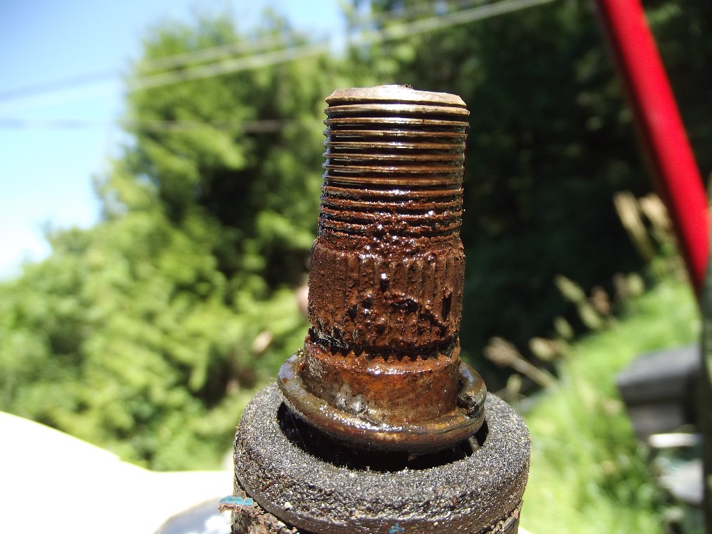

The second photo was when I pulled the steering wheel from my '53 tractor. that lumpy looking rust on the splines is actually a rust pudding that was drooling down the shaft. I only let the MP penetrate for 20 minutes while I made up a steering wheel puller.
