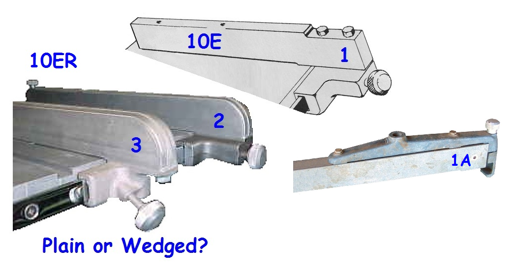

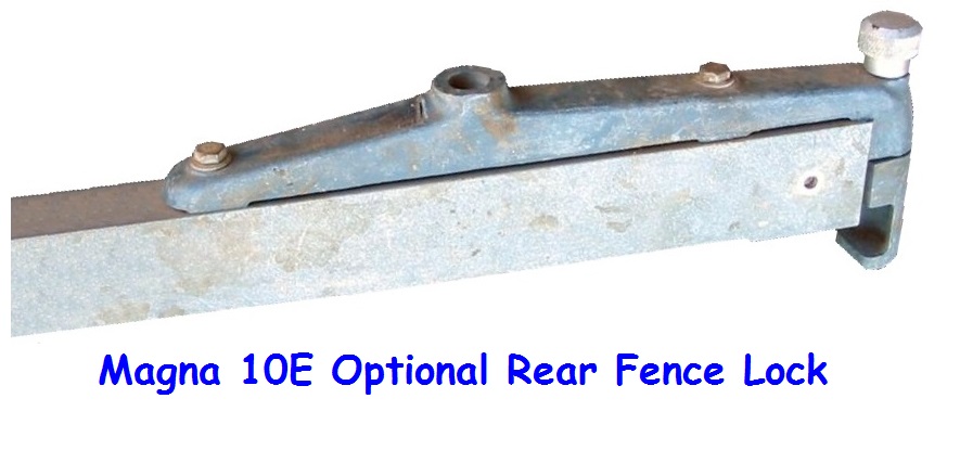

With John Burger's assistance, I found there is yet another variation of the original 10E fence that added a rear locking mechanism which I documented in the 10E Preliminary Manual Restoration Project.
If we do get Skip's blessing to modify the Data Set even further and add another notation for this type of Fence I will suggest we designate it as 1A for Additional Lock Mechanism. see attachments.
I would create a separate email account and some instructions on how to report the data if I were undertaking that project for folks to send in their data, just to keep it in a single place. Skip is welcome to use what I have added in my educational effort in any way he sees fit.
10E Magna Fence With Rear Lock.jpg (85.04 KiB) Viewed 5458 times
3 Fence Types with Locks.png (470.61 KiB) Viewed 5456 times
Rip Fence Lock Style for Angled Knob Only Plain Thread or Wedge Tipped.jpg (8.7 KiB) Viewed 5452 times

"1A" was an 'upgrade(added to "1")'. I do not think they made any "1A" from the factory.

JPG wrote:"1A" was an 'upgrade(added to "1")'. I do not think they made any "1A" from the factory.
That is true. What is your point? :confused:

OK, I guess I was confused because the picture above "1A" says "Optional Rear Fence Lock". :) :)

IIUC, it was not initially 'optional', but came later. Perhaps it was a way to achieve the same 'features' as the new 10ER rip fence with the original 10E rip fence.(rear clamp and mortising post mount).
I totally agree. I don't think we will ever know how 10E's were upgraded to 10ER's particularly after the sale. Was there a kit? Probably not from everything we know now. I also agree the 10E rear fence clamp was made after the 10ER was on the drawing board or maybe even in production.
It was a way for 10E owners to get the added stability of the 10ER fence without buying a complete fence.

My point was including it to help define what one has with theirs.
So little documentation of changes, accessories, kits, upgrades exist in print that we have preserved, so if there is any we need to preserve and share it.
It's rare like the lower saw guard and lower belt guard which I did not cite in the SN Data, but did in Appendix C of the Prelim 10E manual.
