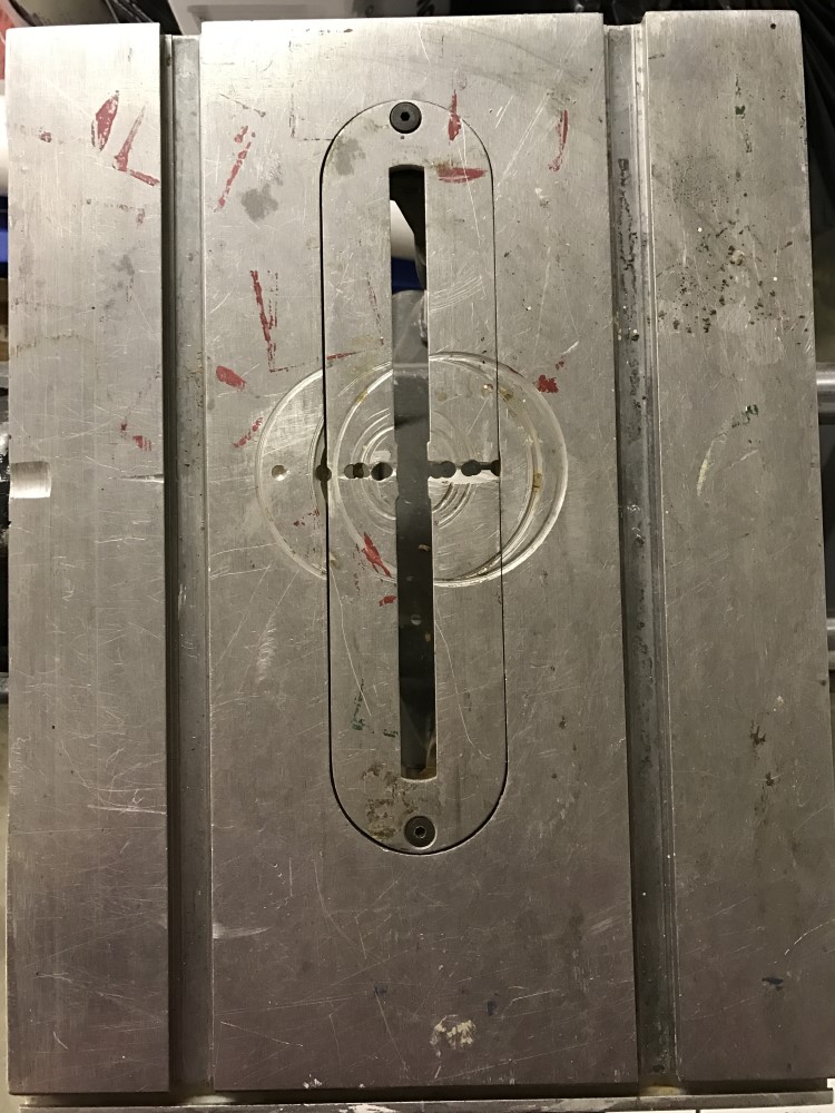

Cleaning the oxidation spots off the aluminum varies on how bad it is. Most are done using a fine wire wheel mounted on a universal arbor. I use my Mark V 520/7 for a lot of my restoration work. I use a buffing wheel to polish the parts to a shinny finish. Tables can be a challenge due to their size. Using a wire wheel on the 510/520/M7 tables would remove the paint in the grooves so a different method like very very fine sanding on the surface would be better.
I have had to replace one main table from an 82 Mark V because it was too damaged when I purchased it. I was able to get a reasonably priced replacement for it that was in good shape.
A good example of how not to use the Drill Press function. Always give the drill bit somewhere to go besides through the table or insert. Note the replacement table looks much better than the original.

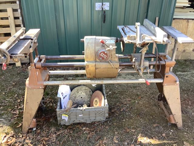

$150 Shopsmith Before I touched it!

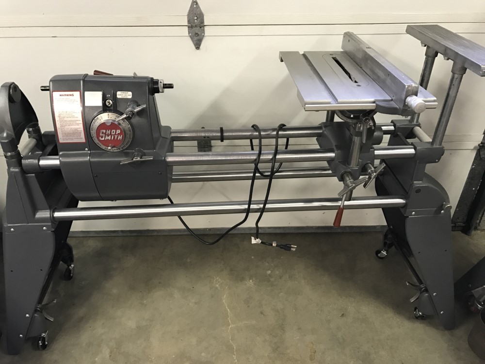

Very nice Russ. I was/am having phone issues. It wouldn't download pictures from email. The mountain has been climbed! Here she is as I bought it. I've already primed the belt cover. I'm about to tear down the quill to see if it's 1 or 2 bearings. Then order the proper kit from Jacob.
I had the headstock off and ran it through the speeds. On the higher speeds it had a reasonable vibration, I had to vice grips it down to hold it still. Normal?

Unless it has been upgraded the Quill will be a single bearing one. The Mark V Two Bearing Quill replaced the single bearing quill in headstocks with Serial number SS190000 and above in 1984. An easy way to tell on pre 1964 Mark 5's is they do not have the black protective coating on the quill parts or other parts for that matter.

JPG is correct that the black oxide coating is not an indicator of a two bearing quill. All Quills for the Mark 5/V's made before September 1984 are single bearing quills unless they have been modified by someone. There are some of those out there and could have the coating or not. If your Mark 5 has the black coated Quill it was changed. The Mark 5 color was gray by the time the black coating was first used in 1964 on many of the bare metal parts and accessories. JPG will correct me if I am wrong on that. He bought his Goldie new and is a great resource on the history of these tools.
You had asked about putting in new bearings and belts. For a Mark 5 from the 60's it's not a bad idea especially if the belts look worn or are brittle. If the Drive Sleeve and Quill Assembly do not turn freely than replace the bearings. The same goes for the Idler Bearings. I also like to replace old power cords as they get brittle too. I replace the switch on many of the restorations I do but mostly on the Model 10's. Better to spend a little extra money now to avoid a short in a bad power cord or switch. If it is questionable replace it. Remember your Shopsmith is coming up on 60 years old soon and replacing some of the internal Headstock parts will give it renewed life for many years to come.
