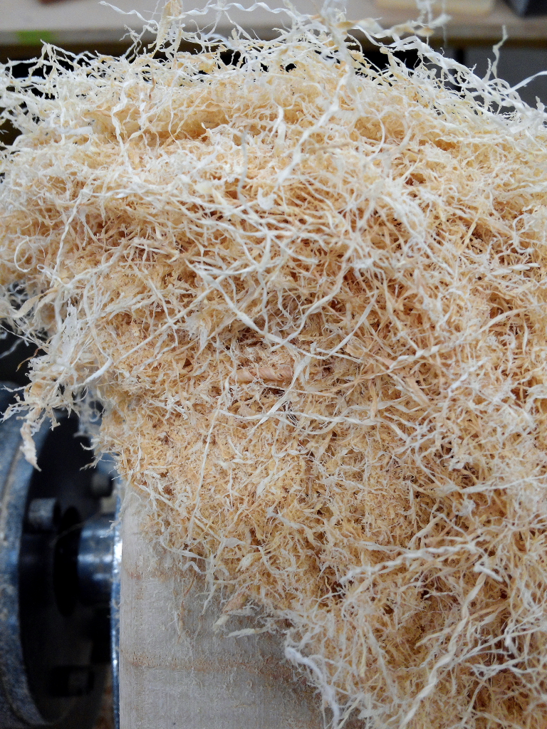

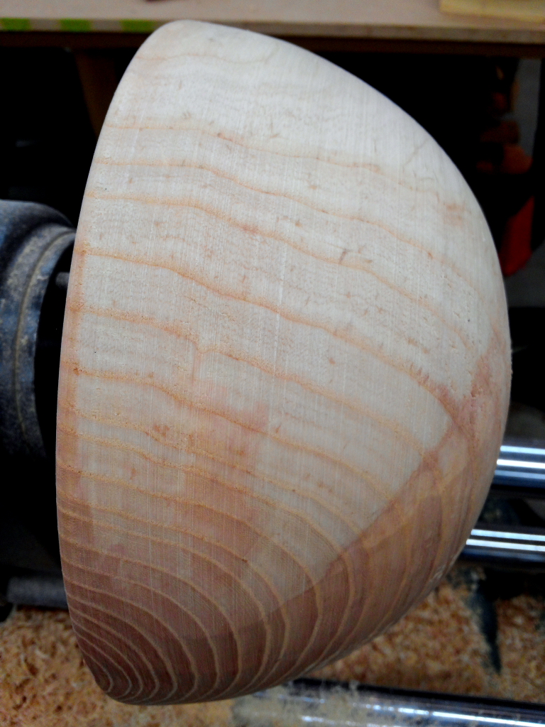

Well guys, I digested all of your advice, and watched a bunch of videos. Wow, there's an awful lot of art to turning, and I don't think I ever found two turners who agree on the best technique!
First, I installed a 600-grit belt on my sander, in hopes of getting a sharper edges on my basic Shopsmith lathe tools. It seemed to help a bit, but not a lot. Then I tried my hand at shearing with the bowl gouge. (And I wore a full face mask at all times.) Better again, but still not where I needed to be. Then I tried burnishing a burr on the freshly-sharpened round-nosed scraper, using a hard screwdriver shaft for a burnishing tool. The results were better again, but the burr had to be re-formed every minute or so. Then I tried flattening the face of the scraper, like you would a plane blade, except I only did a quick-and-dirty flattening near the cutting edge. Big improvement this time! I was able to clean up the outside of the bowl nicely, making nice wispy shavings in the process. In the pic below, I've cleaned up near the rim, and the tearout is virtually gone. (The bowl bottom still needs to be shaped and mortised for the chuck.)
Bowl 3.JPG (688.41 KiB) Viewed 12430 times
I got the basic idea from this Veritas Scraper Burnisher product info. The illustration below shows the burr geometry.
Later, when working on the inside of the bowl, I re-flattened the scraper face, and did a decent job of it this time. HUGE difference. Afterward, I was able to turn up a nice big smooth burr that looked like the one in the Veritas illustration. Not only could I feel it, I could see it clearly with my naked eye. It cut like a dream, even faster than a bowl gouge, and I don't thing I had to resharpen once when finishing the inside of the bowl.
So Mike, with the help of Veritas and all you guys, I think I turned the SS round-nosed scraper into a poor man's shear scraper. Finishing up the inside of the bowl, I was wishing I had a one with a bigger nose radius, for better smoothing. Then I watched your Al Stirt video, and it looks like I was on the right track!
