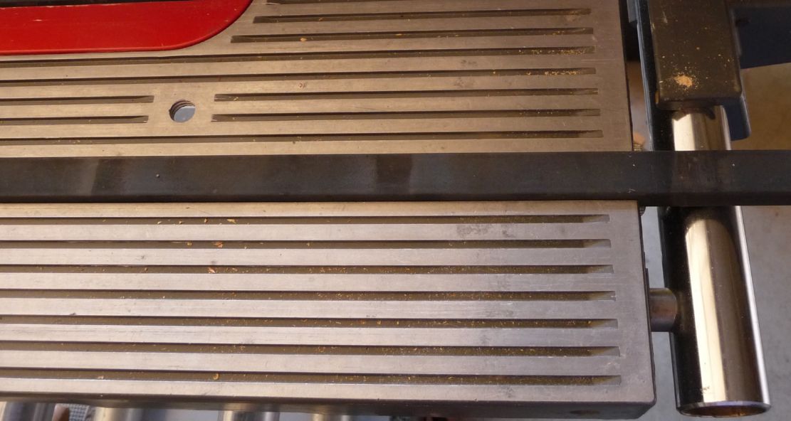

Two years ago I decided to make a sled. I tend to save things for some unknown later use and saved the aluminum ribs that support one of those big umbrellas that people have on their patios. Neighbor tossed it so I scavenged it for what might be useful. Turned out that the width was .016 smaller than the track. To attach the sled I shimmed the inside of each slot pressing the bars to the outside and with double backed tape I set the sled on top. It's elevated above the table about 1/8". Probably would have worked fine without this extra care.
- m1.JPG (109.27 KiB) Viewed 3290 times
