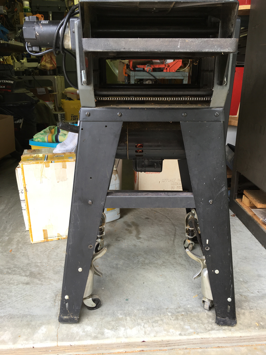

I ran into another problem. I received the SS Professional Planner Manual # 555082 with the planer with no instructions for the caster set. The problem is that obviously the caster set is installed incorrectly and I don't have a clue how they should be installed. I know I can remove them and thru trial and error get them so they can be operated without getting down on you knees and operating them by hand but that is not a solution. I can't lift hardly anything and don't care to do that. Can someone attach a copy of installation diagrams and maybe a picture or two to an email please? I really would appreciate it!!

Actually the castor set is installed correctly. You have to put your tow inside between the legs and under the cross bar to rotate the lever.
Your levers are on the out feed side of the planer. I have mine installed on the in feed side. Just take them off, swap them from side to side and rotate them 180*. That way the levers will be at the normal operating position. However, they will work fine as is.

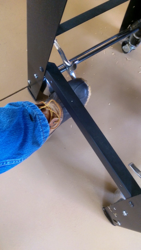

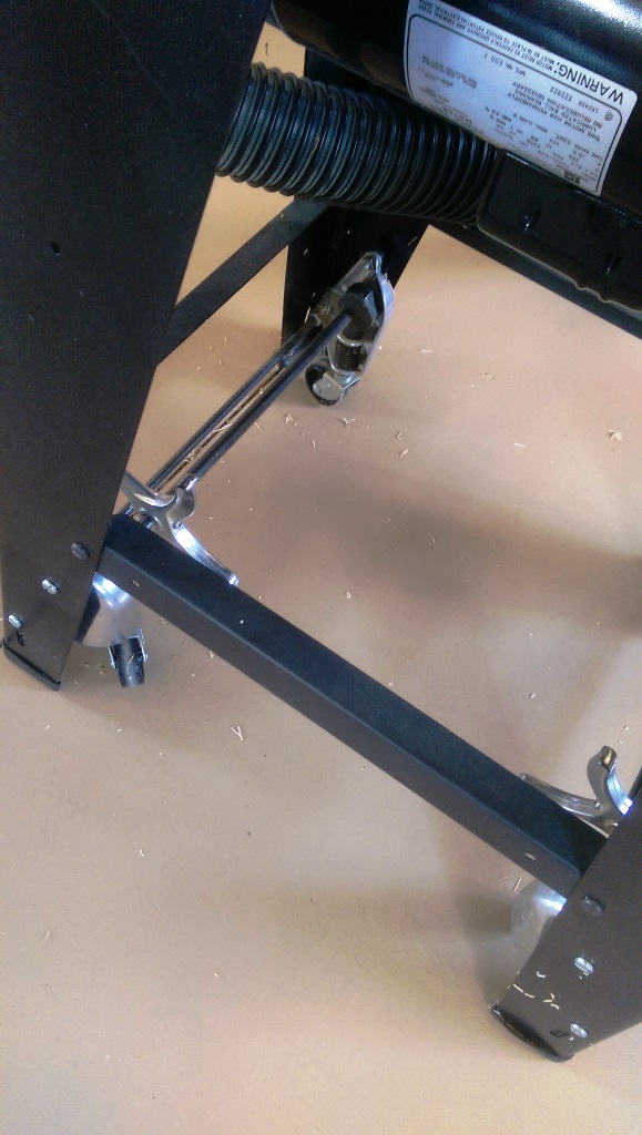

John, thanks for the pictures. I made a minor modification to keep from bumping my shins that you may be interested in. Made a temporary, then moved the original up.
Don G

Posts: 6584
Re: SS Planer
dgreen810 wrote:jsburger
Don G
Good idea. I have not moved mine since I built the dedicated shop 6 years ago so it is not a problem for me.
