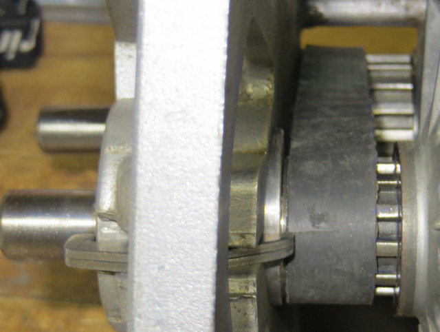

Member mmorris posted this photo in http://www.shopsmith.com/ss_forum/viewt ... 98#p156998
On this style the retaining clip had the tensioning bolt pass through the clip and this locked the bearing assembly in place.
Everett
bearing retainer for old Greenie eccentric.JPG (62.98 KiB) Viewed 3504 times

Everett thanks for the pic and post to the topic. I plan on getting 2 of the clips the hold it all in place instead of drilling and tapping.

They haven't been made in decades. eBay or a donor machine maybe. If someone else has any it might be Bill Mayo
Getting a B series headstock casting may serve you better. They are on eBay too.

I planned on contacting Bill Mayo for them due to reading about all the parts he has stock piled and him trying to reduce the pile. Great find JPG! That was my second choice, looking on eBay.

Also, check out Bill Mayo's Headstock improvement kit 2nd edition dated June 16 2016 the two write-ups are identical, up to the last page(s) which has his latest additions he sent me in an email.
Both are available for download at
https://www.shopsmith.com/ss_forum/view ... 90#p185690
You want to be sure you understand how to tension the two ears without breaking one off, which happens...
Everett
