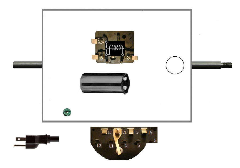

Your picture shows a GE with an external motor start relay.
See if this helps....
Draw Your Own GE Mark VII motor with External Relay.png (222.32 KiB) Viewed 5180 times
https://drive.google.com/drive/folders/ ... WRUSUttbk0
Has the others that I did when I restored the MARK VII Owner's Manual which you will find there too.
There are drawings for the other 3 motor types there, but neither JPG or I had one of the GE with External Relay motors to match up wires from.
If yours is that one, I will be happy to make another motor type drawing, just draw what you have on the attached draw your own illustration.
helpful to do that when you take apart what you had regardless if it is right or wrong, we can usually spot what's wrong.
I think you will find the other AO Smith motor with external start relay a bit of help to envision what you have.
Everett

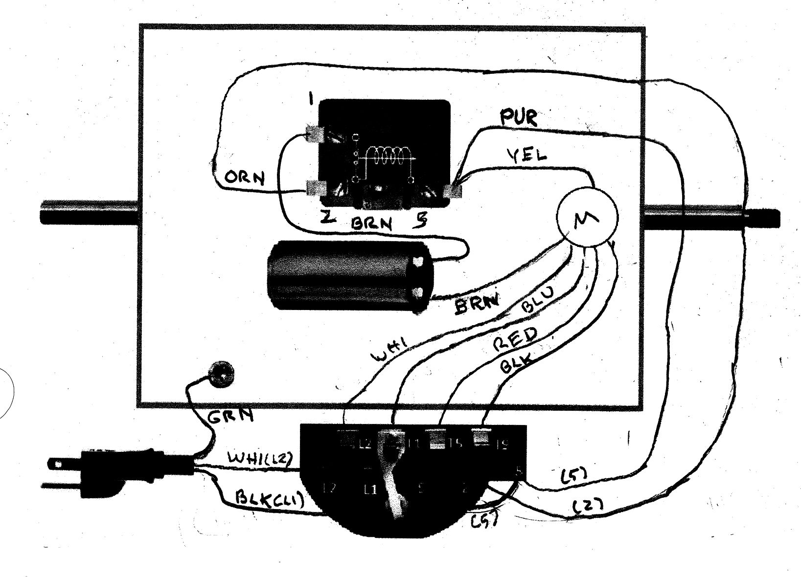

Re: Is my Mark VII motor/switch wiring correct?
For starters, add relay terminal numbers to Everett's blank.
1 label the upper left terminal(1) - I believe you currently have a BRowN wire from the capacitor connected there on your relay.
2 label the lower left terminal(2) - I believe you currently have an ORaNge wire connected there.
3 label the lower right terminal(5) - I believe you have the YELlow and purple wire there. I prefer to call it VIOlet.
If the wires are not connected as I described above, stop and tell me so.
You should have the motor connected to the switch as follows(I assume that portion of the switch is still working).
L1 BLUe
L2 WHIte
The Line Cord is connected to L1 and L2 And a grounding screw.(FWIW your linecord WHI/BLK wires are 'reversed' - it will work either way).
That leaves the RED,BLacK motor wires and the ORaNge and VIOlet wires from the relay 'dangling'.
Again if yours are not connected EXACTLY as I just described, stop and let me know.
Now for the 'moment of truth' !
Temporarily connect the ORN wire to the RED motor wire
Temporarily connect the VIO wire to the BLK motor wire
There should NOT be any unconnected wires.
plug in the line cord and push the switch on(be prepared to immediately pull the plug).
It should run.
Unplug it and swap the RED/BLK wires RED to VIO and BLK to ORN
Plug it in and turn on as before
It should run reversed.

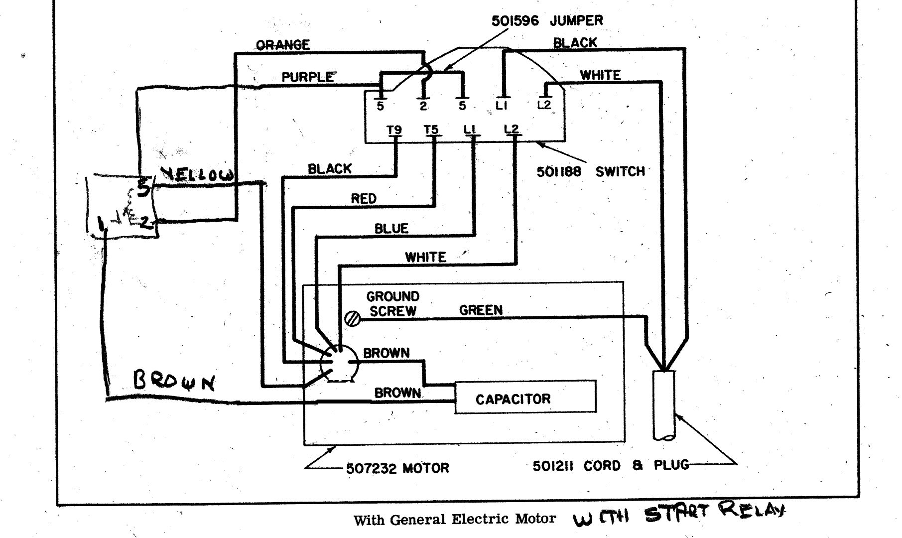

n240sxle91 wrote:Success!! It worked both forward and reverse!
I'll try both switches and report back.
Thanks so much!
Slow down grasshopper!!
Wire the RED/BLK/ORN and VIO wires to the switch as follows.
But before doing that let's determine if the reversing part of the switch works properly.
The switch has three positions forward, off, and reverse.
I assume you know which button to push for each position.
So get out yer ohmmeter and check the following:
Switch forward. T5 to 5(middle one) T9 to 2 <<<< s/b reverse
Switch reverse. T5 to 2 T9 to 5(outer one) <<<< s/b forward
IFF ok connect motor wires as follows:
RED to T5
BLK to T9
other wires:
ORN TO 2
VIO TO both 5(JUMPER THE TWO '5')
That should be it.
