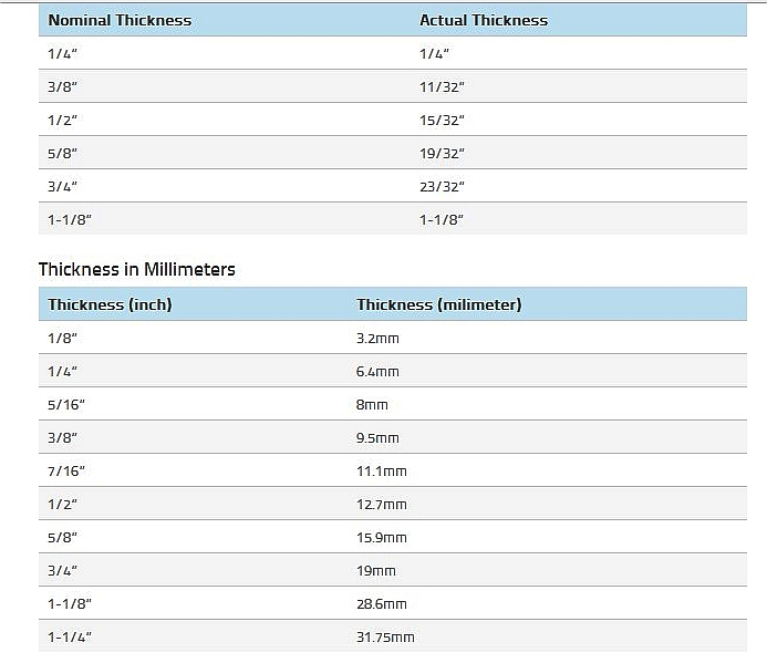

I measured a bunch of pieces I have from over the years. Both Baltic Birch and Fir. Most of it was 1/32" under with a few 3/64" under. One piece of "3/4" Baltic Birch was a 1/16" under (surprising).
Interesting that Whiteside sells a set of router bits for plywood. They are all (1/4, 1/2 and 3/4) 1/32 under. It makes one wonder why if plywood is all over the place. 1/32 must be the standard but a lot of manufactures apparently don't adhere to that.
I suppose it depends on the quality control of the manufacture. As Ed said, take a caliper when you buy plywood.

Re: 73 piece and counting shelf unit
- plywood sizes.jpg (111.64 KiB) Viewed 5682 times
