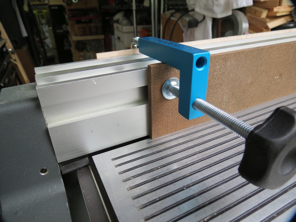

Happened to be using mine today so I shot a picture of how I deal with the clamp on my 520 fence.

I would say it is one of a set:
Rockler Fence Clamps.png (66.77 KiB) Viewed 2501 times
Item #: 31373
Rigid aluminum body with steel threaded components.
Range of travel 1/2''-5-3/4''.
1/2'' minimum assumes a 3/4'' auxiliary fence; you can clamp to an even thinner primary fence if you use a thicker auxiliary fence.
Drill a 3/8'' hole in the auxiliary fence.
(2) Universal Fence Clamps

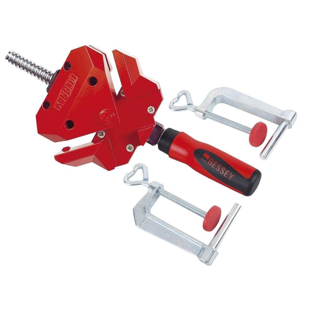

If your looking to buy these you might want to consider getting a Bessy corner clamp. It come wit two clamps that should work on the older fence. Unfortunately they do not open wide enough for a 520 fence.
Bessy Corner Clamp
Bessy Corner Clamp
