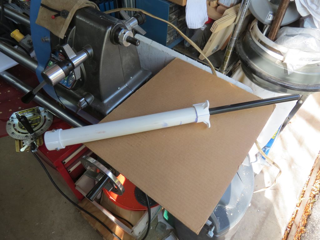

The package arrived early so I went ahead and put it together. I did make just a couple of changes. If you decide you want to make one yourself take note other wise there is not much general content.

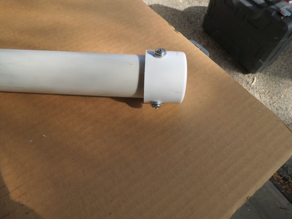

First the more I though about it the less I like the idea of gluing the two ends on and "sealing" it up. So I went ahead and made the bottom removable. I did this with three screws. They were a bit longer then I wanted so I added some washers.
If you go this way it might be a good idea to mark a location so you can get it back together with the correct hole alignment or do some other magic to insure the holes are going to line up in any of the three possible locations.

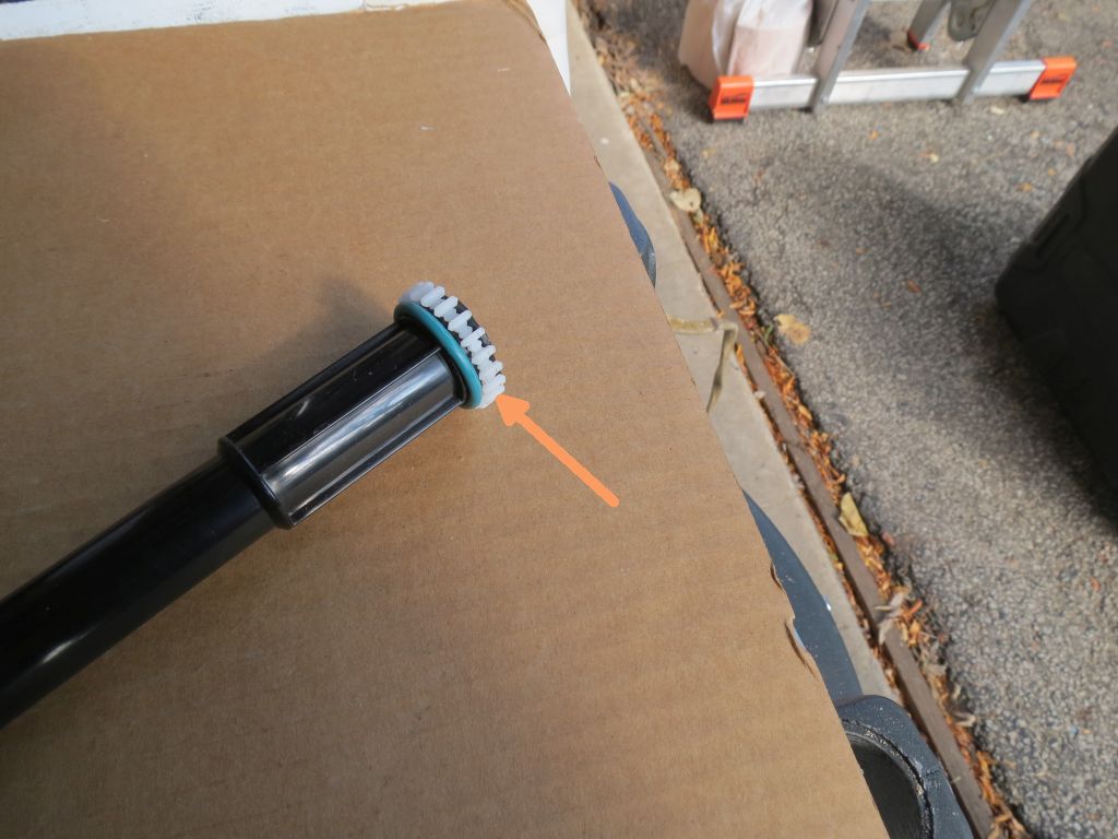

The next issue I found was with the washer thing on the bottom. In just playing with it it come out of position several times. There is nothing holding it in location so why wouldn't move around?? I went with a 0-ring. If that doesn't work I can take it back apart and glue it or something. Anyway here is a picture of the part and the blue o-ring.

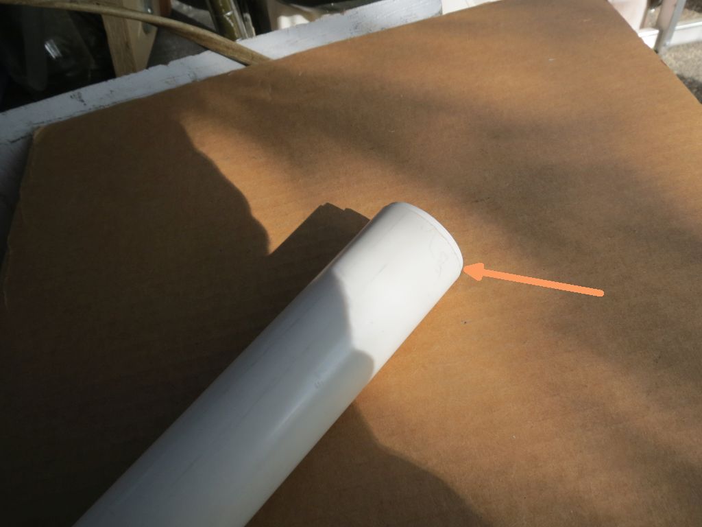

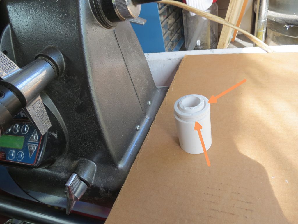

Next I found the top alignment washer thing was not going to fit down in the tube. I tried several times and it just didn't want to go. Here is a picture of it sitting on a cut off end of the PVC pipe.
I really think it needs to fit inside the PVC. I ended up using a 1-7/16 bit and drilling down about 3/16" into the pipe end. That did it. It now fits in and stays.
Final product:
