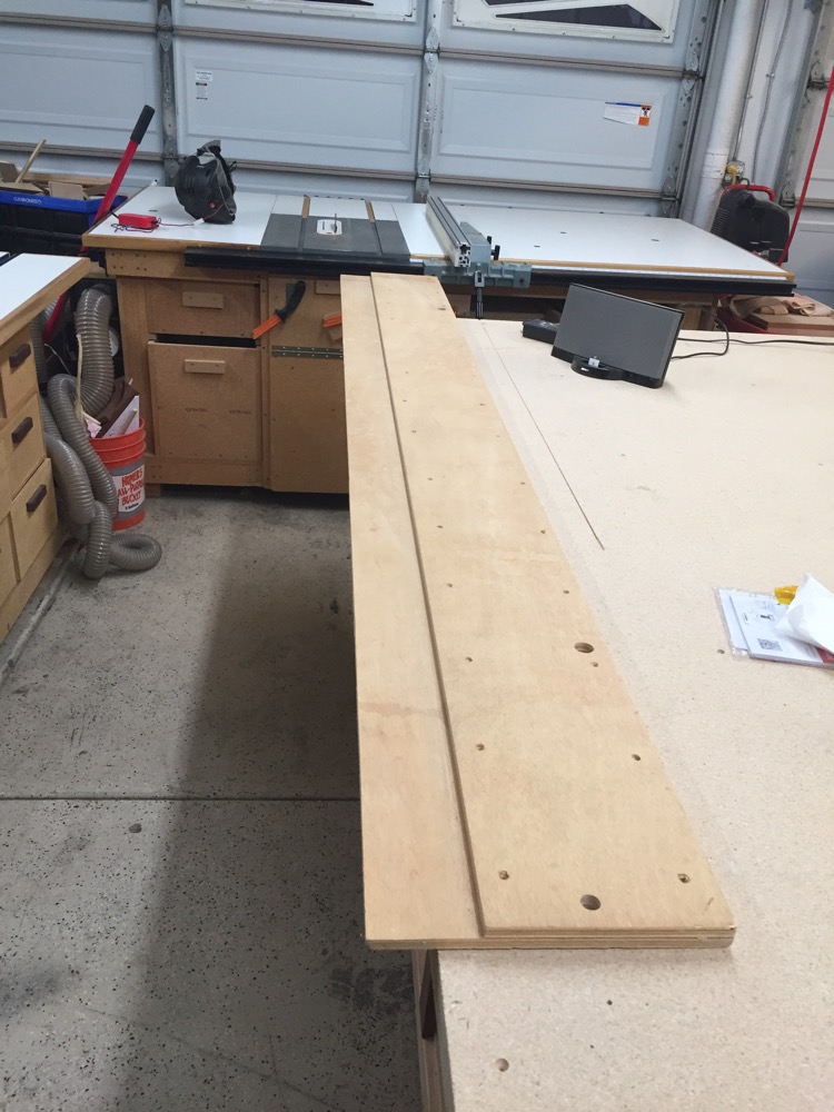

I know that it seems easier to go buy a track saw but for the price of a sheet of 1/2" ply and about 15 minutes you can build one and use the left over money to buy some nice wood for your next project. They work just as well ie they give you a straight and accurate cut for a fraction of the cost.
Paul
Paul
- IMG_3663.JPG (178.48 KiB) Viewed 3872 times

This is my favorite, I've got one in 8', 4', 2'. I also built one 1' for cutting 2x straight. Simple, cheap, and easily replaced. I will typically break down sheet goods on the garage floor with wood set on foam insulation.masonsailor2 wrote:I know that it seems easier to go buy a track saw but for the price of a sheet of 1/2" ply and about 15 minutes you can build one and use the left over money to buy some nice wood for your next project. They work just as well ie they give you a straight and accurate cut for a fraction of the cost.
