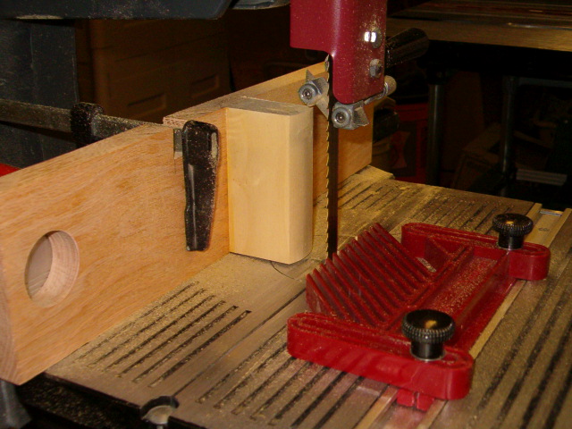

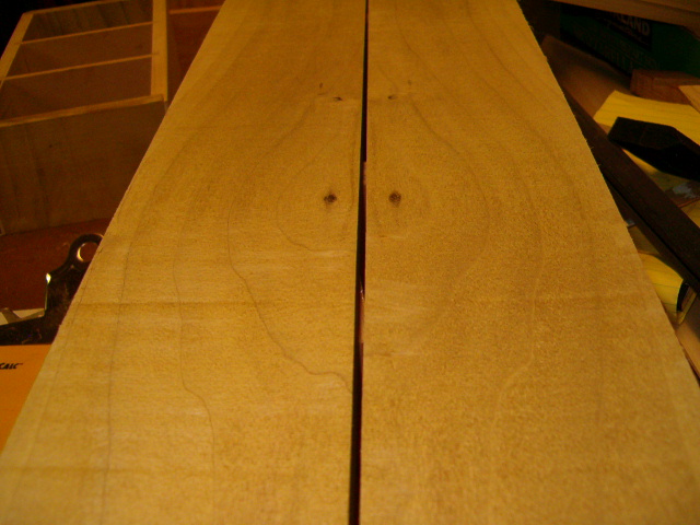

I did a little re-sawing myself today. A calculated 18 bd ft required to make these shutter blanks. Please excuse the unsophisticated look to the simple rigging to do the re-sawing, but it worked. I use cool blocks and a 5/8" Shopsmith blade. Here's photos:
- re-saw jig.jpg (125.67 KiB) Viewed 3510 times
- Mirror image of re-sawed board.jpg (122.83 KiB) Viewed 3507 times
- shutter blanks, needing planed on the sawed side.jpg (110.63 KiB) Viewed 3499 times
