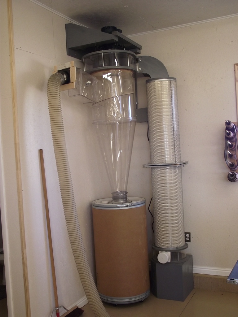

I will tell you it is a myth in my opinion. I have a ClearVue cyclone. 5 HP Leeson 220V motor and an 18" impeller. The design is from Bill Pentz. It is the largest one ClearVue makes at almost 2000CFM with an 8" input. It is made out of PLASTIC (actually Lexan I think). It has been used for over 6 years with no problem.
I have never had a shock from it. Yes I have had shocks before but I can't tell you from what DC. There have been only one or two.
The picture is when I first installed the ClearVue.
BTW, see the clean out below the filter of the ClearVue? I have never cleaned it and after 5+ years there is less than 1/8" of dust in the bottom. Very efficient in my opinion.
So yes it is a myth that you can ground plastic or even attempt to or need to.
