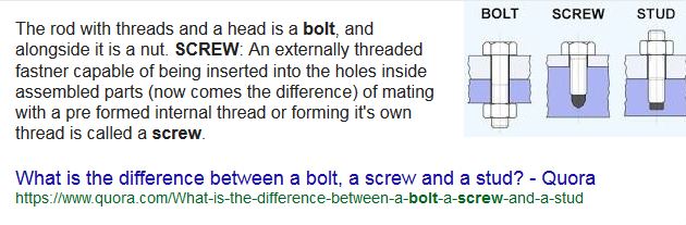

Side note:
Capture Bolt or Screw.JPG (45.31 KiB) Viewed 7017 times

An excellent example of common lack of concise use of terminology regarding the distinction between a 'screw' and a 'bolt' when referring to threaded fasteners.
The essential distinguishing attribute is whether the 'headed' end has a precision surface that bears against the object being secured and whether there is a surface(s) for a tool to apply torque for fastening/tightening.(slot/socket/hex...)
Thus there are carriage bolts. No surface for a tool.
There are structural bolts. Non precision bearing surface.
Pretty much everything else is a screw.
A screw can be a machine screw or a wood screw.
Damn Mickyd! He exposed me to the truth re screws/bolts.
And yes the world is full of examples of manufacturers mis-identifying them(especially from 'over there').

JPG wrote:An excellent example of common lack of concise use of terminology regarding the distinction between a 'screw' and a 'bolt' when referring to threaded fasteners.
I just recently ordered and received two sets of trunnion bolts from Shopsmith. See online catalog re: Shopsmith Part Number 426370
