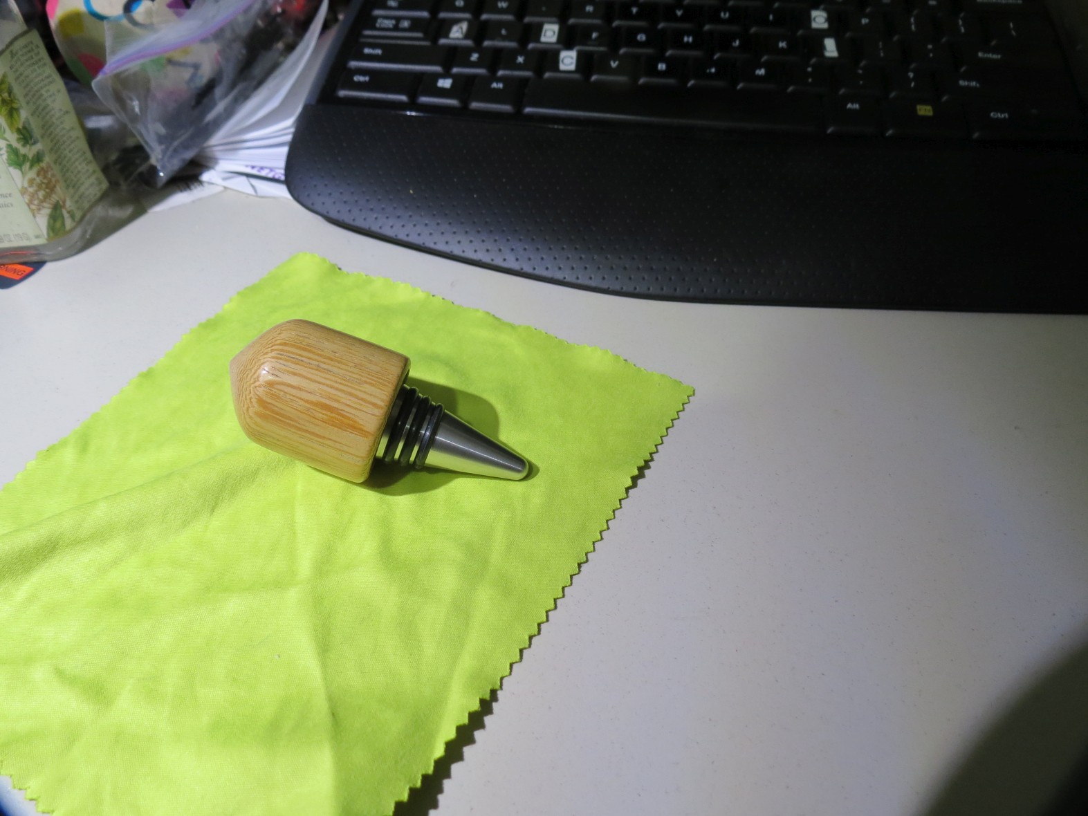

Re: Today in the shop (turning a bottle stopper)
Among a few other projects I turned another stopper today. Last of that crazy wood. Again another simple design.
