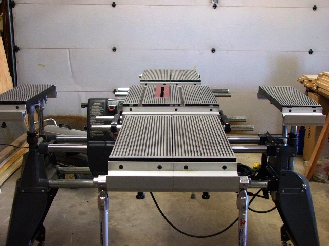

everettdavis wrote:You also can employ Extension Table Brackets 555997 and use your extension tables on the front or back... and with some extra tables, both at the same time. http://www.shopsmith.com/ownersite/cata ... racket.htm
I have two sets of them. they work very well.
Thanks for sharing your photos and experience jsburger -- I've been on the fence about buying the extension table brackets for a little while (just seems the simplest method to achieve infeed/outfeed functionality, and uses existing SS tables) - your endorsement helped make the decision, ordering them today !

I'd really like to see a picture of the 510 table setup for the extension. If someone who owns one could snap a picture it on showing the attachment that would be great.

reible wrote:I'd really like to see a picture of the 510 table setup for the extension. If someone who owns one could snap a picture it on showing the attachment that would be great.
Here's the photo of a 510 with them on the back side I posted previously.
see: http://www.shopsmith.com/ownersite/cata ... racket.htm
I would like to know if there is a way to add a rip fence to the extension table.
Everett
Extension Table Brackets - 555997 on back side of 510 table.jpg (147.86 KiB) Viewed 29144 times
