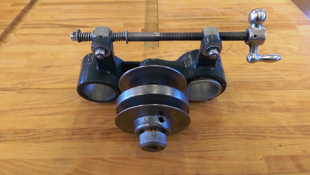

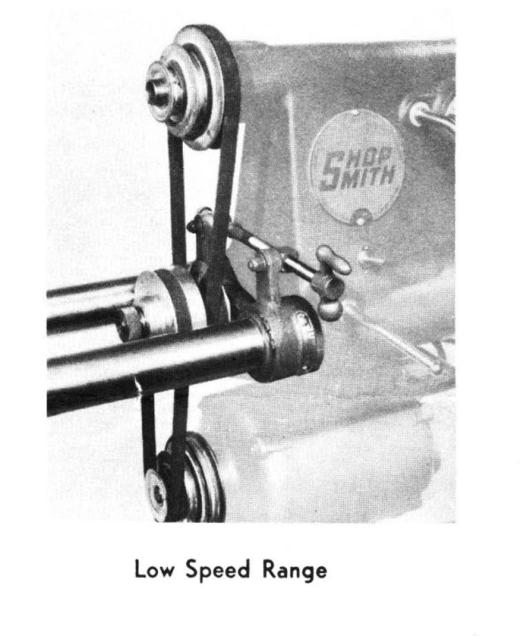

The speed changer was an optional accessory. It provided infinitely variable speed adjustment in two ranges. Low range is 425-1600 RPM's and high range is 1850-6899 RPM's. They are very desirable and somewhat scarce. The average price on eBay is around $150.

I cant find it John, but I thought in LS range, the high speed was in the 1400 rpm range. I have it some where but cant find it tonight.jsburger wrote:The speed changer was an optional accessory. It provided infinitely variable speed adjustment in two ranges. Low range is 425-1600 RPM's and high range is 1850-6899 RPM's. They are very desirable and somewhat scarce. The average price on eBay is around $150.

OOPS! How in the world did that happen?JPG wrote:6800, not 6899
- Posts: 35599
Re: Price check for 10 ER?
Easy enough to deduce what happened. It is only one key off.jsburger wrote:OOPS! How in the world did that happen?JPG wrote:6800, not 6899Sorry for the miss information.
