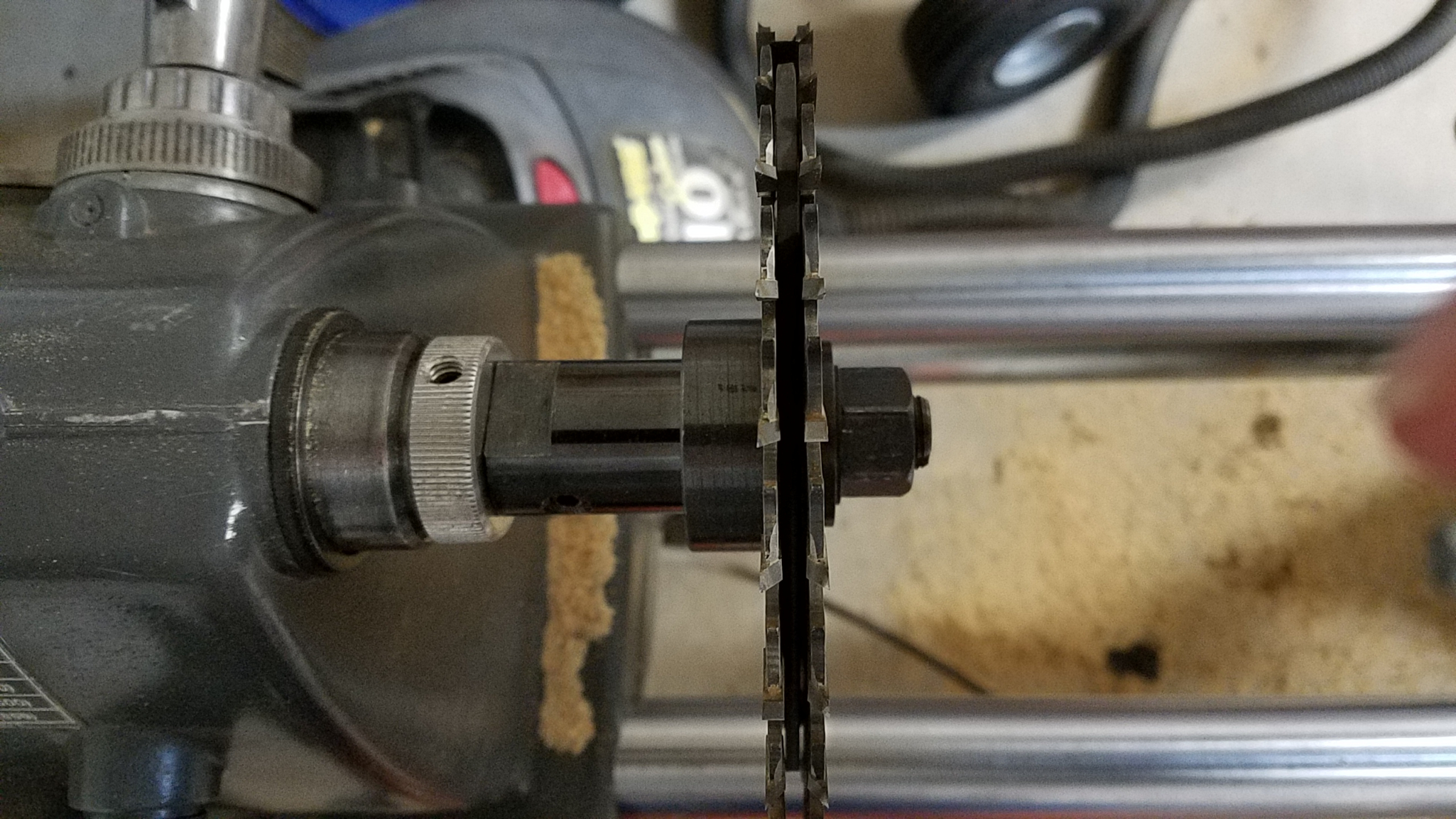

You say you only have a couple blades. I assume then that you have the two outer blades and no chippers.
With that combination, you should be mounting the blades and nearly all (if not all) of the spacers. If you are doing this as I think you should, when you finally put on the locking washer and the nut there should be a very small amount of the threaded arbor shaft showing.
To get the dado blade centered in the table cutout, you may need to move the carriage away from the headstock a small amount so that the arbor clears the Table Bar and Tube.
That said, I think you've got it.
I went to the shop and quickly mounted the dado arbor (it is NOT secured to the quill shaft). I have one chipper installed and as a result have one spacer that is not mounted. Note the arbor nut and remaining exposed threads. To center the blade I had to relocate the carriage about a half inch or more.
The saw dust on the Bench Tubes makes clear just how much the carriage is moved.
- 001.jpg (1.75 MiB) Viewed 16228 times

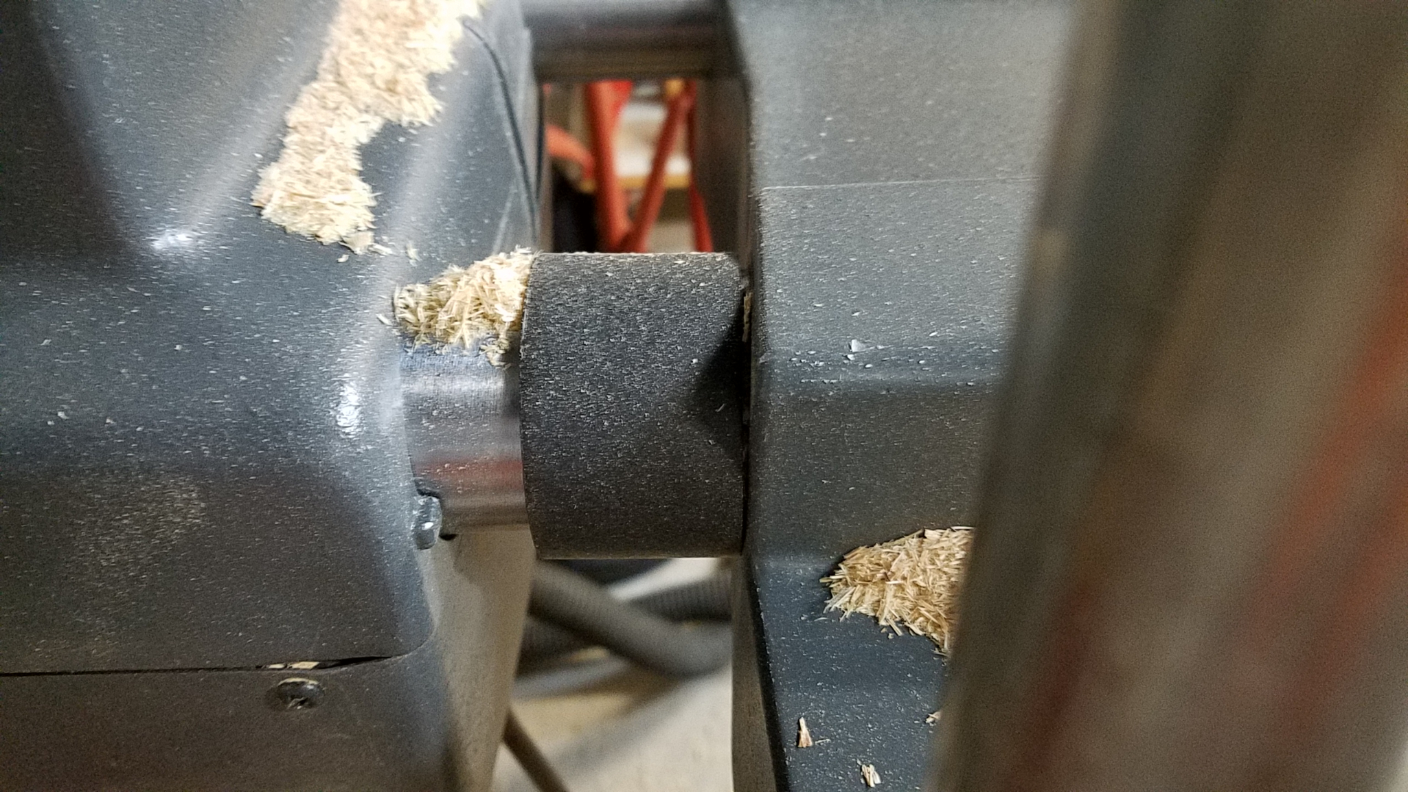

- Posts: 35457
Re: Dado arbor for regular blade
That 'rotated' pix merely looks like 'from the back' to me.

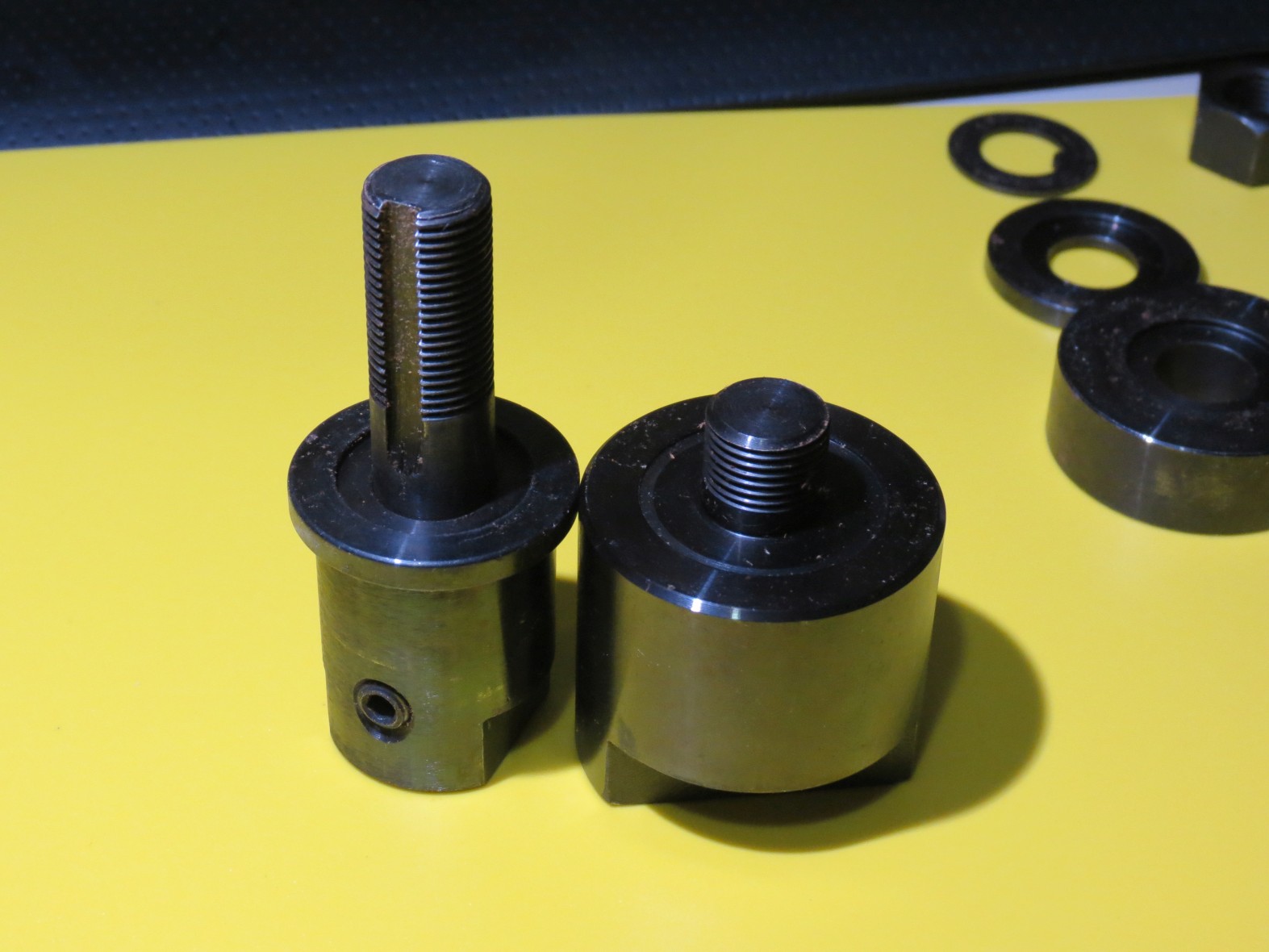

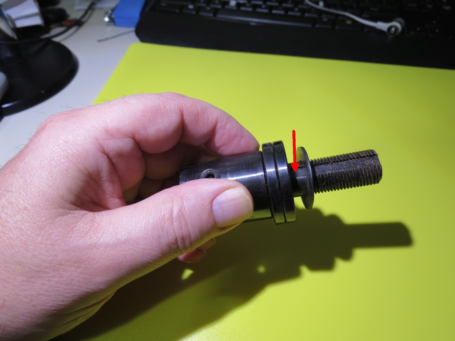

Here is a picture of a dado arbor and a saw arbor both are for the newer 505-520 hardware. To get a blade placement that aligns with the safety equipment on one of these systems you have a very limited range of fitting things together. By putting one of the thin washers on the dado arbor you end up with a match to the distance out of the blade arbor.
This means that at least this part of the system appears to work. Now where the shaft extends is another matter. It could just hit the shield or it could hit the tie bar. I'd do that but I have a set-up on the lathe that I don't want to take apart to test it.
Another thing that I noticed is the the key way ramps up so the washer will only go so far. If you were to want to mount something with the second thin washer it would have to be at least 5/16" thick. Of course the thick washer mounted on that side will work. So the stack up would be thin washer, blade, thick washer, optional thin washer and locking washer with the nut on the end.
So at this point I can not say that the dado arbor will work for regular blades or not, it might depend on if you use the upper guard or not....
If anyone has their machine free I'd like to know if the end of the dado arbor hits anything when installed with a regular blade. Other wise I'd do the test myself when I take down the lathe project in a couple of days.
