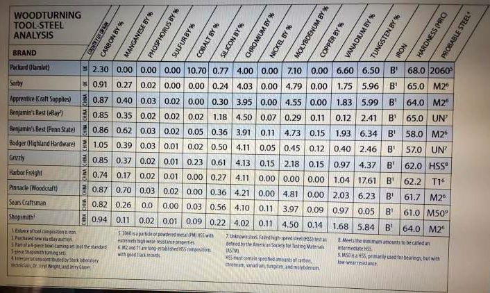

In the same test that I referred to in my earlier post there were two versions of the Benjamin's best tools that were tested. One set was purchased through E-Bay and those did not make the grade as HSS but those from PSI did check out as HSS. I will try to find the copy and post it here.

This is the chart I was referring to. I hope it helps someone.
lathe tool steel types.jpg (104.59 KiB) Viewed 9299 times
Bill V
