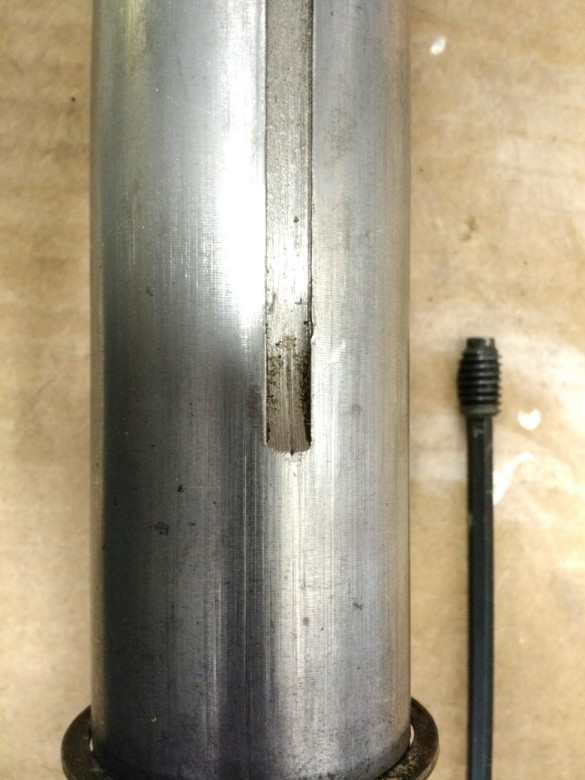

Thanks for all your help. I used Jacob Anderson's YouTube video as a guide. Visual inspection didn't reveal any problems to me. My guess is the set screw either worked loose or I loosened it by mistake when I took the headstock apart to install new belts (I know better now). I filled the set screw Allen hole with putty to remind me to leave it alone. I also invested in a dead man switch in case something else unexpected happens.

I would still recommend locking the quill depth stop to the 4" maximum. Others disagree but it will give a positive stop at maximum extension if the screw works loose again. The screw is the correct one.

There is nothing wrong with doing that. However, if the return spring is properly engaged the quill should not just fall out with the set screw loose. It seems like in this case the spring is not engaged. The OP has not mentioned the spring.wa2crk wrote:I would still recommend locking the quill depth stop to the 4" maximum. Others disagree but it will give a positive stop at maximum extension if the screw works loose again. The screw is the correct one.

Sorry I left that detail out, the return spring was still engaged. Seems to be working fine now. Thanks again for your help.

Ok youse guys you're getting the old man confused!!! If the set screw is loose AND the depth stop is set to free wheel the quill can be extended past the 4" travel that is designed into the system. At this point the pinion shaft and the teeth on the quill housing will disengage and the quill may very well fall out of the headstock if the drilling job is in vertical position. This is basically what is done to remove the quill for servicing and the return spring is still under tension. Wrong? Right?

Of course you are right.wa2crk wrote:Ok youse guys you're getting the old man confused!!! If the set screw is loose AND the depth stop is set to free wheel the quill can be extended past the 4" travel that is designed into the system. At this point the pinion shaft and the teeth on the quill housing will disengage and the quill may very well fall out of the headstock if the drilling job is in vertical position. This is basically what is done to remove the quill for servicing and the return spring is still under tension. Wrong? Right?

However, here is a quote from the original post.
"I was using it in the drill press position yesterday and the quill came crashing down onto the piece I was drilling."
That doesn't make me think that he extended too far. He never said how far it was extended. Nothing about the feed handle flying back or anything else. just that it simply fell out.
Assumptions and lack of information probably lead to the statements made.
