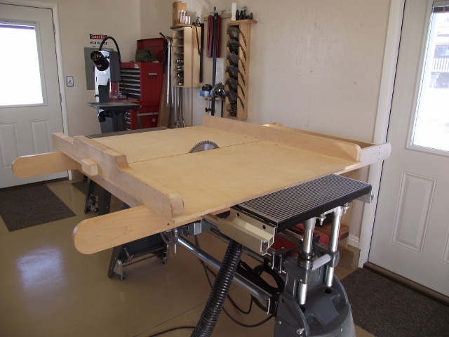

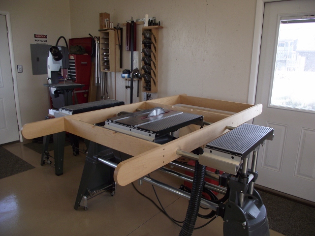

This leads me to my next question - how do you all set up your table saw to be useful? This is a tiny tiny table. I was going to build a standard sled and a miter sled for most cuts. But the tiny size of this thing makes me wonder if the sleds will be too big.
I was only trying to cut a piece about 28x14 to 18x12.

With the ability to attach an auxiliary table on the end(s) a very wide sled is possible. Add front miter gauge extensions and a pretty deep sled is possible.

This is the second time in what a week or so that someone has mentioned it. Large sleds are possible with the 510/520. Most will think it is over kill and that is fine but I use it all the time.

I love this setup. How do I begin to even design something like this? Or is there a plan? (I'm kind of a newbie to the shop, if that wasn't already painfully obvious.)
