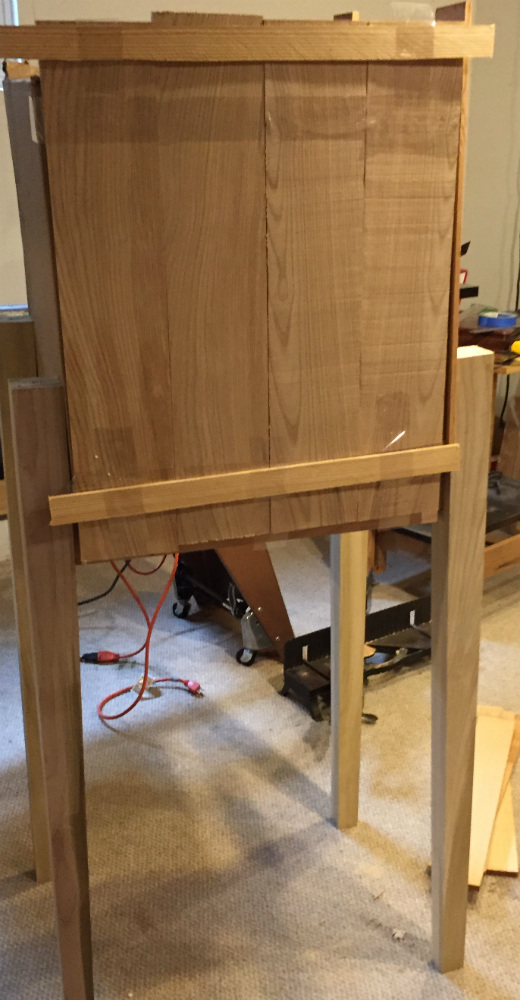

Time marches on, and a new project is in planning, sort of a liquor cabinet. For maximum satisfaction, I want to stretch my existing lumber supply.
A set of legs is in mockup, with a 20x20x20 cardboard box acting like a cabinet:
How Much Liquor Cabinet.jpg (161.03 KiB) Viewed 33496 times

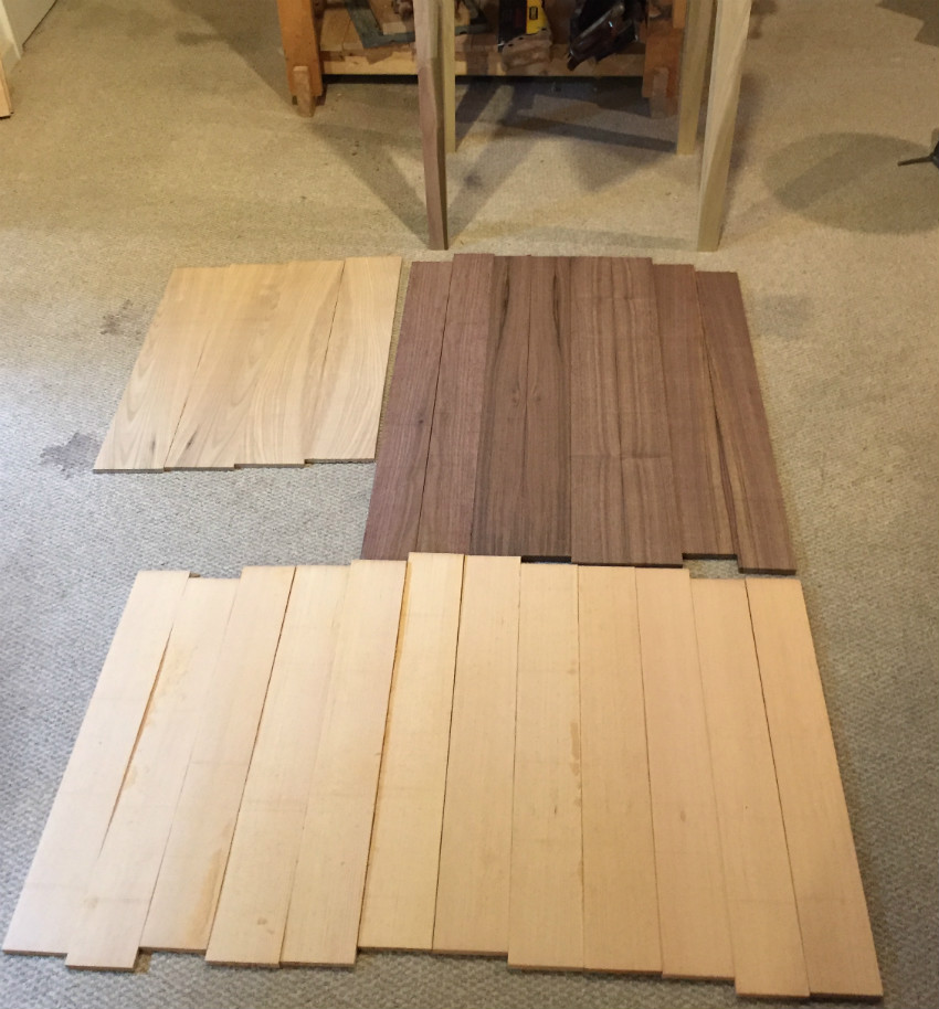

I think I'll be cladding this cabinet with a mix of woods. I like them quartersawn or rift sawn, and I like my wood to go a long way. I believe this was 14 cuts on the Shopsmith bandsaw this morning :) It's a trooper!
Resawn Cladding.jpg (170.58 KiB) Viewed 33496 times
Happy Woodworking,
Chris

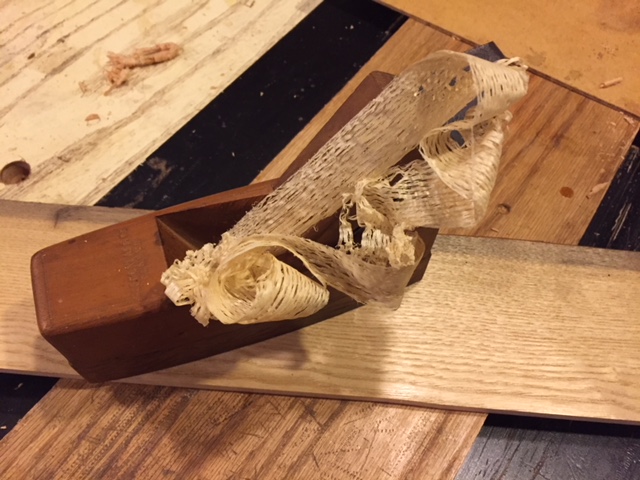

Posts: 3812
Re: And Another Successful Bookmatch from the SS Bandsaw
Looking good, Chris. I resawed some oak myself just the other day with my SS bandsaw -- it's a trooper. My workpieces were too short to power plane, so I thicknessed them with my little Jet drum sander. That worked well, but it's a relatively slow process, and changing grits is a pain. How do you clean up your resawn boards?

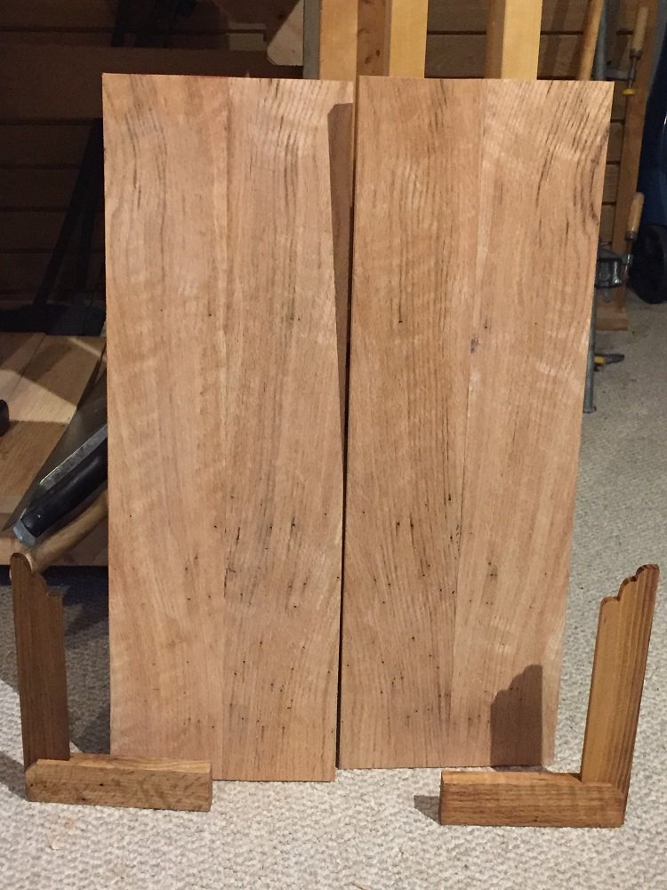

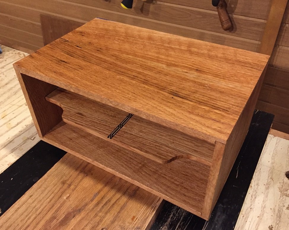

Just some more playing on a small desktop valet. The basic bookmatched red oak composing the top and sides, was courtesy the SS bandsaw:
Matched Oak.jpg (129.81 KiB) Viewed 16385 times
Resized Tongue.jpg (147.56 KiB) Viewed 16385 times
Happy Woodworking!
Chris
