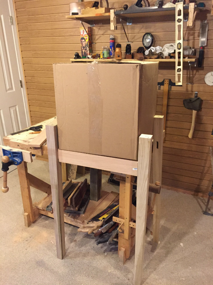

Time marches on, and a new project is in planning, sort of a liquor cabinet. For maximum satisfaction, I want to stretch my existing lumber supply.
A set of legs is in mockup, with a 20x20x20 cardboard box acting like a cabinet:
How Much Liquor Cabinet.jpg (161.03 KiB) Viewed 33511 times

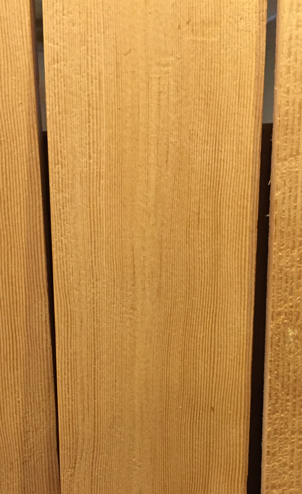

For the sides or back, that resawn Pine (or other SPF species) is kinda nice reclaimed wood. The densest parts are beyond 30 rings per inch:
SPF at more than 30RPI.jpg (188.23 KiB) Viewed 33426 times
