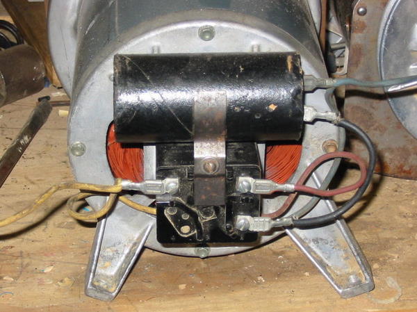

Look for the start relay on the back end of the motor.

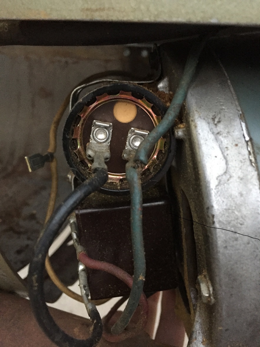

Here are some photos. I dropped the motor and one of the white wires to the engine broke off. I tried holding the wire (with plastic handled pliers)to where it is supposed to attached and nothing happened.

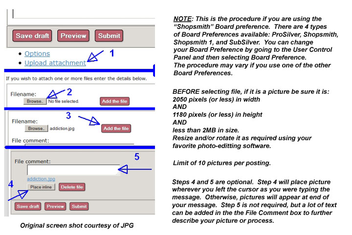

Photos didn't attach. Most likely you need to resize them before attaching. An easily missed error message will appear near the top of the web page when photos are not successfully attached, and usually requires scrolling up to see. Below are some tips for successfully attaching photos.6060 wrote:Here are some photos.
- How To Post a Pix.jpg (116.63 KiB) Viewed 6409 times

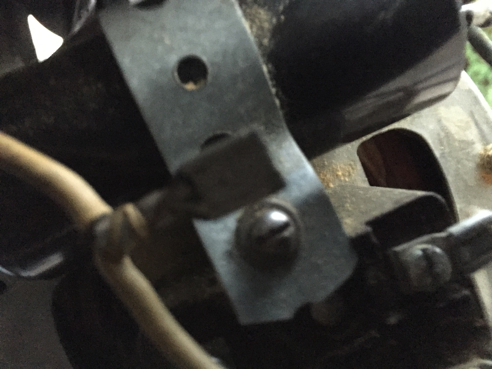

This white wire broke off, but was on before.
Re: Spring Clip - how to install
The white wire(s) go on terminal 5.
So would you say my next move is to take the motor and starter switch off and clean all the contacts? Like I said the white wire was on terminal 5 but broke off. I tried starting it while having the white wires touching the terminals and nothing happened. Should I just get new wires? Thanks for your input.JPG wrote:The white wire(s) go on terminal 5.
