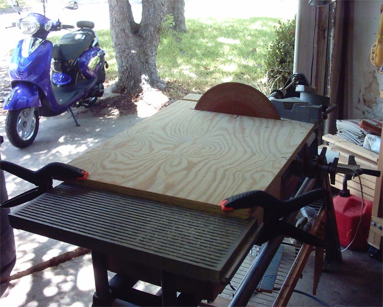

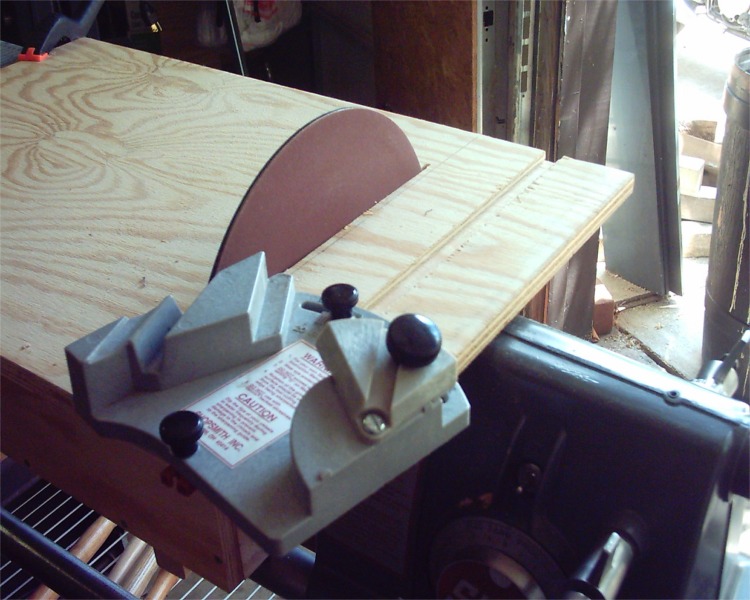

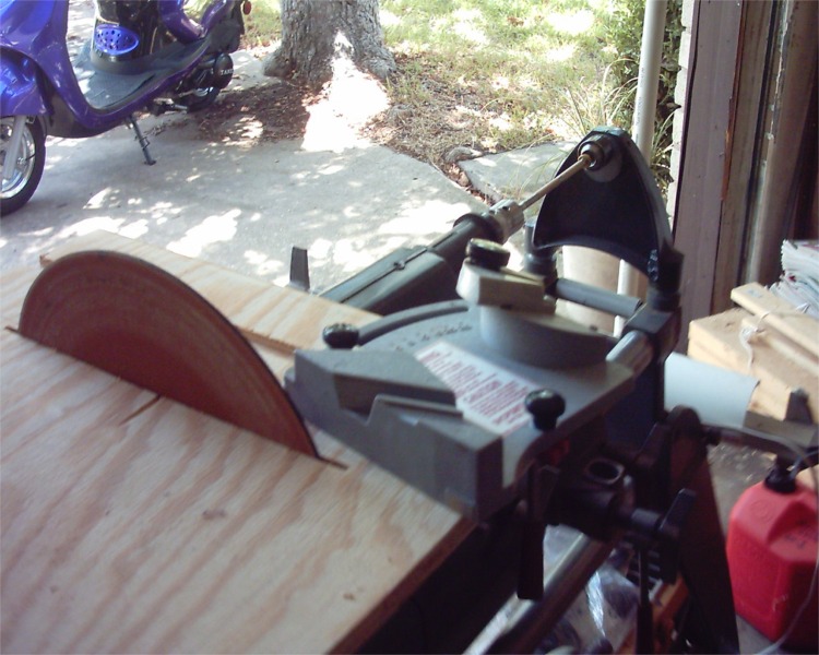

Here is the information I mentioned in my post of 10 July 2008. My BIL finished the prototype design of his idea for using the Shopsmith Sharpening Jig while turning. We discussed it on the phone a couple of times and this is not the final product but I thought you might be interested anyway. We are working on making this thing adjustable so you can use it with any (or nearly any) length turning - not just pens.
If you ever need to use your chisel sharpening jig while turning pens (and who doesn't?), here's something you might want to try.
Take a piece of 3/4" plywood, as wide as the extension table, cut a groove to hold the sharpening jig, cut a slot through which to poke the sanding disk, put 150 grit aluminum oxide paper on the BACKSIDE of the disk, clamp the plywood to the extension table, mount the sharpening jig, and sharpen away - when turning pens. When your chisel gets dull and needs a touchup, rather than going to the other side of the Shopsmith or to another tool in your shop, just move to the left, touch up your chisel and get back to "work". It works pretty neat. Just make sure you cover your way tubes to prevent metal filings from accumulating on them.
If you want more details than this short description, just ask.
Leonard

Could you take a few pictures of your setup and psot them. I am not following the location of the extension table while the setup of pens is still on the lathe.
