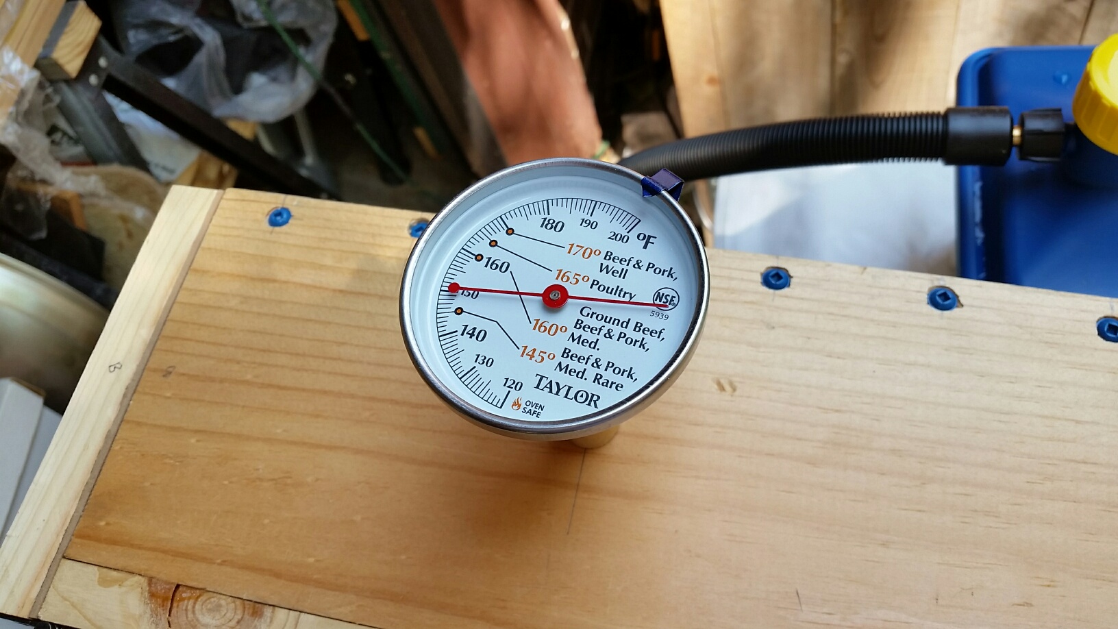

Today I decided to give it another shot. I've added a thermometer so I had a better idea of when to time from, always a good idea even if I don't know what I'm doing at least I can learn from the experience.

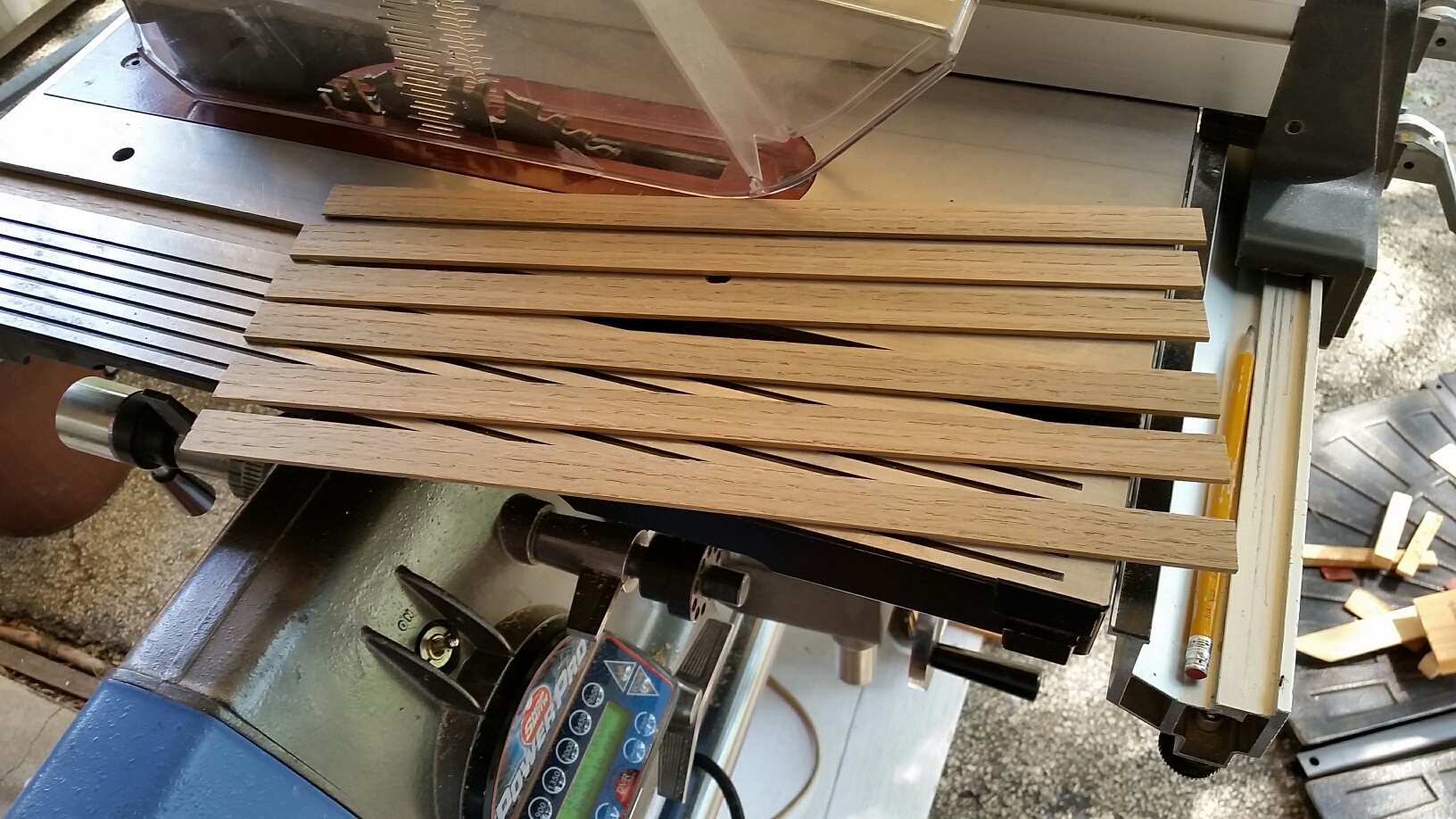

I wanted to try a different wood, so I had a piece of oak to try. I went with the length it was, just under 15" long and then cut it in to 1/8" thick strips. While on the subject I thought I might show you all I cut the strips.

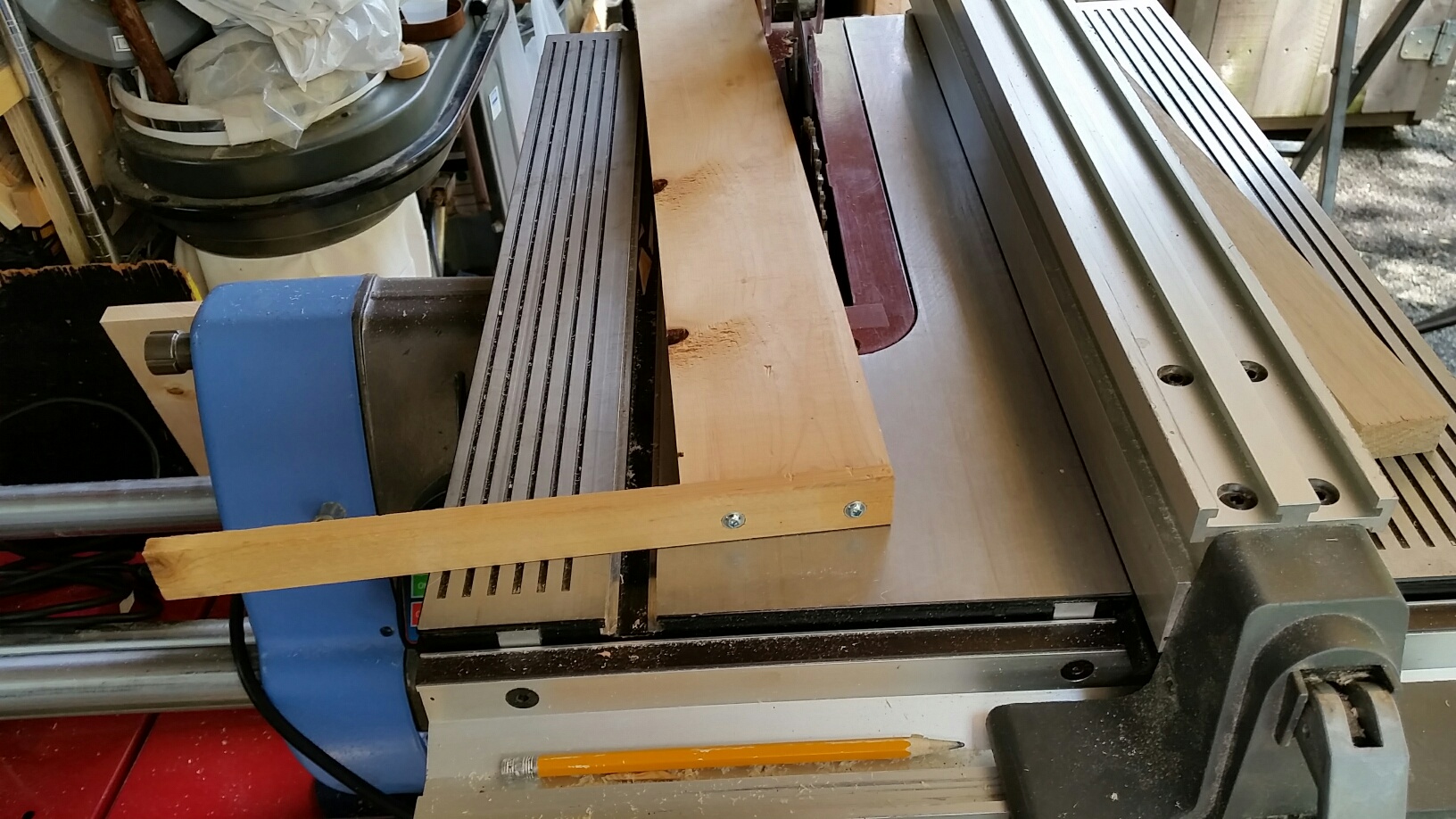

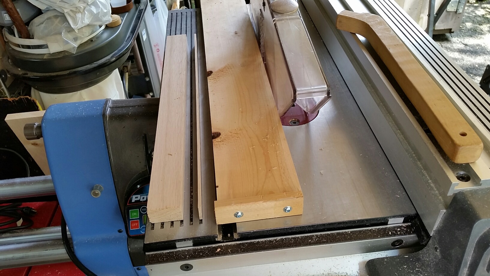

I started with a piece of scrap pine and ripped off some damaged areas and made it parallel to the rip fence which it might or might not have been before. Then I screwed on another scrap piece of wood like this:

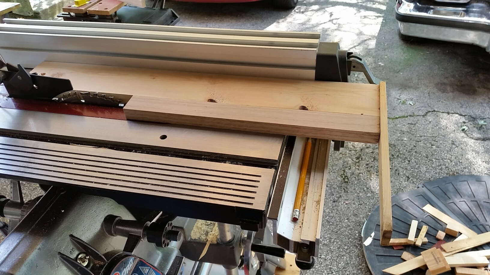

I then moved the rip fence out another 1/8". So with the jig against the fence and the work piece against the jig and held my the tail hook I was ready to make the strips.

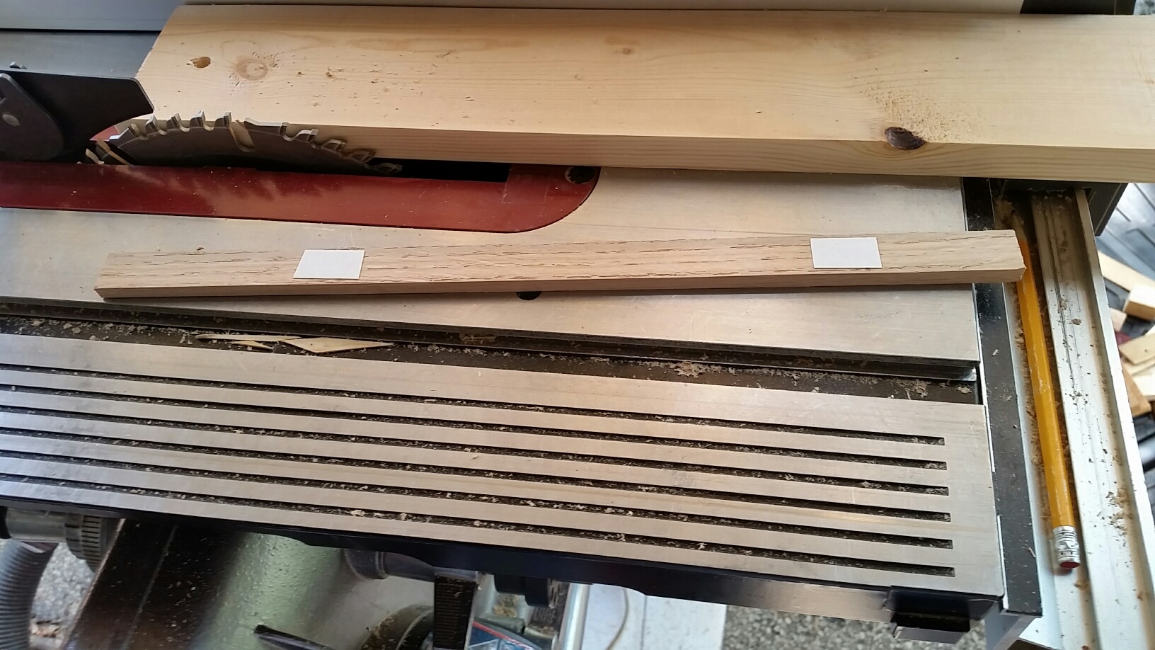

After the first cut the "tail hook" has been sized along with the work piece. It looks like this:
The rip fence doesn't have to move any more, just keep feeding the stock through and getting the 1/8" strips. Now normally I just stop when the stock gets thin but today I wanted to get a couple more out of it. When the stock gets to narrow then it wants to lift as you cut and there is nothing but the stiffness of the wood to keep it down. It starts chattering so to speak so to prevent this I use some double sided tape. Yes the tape makes the strips a bit narrower but you can either live with it or adjust the rip fence. For this project I don't think the thickness of the tape will make any difference...... Now this has some risks and if you don't feel safe making those last couple of cuts then don't. Just get another wider piece to cut more strips from.
Anyway it take only a short time to do the strips and in this case I made a half dozen.
With my strips cut I then set up the steamer. Plugged in in at:
Thermometer reading at the start:

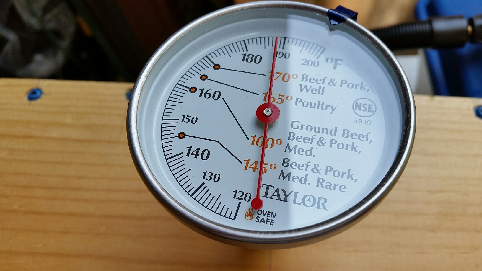

At this point the temperature had reached saturation or what I use for that temperature.

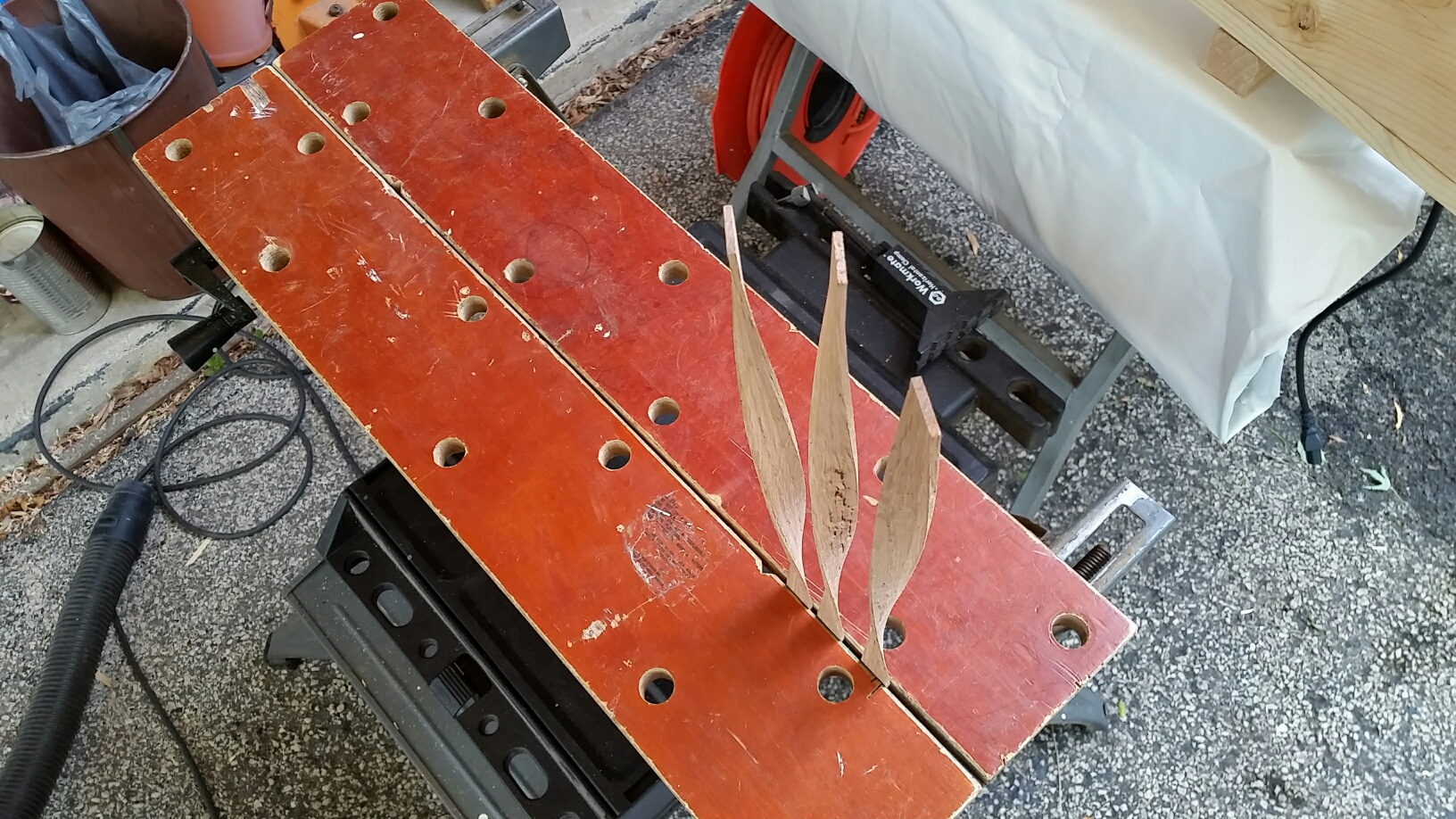

The good news is that all three twisted just fine without cracking! So out of this sample it looks like I can proceed with my project. I will have to add some more dowels so I can do more at a time but other then that I think I'm happy.

In the description they said the temperature in the box would reach 212 degrees, now were I'm measuring I don't get that warm. The max I've seen is 191 degrees. Perhaps where you measure is a detail or perhaps the box would require insulation to get that warm??
The temperature raise is pretty quick when it starts out then slows to hardly moving at about 188 degrees. The last couple of degrees above that takes an hour. So from say 75 degrees ambient to 188 degrees is about 35 to 40 minutes the rest is really slow. The times are approximate as I'm not standing over the box watching it every minute and depending on when I get back depends on my time estimates.
