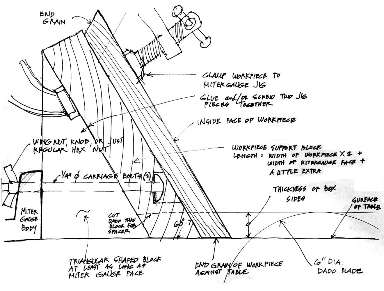

While I'm not exactly sure how a JointMatic works, it sounds like you plan to use finger or box joints rather than relying on end grain for gluing.
Shopsmith has tips for making a jig for making finger or box joints on the table saw using a dado blade. This link covers many types of joints ... scroll down for Finger Joints.
http://www.shopsmith.com/academy/tblsaw ... /index.htm
Attached is a rough sketch of how I would modify the jig shown for 90 degree angle corners to be able to make 60 degree angle corners.

- 60 degree box joint jig.jpg (200.52 KiB) Viewed 8396 times
Re: Hexagon Box
Excellent sketching!!!

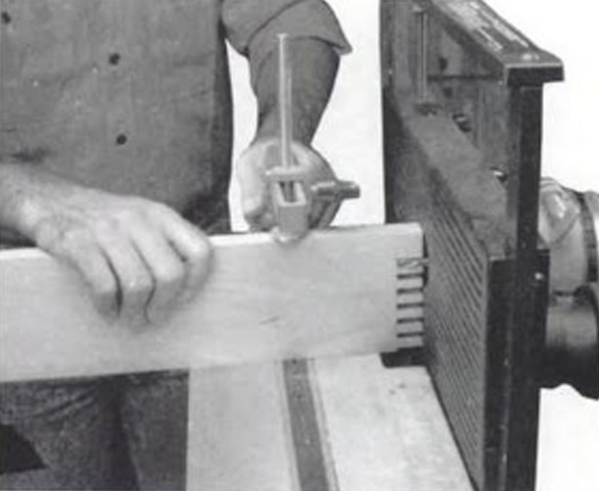

After doing a little more searching and researching into what and how a Joint-Matic works, I found this picture that may be of interest. It appears that by using this method you don't need the Bevel Miter Gauge, just a regular miter gauge which you could adjust to your required angle. And with the Joint-Matic's ability to precisely control height adjustment and therefore the spacing of the joints, would this not work?
- Box Joints on Joint-Matic.jpg (103.66 KiB) Viewed 8310 times
Re: Hexagon Box
I haven't tried yet but I think I could set my miter gauge at 30 degrees on the joint matic and I should be able to a pretty accurate cut. I will also try cutting at 90 degrees to see what it produces. I appreciate the responses. A hex box with finger or dado joints would look nice. Larry
