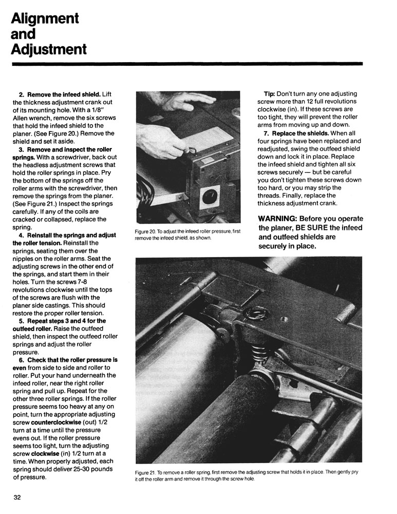

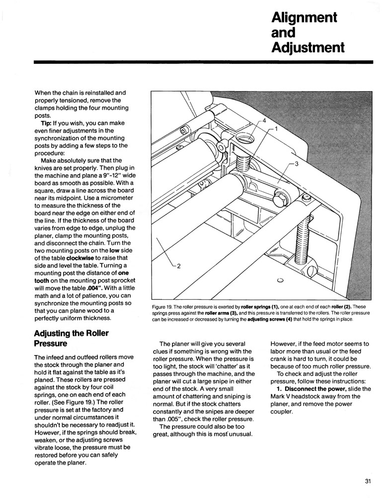

You might want to check the infeed roller pressure. Below are two pages from the Owner's Manual for that adjustment procedure.
If you have the steel infeed roller, any indendations should be removed by the cut, unless you cut is very shallow. Have you tried increasing the depth of the cut (if that is possible without going below your desired thickness)? If you have a motor feed, any excessive infeed roller pressure may not be as detectable as it might be with a manual feed.
Echoing what others have said, pictures would help. Resize and save pictures to less than 2050 pixels wide x less than 1180 pixels high x less than 2 MB in size and they should attach OK. All three size limits must be met.

- ssplaner031-150dpi.jpg (218.72 KiB) Viewed 11088 times
- ssplaner032-150dpi.jpg (216.64 KiB) Viewed 11088 times

Didn't realize it has the metal input roller and that is what is making the marks. I hadn't taken that cover off and I was barely planing the wood. If I take more off at a time it doesn't leave those makes. Guess if I want to plane that fine I will have to lighten the pressure on the input roller? Thanks again for the help. If I'd taken that cover off to begin with I'd have figured it out, live and learn!
