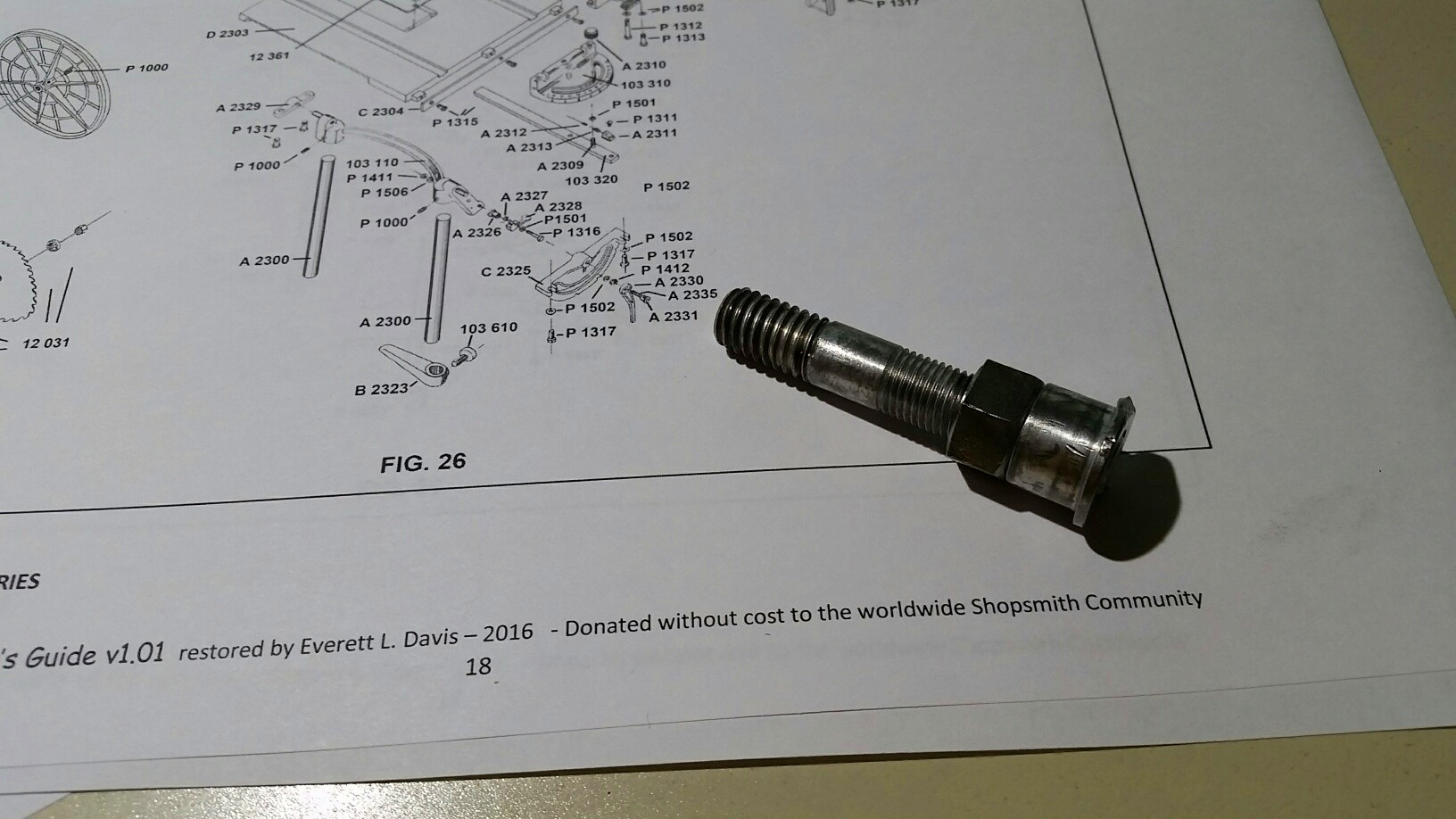

So now I'm stuck for the moment with this new issue. The nut is jammed against the end piece and I can't get it to budge. It is not corroded so at least I have that going for me.

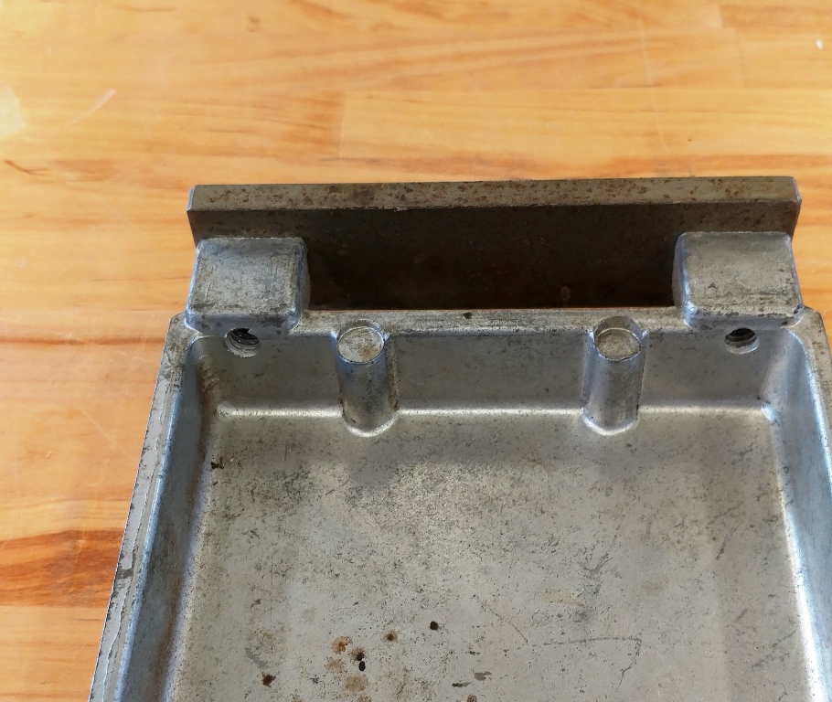

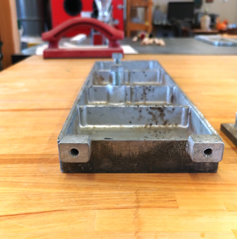

This is very interesting. Ed, your holes are clearly not in the center of the boss. RPD's picture looks like his are. The overhang of his fence bar appears to be the same as one of my aux tables with tapped holes. My other tables have the same overhang. Also as you can see the tapped holes are in the center of the boss.reible wrote:Well the plot thickens as they say. Mine is number 94506. My thought is now that this was a change made towards the end of production for one or many reasons. It might have been cheaper to just do away with having to tap the holes, just a few minutes here and there makes up some savings and it is more then likely cheaper to buy the bolts and the added time to have it assembled that way rather then the time it took to tap the holes.
Anyway that is also a possibility.
It is hard to believe that Magna thought three through holes with the added cost of the nuts were going to save the company enough money over three tapped holes to make the change. I don't think they made any other changes at the end of production.

My auxiliary table is also tapped. And the holes much better centered then the main table.
The reason I'm think now that this is a factory change is the square nuts are just like I have. Now if someone did this as a diy fix it would be surprising that they had the same square nuts to use.

It also makes no sense why your holes are so off center. Maybe RPD will remove his fence bar and show how his holes are centered.
Any way it is an interesting discovery which we will probably never know why.

Jam nuts on the course thread end.reible wrote:So now I'm stuck for the moment with this new issue. The nut is jammed against the end piece and I can't get it to budge. It is not corroded so at least I have that going for me.

BTW I did manage to get the nut loose, good old wood jaws in my bench vise and a good tap on the wrench did it.

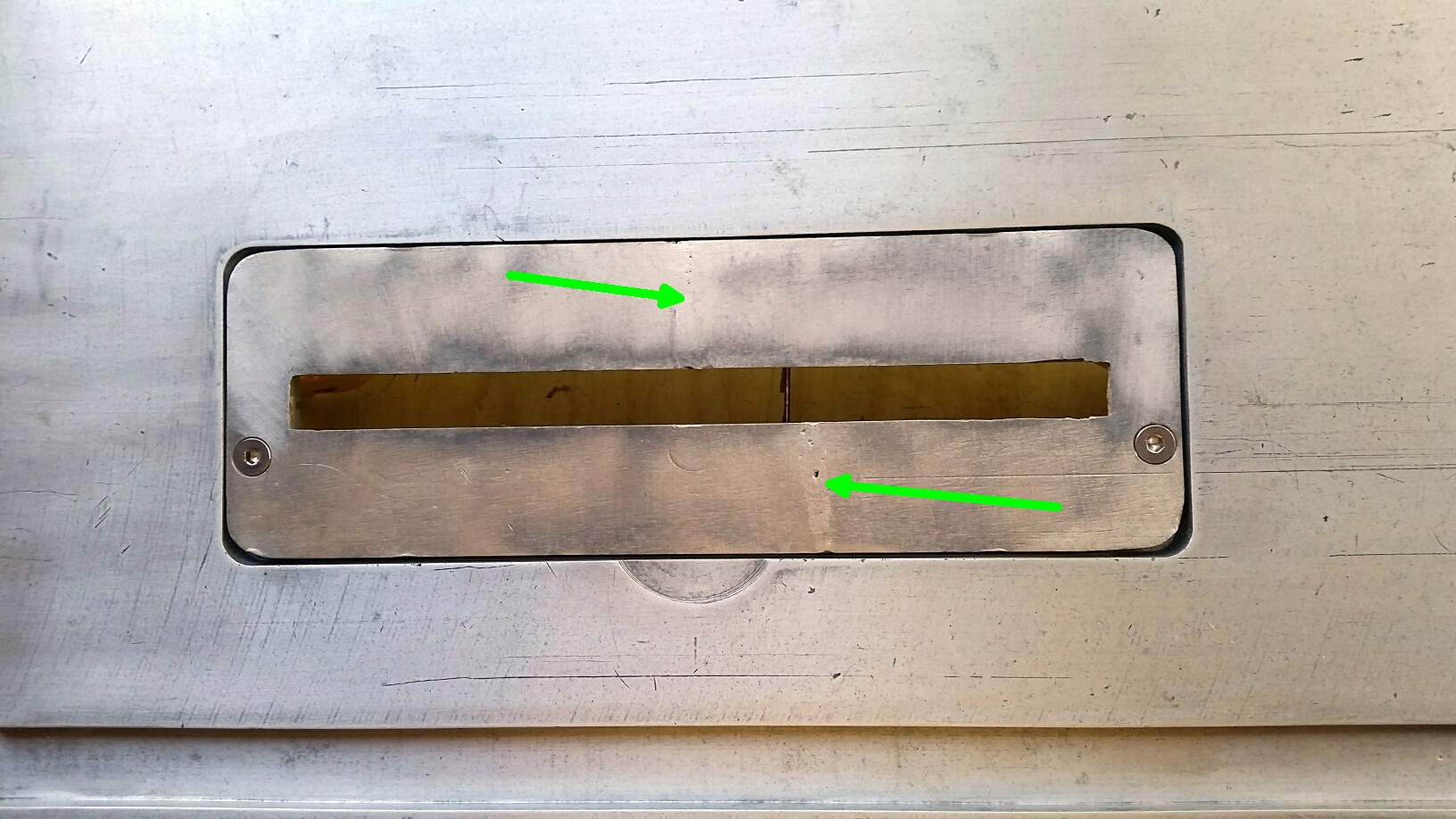

Here is a picture of my table insert. If you look near the arrows you can see where it had broken, actually looks like it was in two pieces. More weld shows up on the bottom so it still looks pretty good on the top.
I was going to use it to make a pattern for more inserts but the fit is really poor. Maybe it just this one but look at the corners. Typical?
