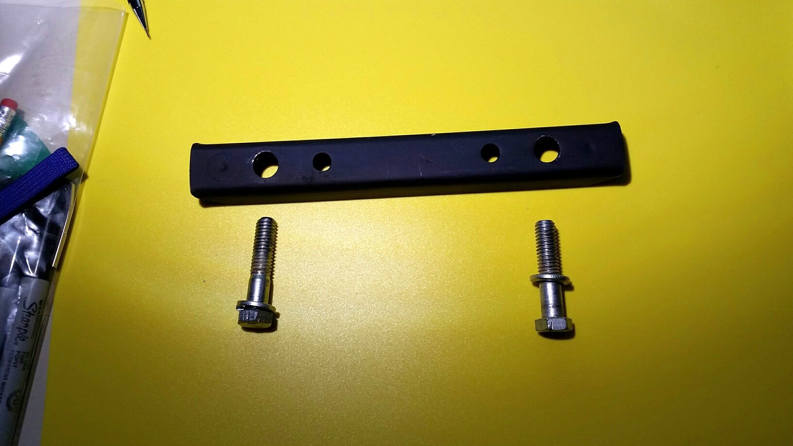

I'm starting to put my mini 500 together today and since the tubes are not yet mounted I pulled the bar and fasteners.
There should be no reason the tubes can not be tightened if you have the stock hardware. Close inspection to see if there is any damage to the parts should be carried out. It is also possible to use the wrong length of fastener, if they are too long they could bottom out in the casting and thus not be able to be tightened. I measured mine at 1-3/4".
Again for those who might be reading this but never had a look see at the parts this is the bar and the two fasteners that secure the tubes.

reible wrote:I'm starting to put my mini 500 together today and since the tubes are not yet mounted I pulled the bar and fasteners.
Very good point.

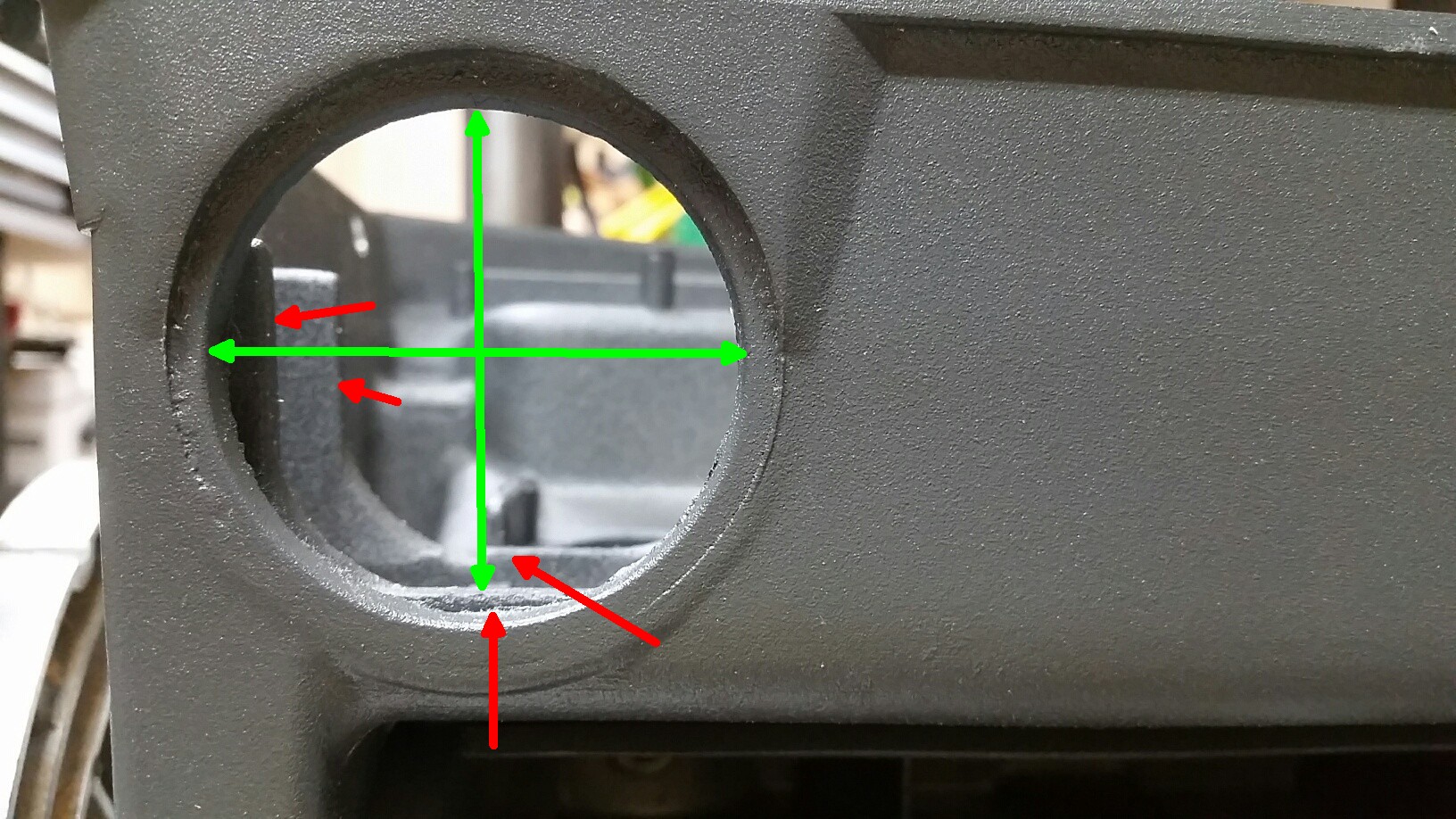

Using a rule it looks like it can almost take a 1-7/8 tube. At least side to side at the start of the opening. The flashing from the casting is not clean so it is very hard to tell if it would actually go in without some filing. But that doesn't matter as the vertical will not fit do to structural parts in the casting and on the outside there are two ribs that would also get in the way. Note the red arrows in the image. Now if you really wanted to get them in I think you could machine or grind the bits away and have it slide in.
So as is the larger tubes will not just slip in.

reible wrote:Using a rule it looks like it can almost take a 1-7/8 tube. At least side to side at the start of the opening. The flashing from the casting is not clean so it is very hard to tell if it would actually go in without some filing. But that doesn't matter as the vertical will not fit do to structural parts in the casting and on the outside there are two ribs that would also get in the way. Note the red arrows in the image. Now if you really wanted to get them in I think you could machine or grind the bits away and have it slide in.
There could be other reasons for not wanting them to mate??
Those 'ribs' on the outer side are what positions the tubes horizontally(c-c)distance. They are differently sized on the old greenies/goldies that have the larger tubes. The beveled ends of the clamp force the tubes against those ribs(all the surfaces with a red arrows in Ed's pix above).
Do you have the clamp beveled ends pressing against the tubes?
