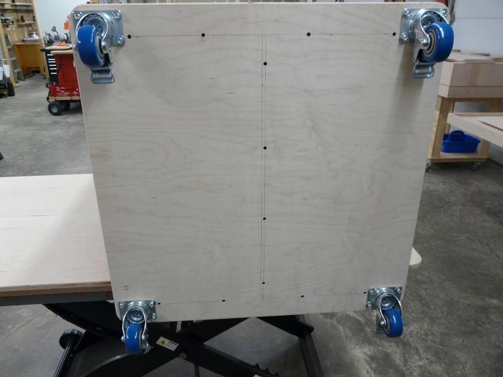

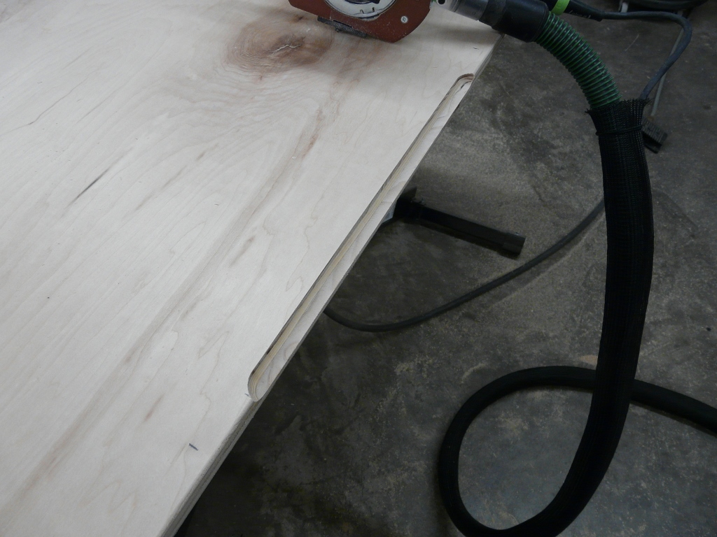

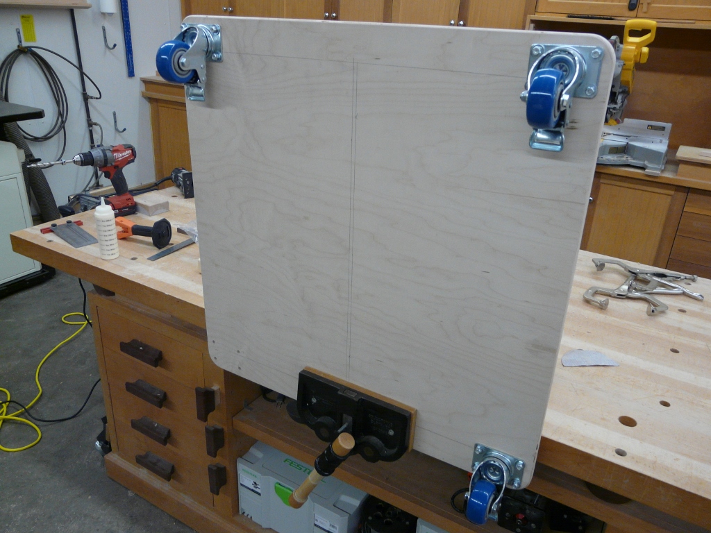

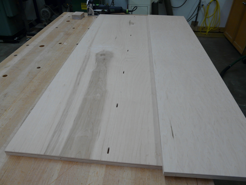

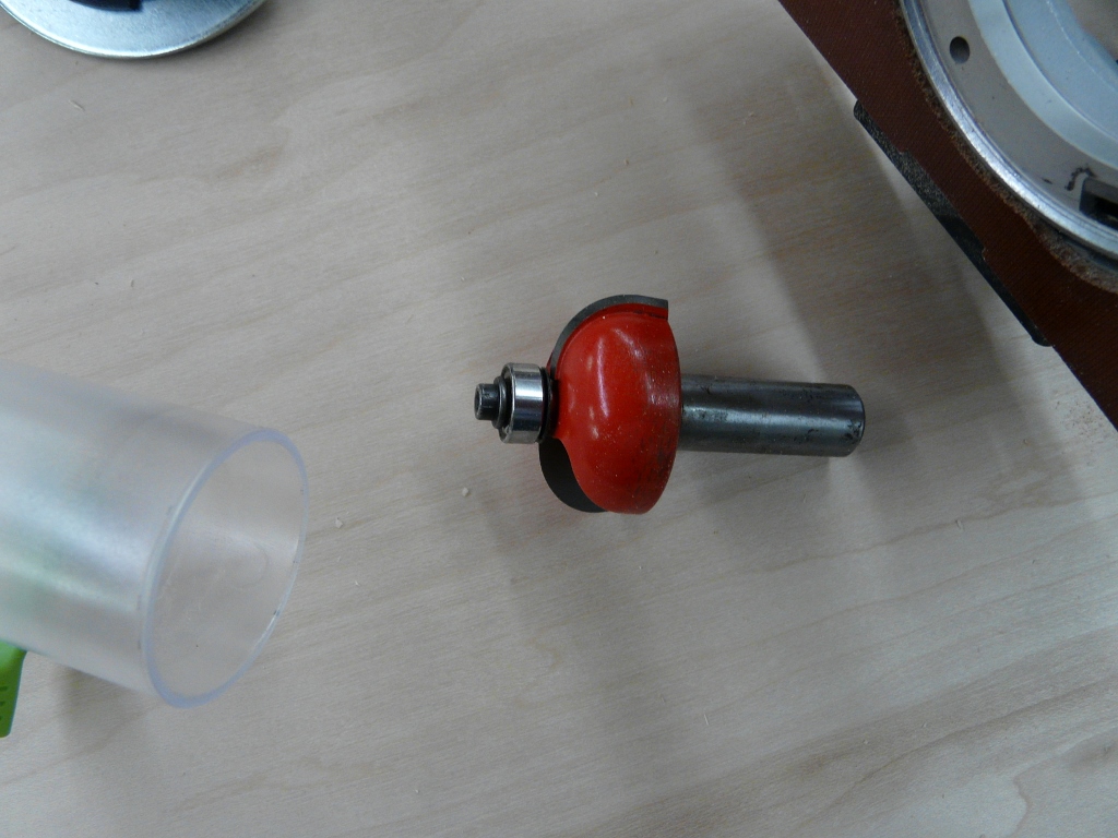

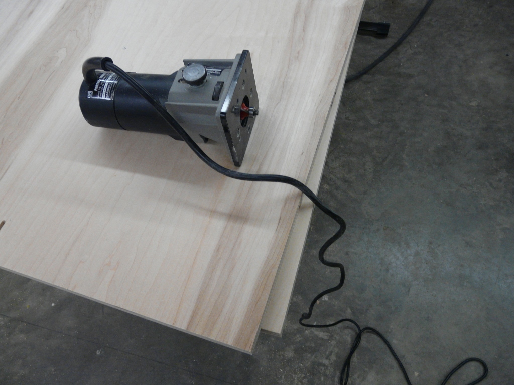

I'm using raw edge plywood for this and a 3/16" radius bit to ease all the edges.
Also using a cove bit to create a finger pull for the doors.

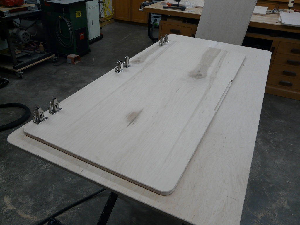

And the casters finally arrived. The postal service lost the first order. :rolleyes: :rolleyes:
And I decided to double up on the hinges to carry the weight.

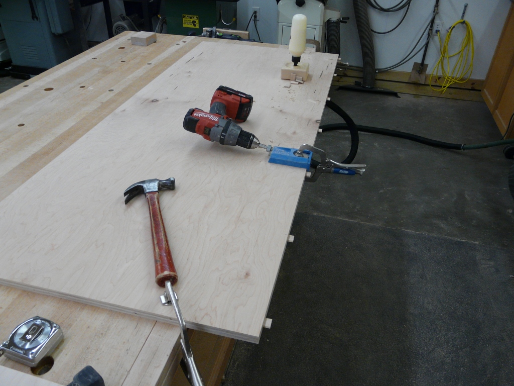

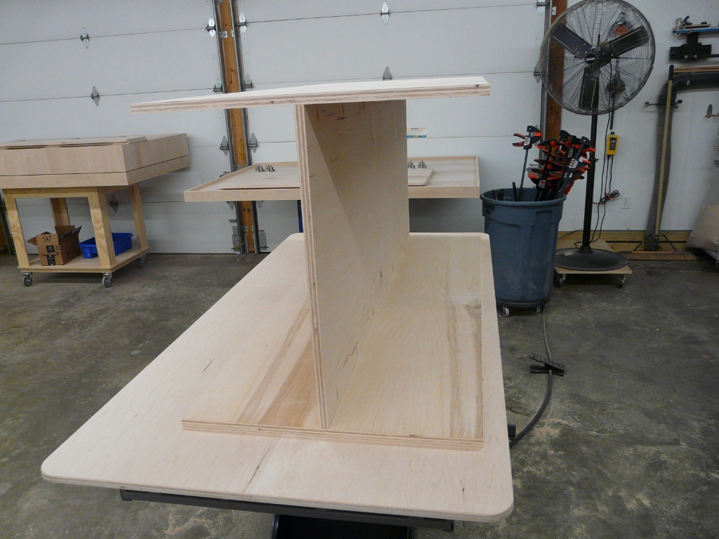

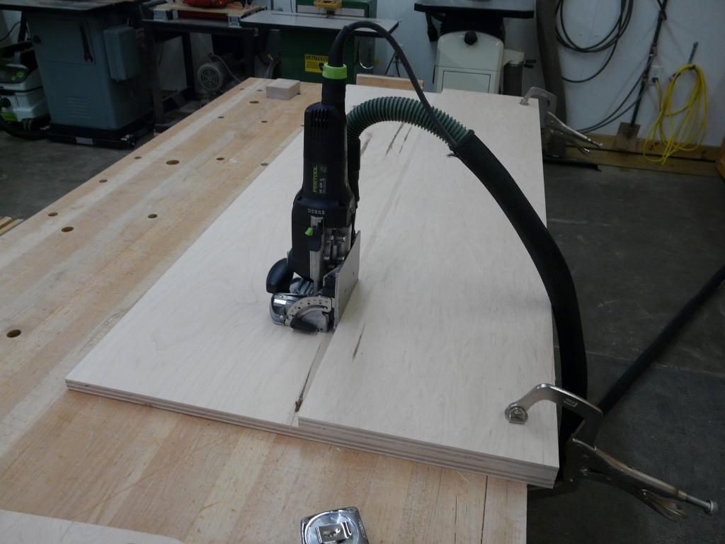

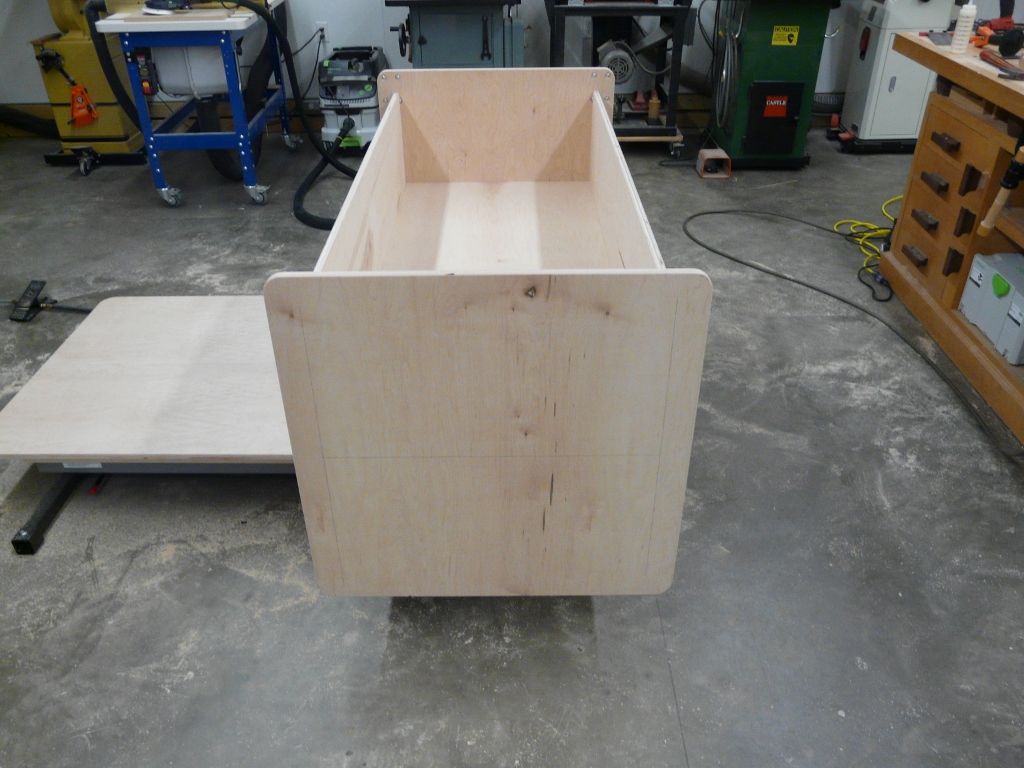

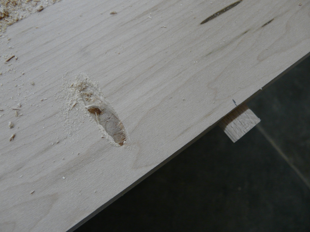

I used dominoes and pocket screws to attach the sides to the partition.
And came up with this BIG H. :D

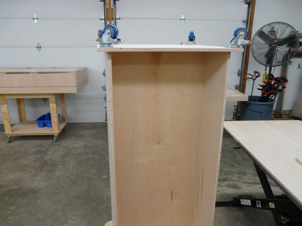

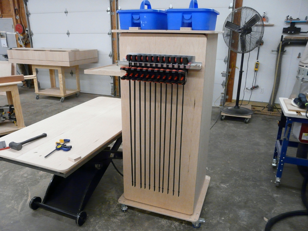

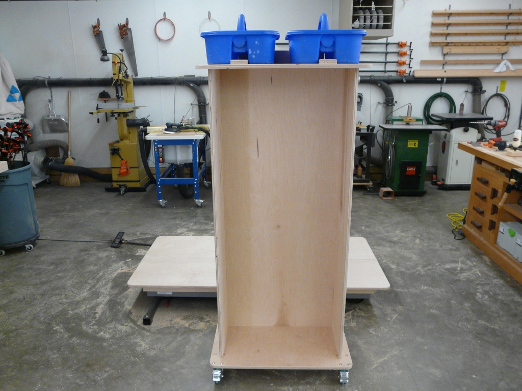

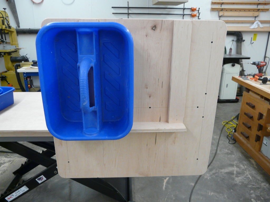

Next it was time to attach the bottom and top to the big H.

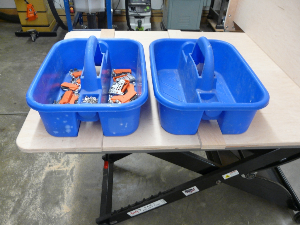

This is where I discovered that the top of this rack would be a great place to store the totes for my drawer clips.
P1120153 (1024x768).jpg (385.14 KiB) Viewed 9830 times
I built a simple plywood track to hold them in place.
Mark

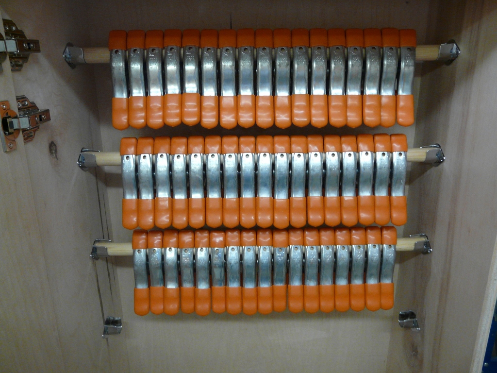

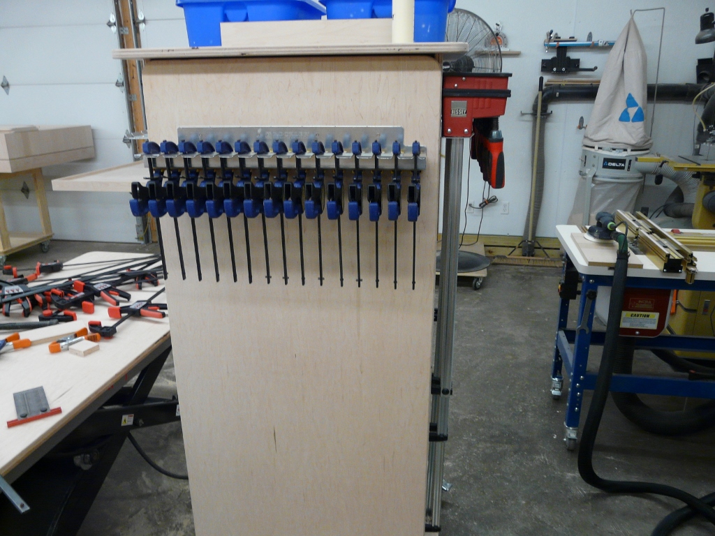

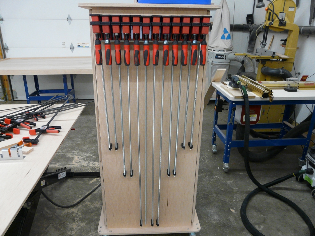

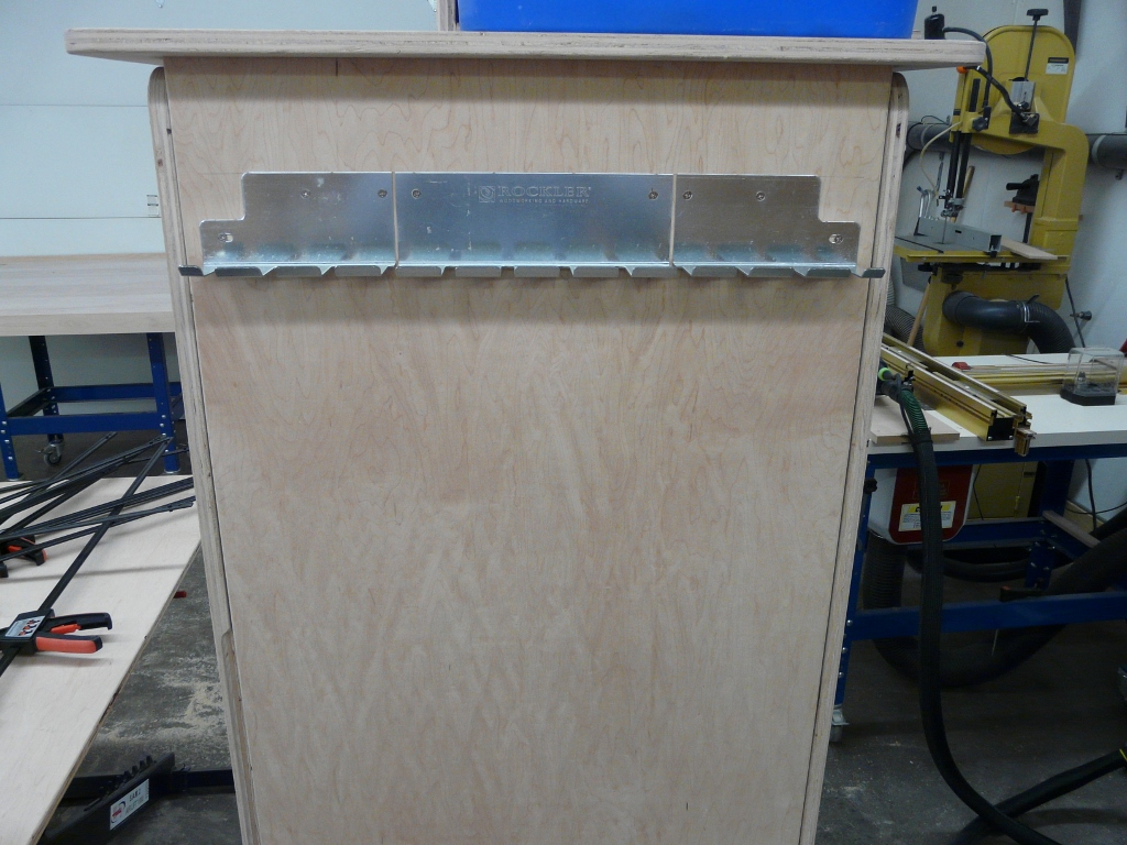

Time to hang the doors and start placing the clamp holders.

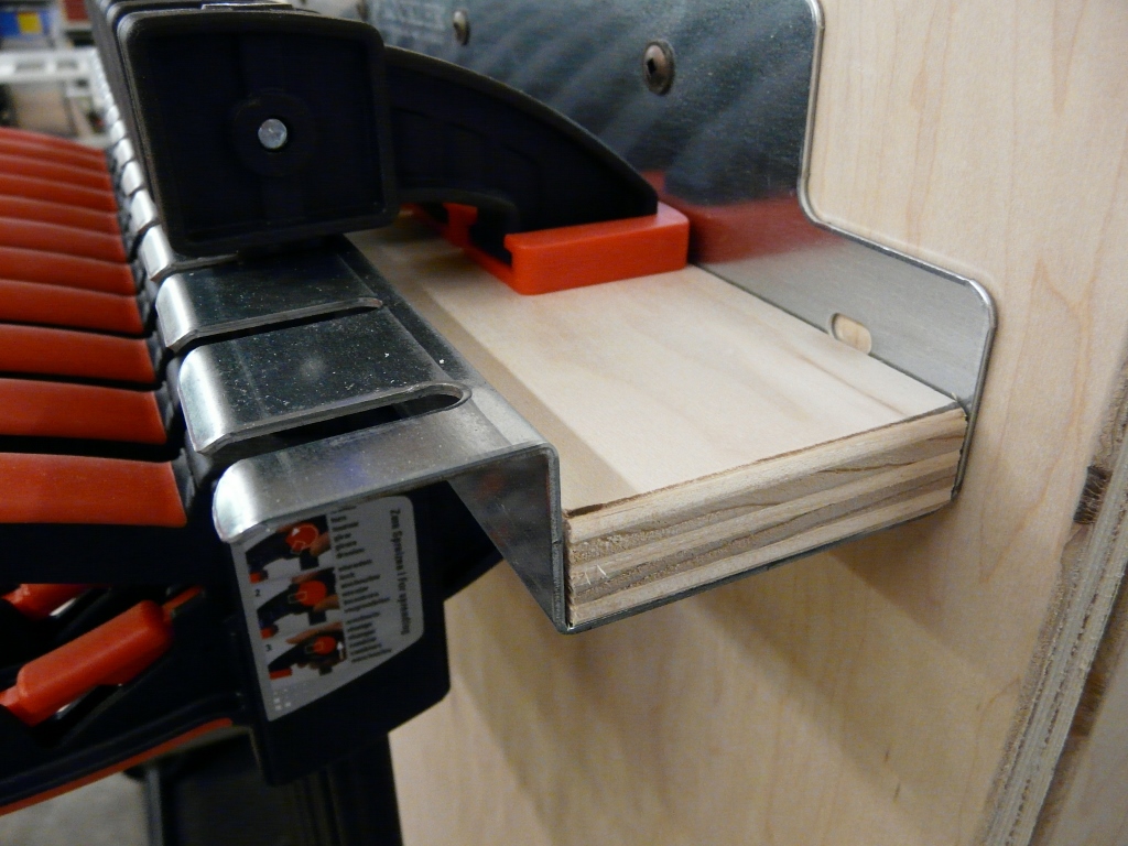

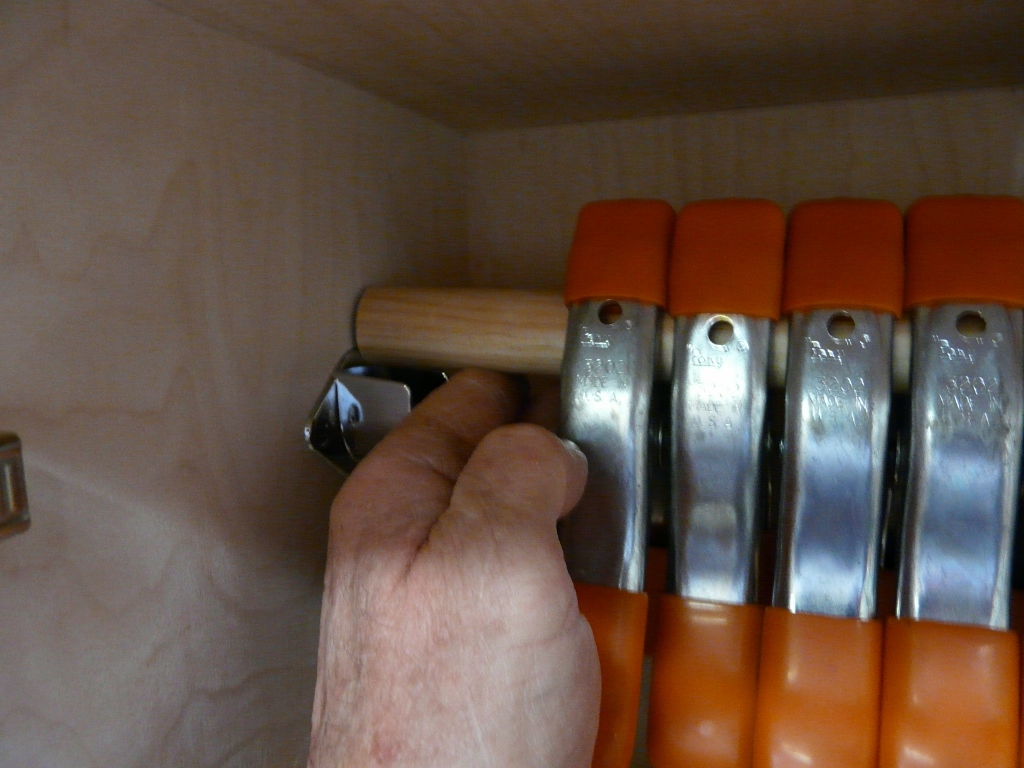

I decided to add a plywood piece on the quick clamp hangers to be able to squeeze them down so they wont bang around when I open the doors.
The idea to cut the parallel clamp holder into 3 sections worked pretty well. I just had to drill some extra holes for screws.

Clamp Kebabs. ;) :)
I can lift out the entire racks which makes using these pretty fast.
Well that's where I stopped today. I need to pick up some more skewers to finish the inside on the first side. Also the rest of my Rockler holders are setting in Spartanburg at the UPS terminal and will be delivered Monday. Its working out very well and I'll be excited to see it finished!
