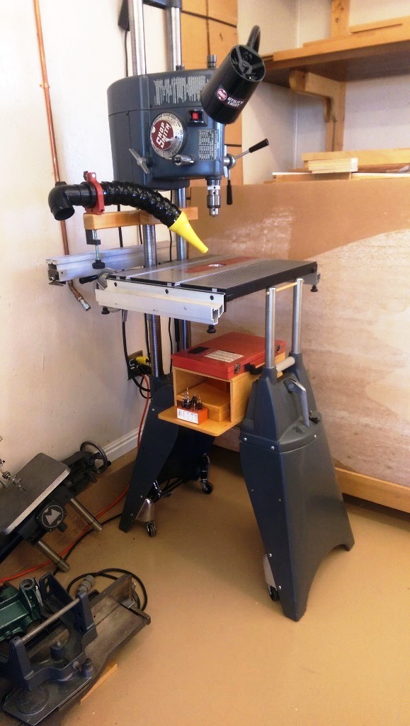

could one of you guy with the headstock reversed when making your SS a drill press only machine post a picture.
thanks
John
thanks
John
Re: Drill Press only shorty
Here is mine. I wouldn't change a thing. The bench tubes are 18". The way tubes are full length thick wall 10ER tubes. Absolutely solid as a rock!farley wrote:could one of you guy with the headstock reversed when making your SS a drill press only machine post a picture.
thanks
John
- IMAG0236.jpg (150.29 KiB) Viewed 21030 times
thanks, I am trying to decide the length of the bench tubes. Shorter takes up a little less space sticking out.
j
j
You can certainly make the bench tubes a few inches shorter. I used what I had. The 18" pieces left over from my shorty. I saw no reason at the time to make them shorter and still don't. The bottom of the leg is about even with the front of the table. It has never been a problem. I stand off slightly to the right when I drill so when I walk up to the machine my left foot slides under the arch in the leg and my right foot is outside the right side of the leg. It was very natural the first time I used it and was not something I had to learn.farley wrote:thanks, I am trying to decide the length of the bench tubes. Shorter takes up a little less space sticking out.
j
As I said, I would not change a thing.
