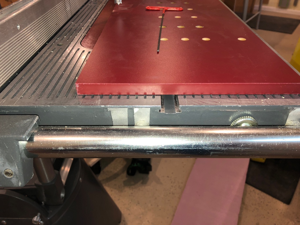

I just checked and sled dropoff sits flat on the SS table AFTER the set screws are tightened. Here's a photo of it with the set screws tightened.
Dropoff on SS510
Dropoff on SS510

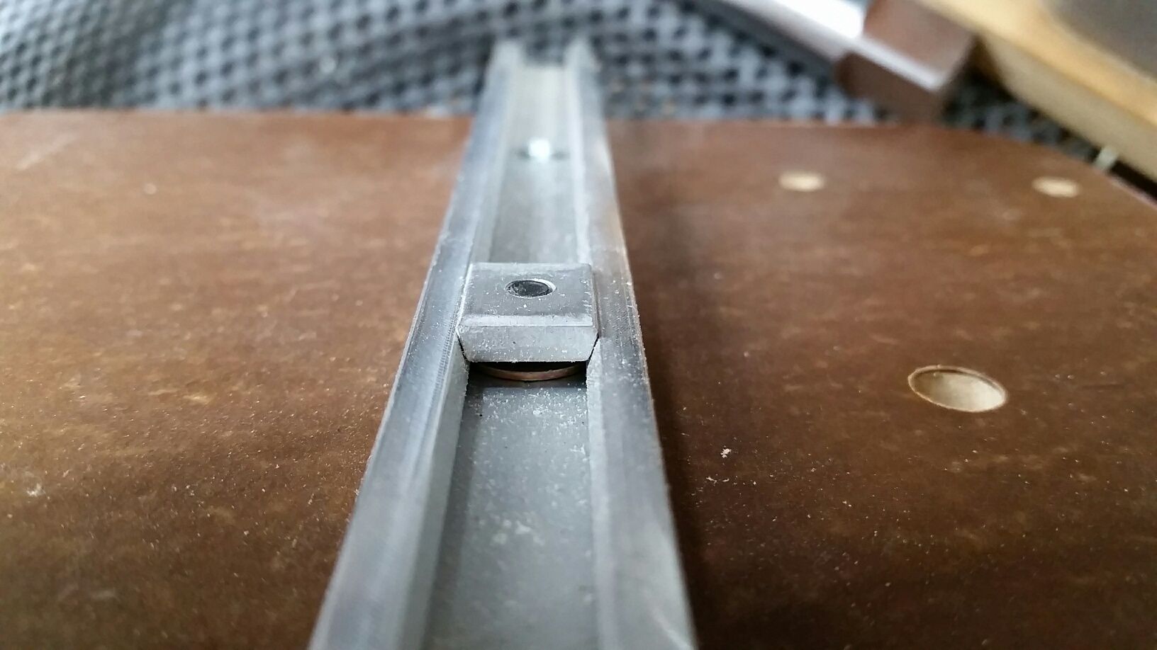

On the bottom of the table, there is a t-track style miter bar that has wedges in it that spread the bar to lock it in place much like the SS miter bar. If you look at the picture below, the wedge is proud of the miter bar and on mine when it is fairly loose, the gap from the SS table to the sled dropoff is about 1/8"
Sled dropoff underside
My guess would be the poster had the same issue to a greater extent and the wedge didn't go up enough for the table to sit flat.
I also have the same setup on my big tablesaw and the wedges are slightly recessed even when the set screws are loose. My conclusion is that Incra is using the same wdges on the narrower, thinner ShopSmith version of the miter bars as they are on the standard miter bars.
On a side note, the set screws are 3/32" hex vs the 5/32" hex for everything else ShopSmith.
Finally, the thickness of my two Miter 5000 sled tables are 0.555" and 0.554"

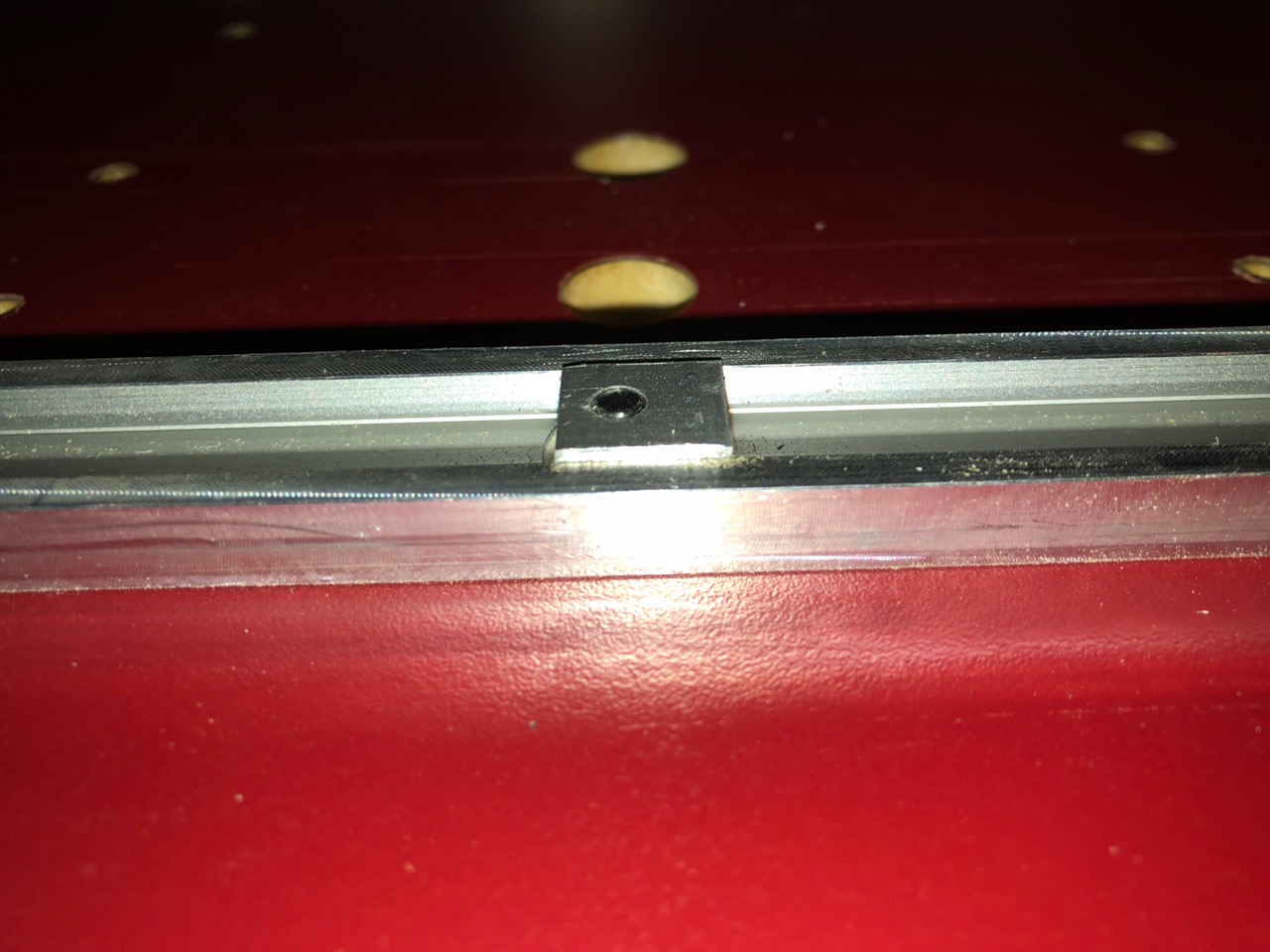

Just finished checking my miter express and it works fine. Even if it did have a problem it looks to be pretty easy to fix...... sanding AL is pretty easy and fast.
The parts in question are wedged shaped as seen here:
