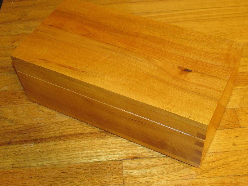

I would definitely saw it into slabs and dry it a year or two. Seldom can you dry a log in the round without having it crack badly and be of little use. If you saw it now, in the future you can decide what to make from it when it is dry enough to use.
I got a small piece of beech some years ago. I sawed it into thin boards and made this box. If you have more wood, you can make something much larger and nicer.
