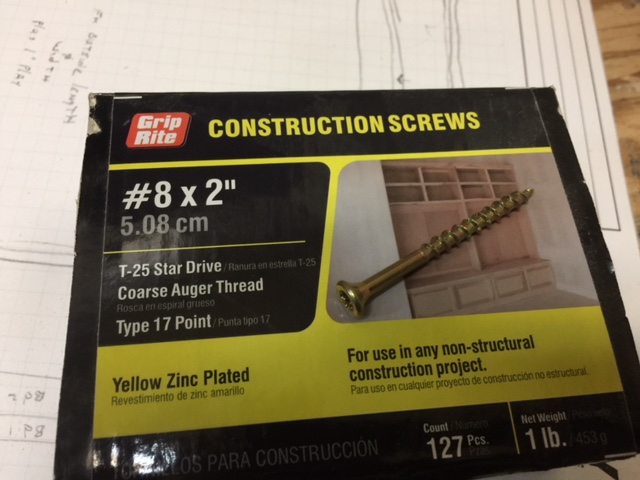

Thanks, a little pricey for this job, this is what I had purchased for the job.benush26 wrote:Sorry to come late to the party, but if you have yet to choose the type of screw, I’d like to recommend the fastenmaster. There are a few styles and they are pricey!, but will hold amazingly well. Fairly certain they are available at HD (I usually buy mine via Amazon since projects that need them have a decent lead time) and probably most national chain hardware stores. I’m not certain of the length of screw you are planning to use. Fastenmaster tend to be long, or at least the ones I’ve purchased.

"Construction Screws" - for use in any non-structural construction project.
I have difficulty interpreting the wording in the advertisement but I do believe these will do the trick very well. I also believe in your choice of heads. I use star drives a lot.

Ditto, I won't tell you how long I stared at the wording before I got them. I kept trying to figure out if I wanted them or not.dusty wrote:"Construction Screws" - for use in any non-structural construction project.

Was that due to the statement "For use on any non-structural construction project"? Only means they MAY not meet cross sectional area or have been vendor tested and certified by manufacturer to be in compliance with building code requirements. I would not hesitate to use them for any project.wrmnfzy wrote:Ditto, I won't tell you how long I stared at the wording before I got them. I kept trying to figure out if I wanted them or not.dusty wrote:"Construction Screws" - for use in any non-structural construction project.
