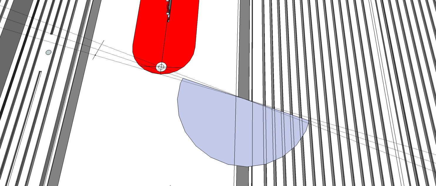

Michael, if you are using the Shopsmith miter gauge the protractor is about a 3" arc. It is at the edge of that 3" arc where you are reading the degree markings. Hard, to say the least, to set the pointer midway between two marks (22° and 23°). But if the arc was say 12" long, it would be somewhat easier to distinguish the midway point.
To achieve this wider arc place a rigid strange edge (12" steel ruler) to the face of the protractor. With the protractor set at 22° place a mark at the far end of the ruler. Now move the protractor to 23° and place another mark. Midway between those two marks is 22.5°. This won't be perfect but it will be more accurate than what you started with. To achieve even greater accuracy - use a 3' straight edge or somewhere in between.
splitting hairs.png (85.41 KiB) Viewed 8182 times
I used a 5 degree separation here for display purposes. A 1 degree separation would obviously be more difficult however that can be overcome by making the measurement further away from the pivot point.

dusty wrote:INTERPOLATE

I've play with this a little bit more. It does not work if done exactly as I described. The measurements cannot be taken at the tables edge or at the edge of the miter slot. Taking the measurements (reference points) there introduces a very slight amount of error.
The measurements need to be taken on an arc. An arc of any size will work and the vertex of the arc needs to be the center of a miter track (the pivot point of the protractor in your miter gauge.
Ed Reible experienced some minor error that he experienced and I believe he took his measurements as I described. Had he taken those measurements on the arc I expect that the error will be even further minimized.
Interesting application of simple mathematics (geometry).

An 'arc' is unnecessary. a point on both lines equidistant along each line from the 'vertex' will suffice. Connect those two points and bisect that line and draw the final line(half degree) from the vertex to the bisecting point.
Actually dividing the line into fractional lengths will give fractional partial degrees.
Re: How to set odd anagles on miter gauge?
JPG wrote:An 'arc' is unnecessary. a point on both lines equidistant along each line from the 'vertex' will suffice. Connect those two points and bisect that line and draw the final line(half degree) from the vertex to the bisecting point.
Good point. The arc is not required. But if the measurements are made at points "equal distance from the vertex" are those not the same points as those taken on an arc whose radius is that same length. I think this is apples and apples.
Bottom line: I was wrong in my initial comments about taking measurements at the tables edge.
