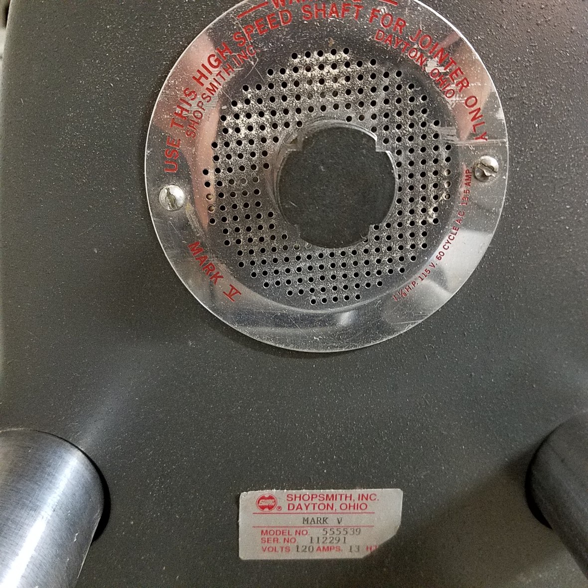

Since you are showing yours, here are mine. Two still different configurations.
Nameplates 001.jpg (1.44 MiB) Viewed 4139 times
Nameplates 002.jpg (1.29 MiB) Viewed 4139 times
Apparent contradiction: The one serial number 152168 reportedly built in May 1983 is rough gray finish which was (allegedly) introduced in 1984.
