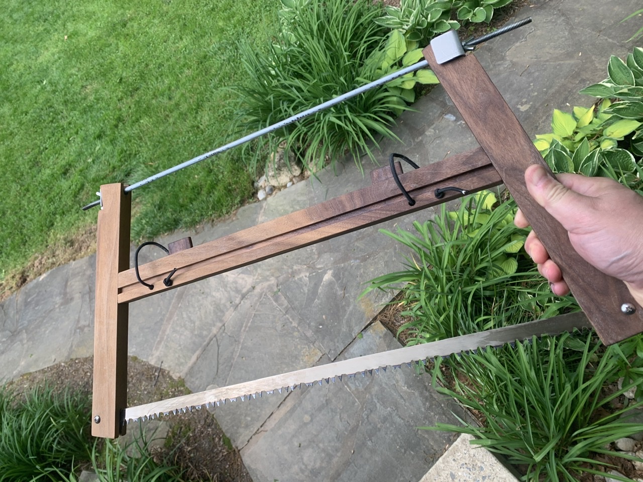

Re: The Buck (Saw) Stops Here
NICE!!! I think I would round off some edges before taking it into the wilderness. ;)

JPG wrote:NICE!!! I think I would round off some edges before taking it into the wilderness. ;)

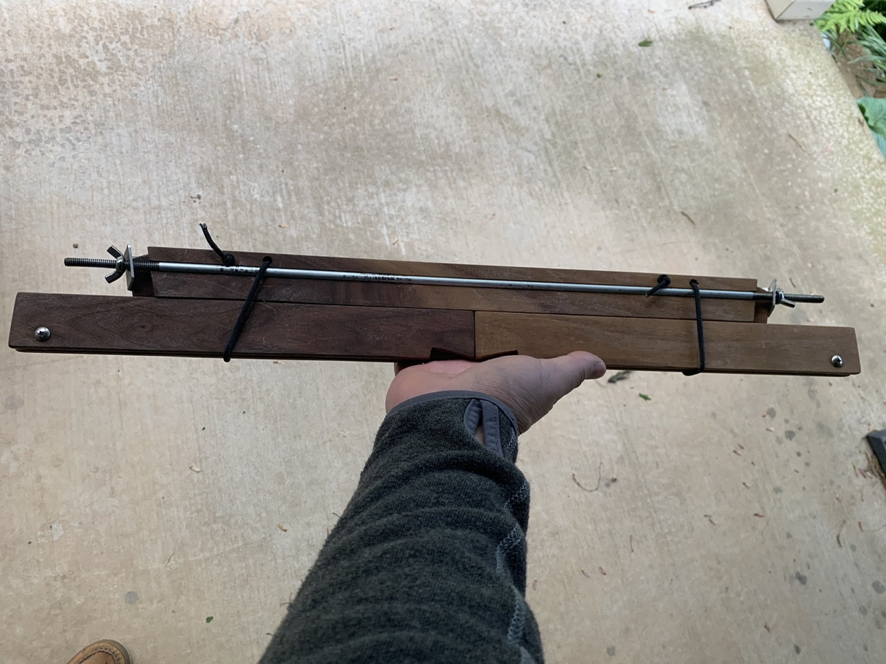

Edges are eased. A few finishing touches have been added. The shock cord loops. Plus I replaced the threaded steel rod with an unthreaded aluminum bar which weighs less. I threaded just the last few inches. Replaced the plastic wing nuts with metal. Filed the threads on the end so I can’t lose the hardware.

Incidentally, I used that Horrible Freight die set to thread the aluminum rod. Not a super challenging job, but it got it done.

Have you compared the functioning between using the cord for tensioning the saw vs. the rod for tensioning?
algale
Posts: 4828
Post by algale »
davebodner wrote:Have you compared the functioning between using the cord for tensioning the saw vs. the rod for tensioning?
That other saw with the spanish windlass (cord) tensioner went to a brother in law so I can't do a side by side comparison with the new saw.
From memory, however, there's a lot of stretch in the cord I used. So round and round you had to go with cord to tension it up.
With the rod, you need very few turns on the wingnuts in opposite direction to put a formidable amount of tension on the saw blade. Whether it is more tension in the end, I don't know. But I feel the rod system puts at least an equivalent amount of tension on but more quickly.
For what it is worth, if I build more of these (and I think I probably will at some point), I am definitely going with the tension rod design. Incidentally, nothing stops you from using a spanish windlass on this saw if for any reason the rod gets lost or broken.
