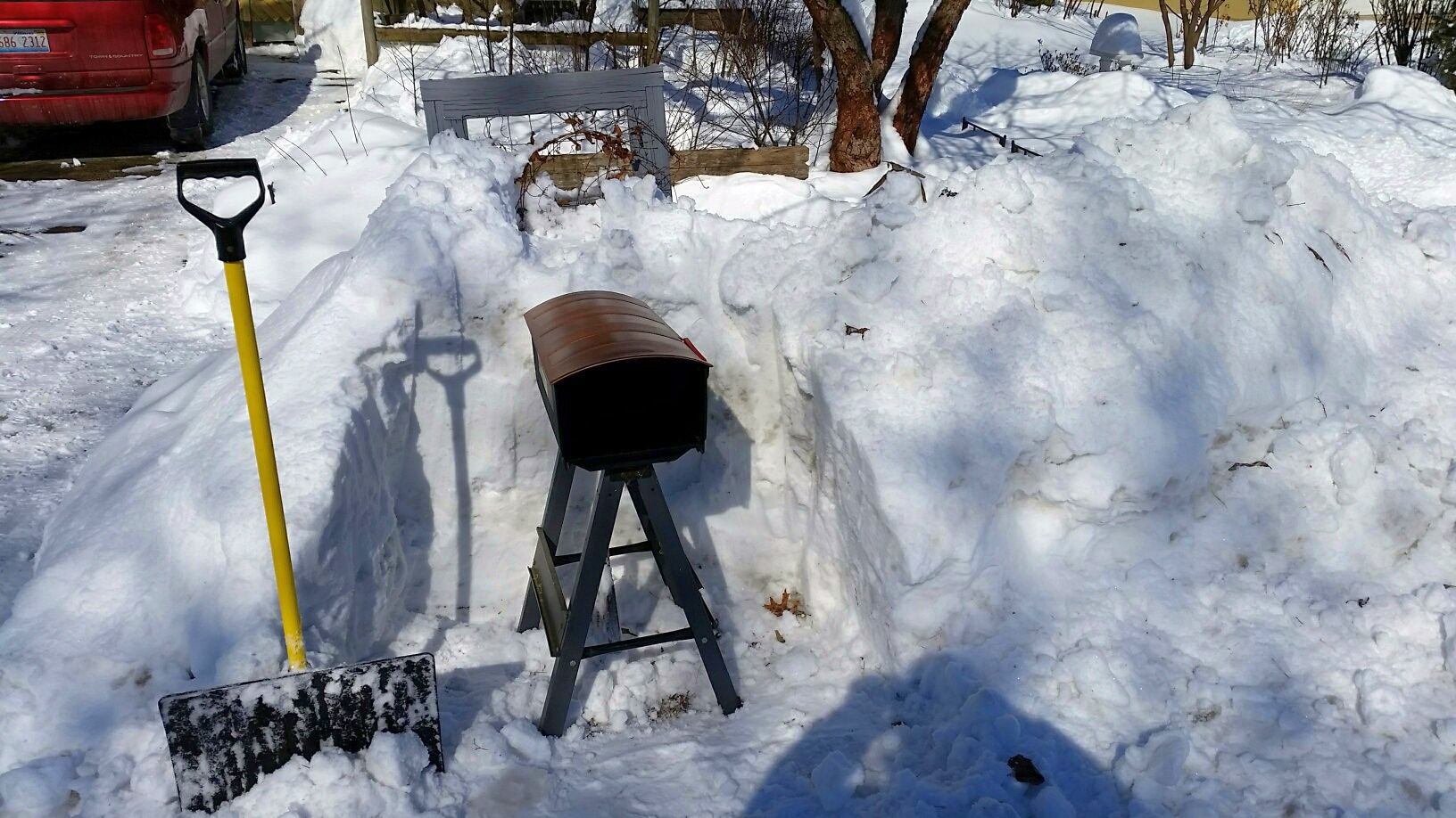

Dug out a hole and the post looks like I can do a temporary repair with some lag bolts. The post looks like it tilted a bit but being frozen in the ground it didn't move much. We have some warmer weather coming so maybe I can get out some clamps and slap it back together for the next few months.

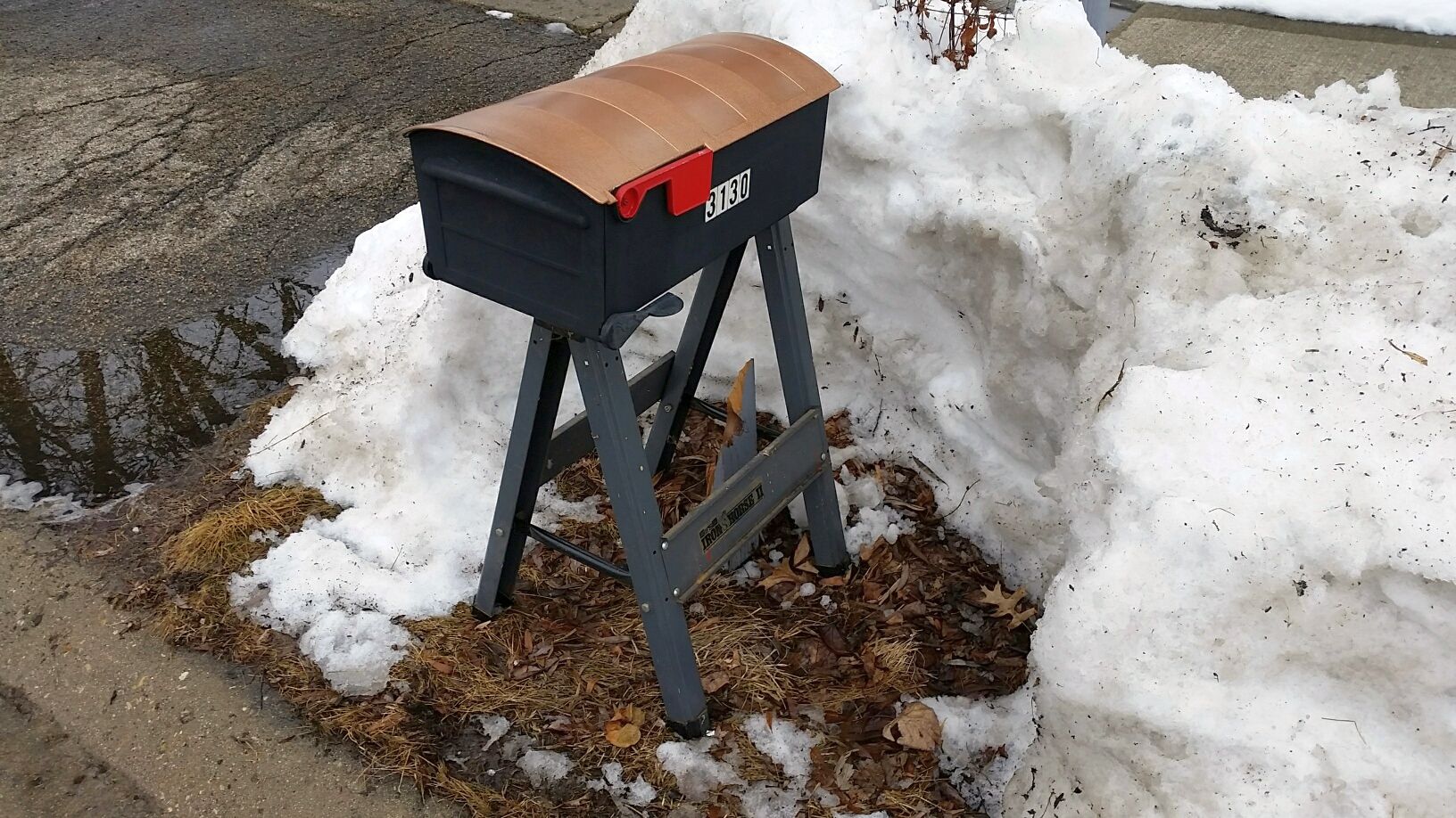

We are open for business as shown. The door is not on yet, still have to try and turn the pin for the hinge. As it is we can watch for the truck then go get the mail as soon as it arrives. Don't want slush spray from cars to mess things up. I can bring the box in at night, well box and saw horse to keep it cleaner and safer.

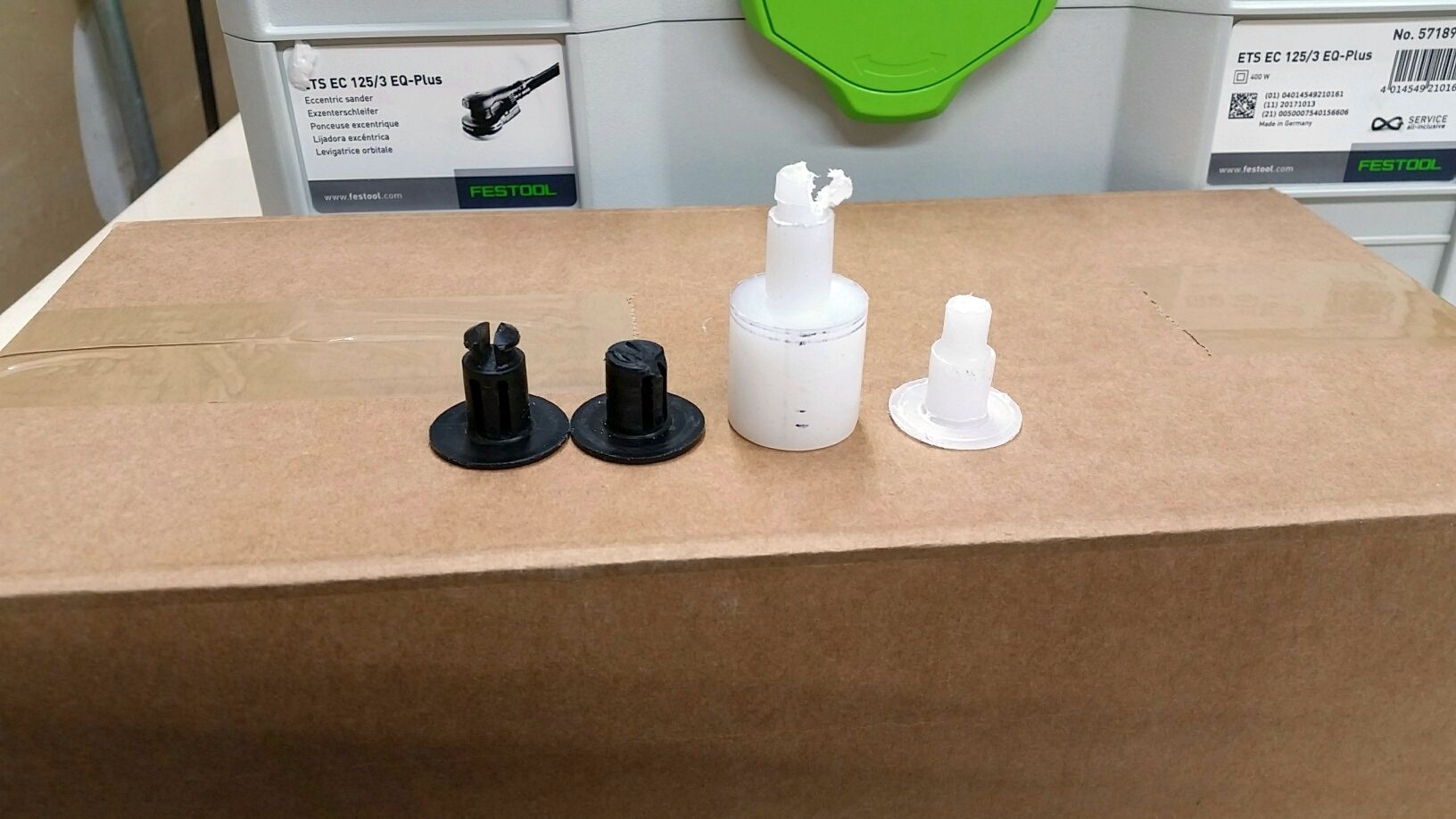

Warm enough to work in the shop today with the heater running. So first up was making the pin for the mail box.
Took two tries, while I was test fitting the first one one side of the notch I had cut went outside rather then inside a broke, I was wondering why it wasn't fitting but the holes are underneath so I did not see the problem until I pulled it back out. Decided to do away with that feature as the plastic I have is not nearly as strong as that design requires.
Here is a picture of the parts, from left to right
Good part
Broken part
First attempt
Working part
Right now the fit is tight but come summer it may not be but then I can add a washer and screw to the end to keep it in place or make a new one out of other material.

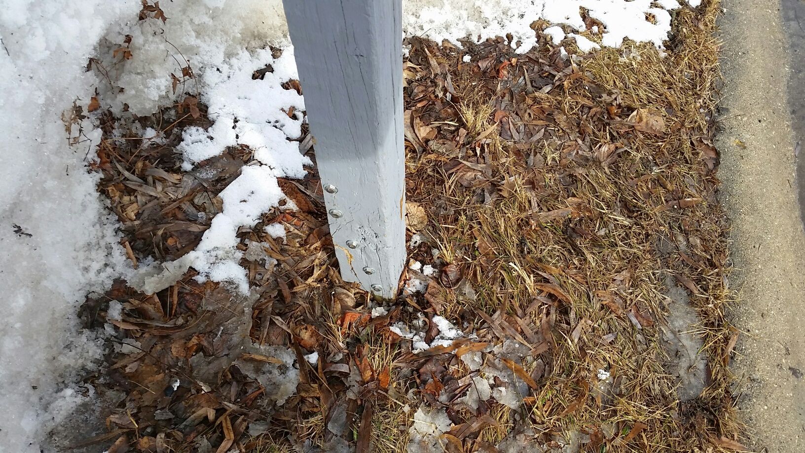

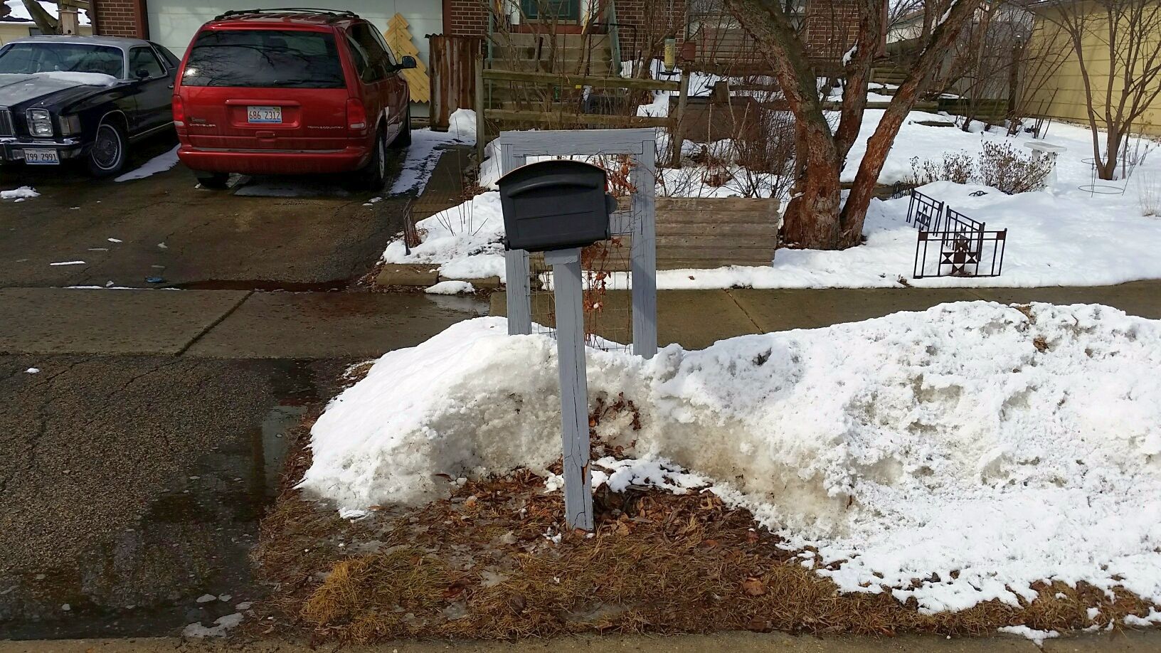

It has been a week now but the repaired mail box and now repaired post are back in action and ready for mail on Tuesday.
Nine stainless steel 1/4" x 3-1/2" lag bolts are holding it together. This side has 5, the other 4.
Yes it is tilted, twisted and not vertical but it is going to work until warmer weather when I can replace it.

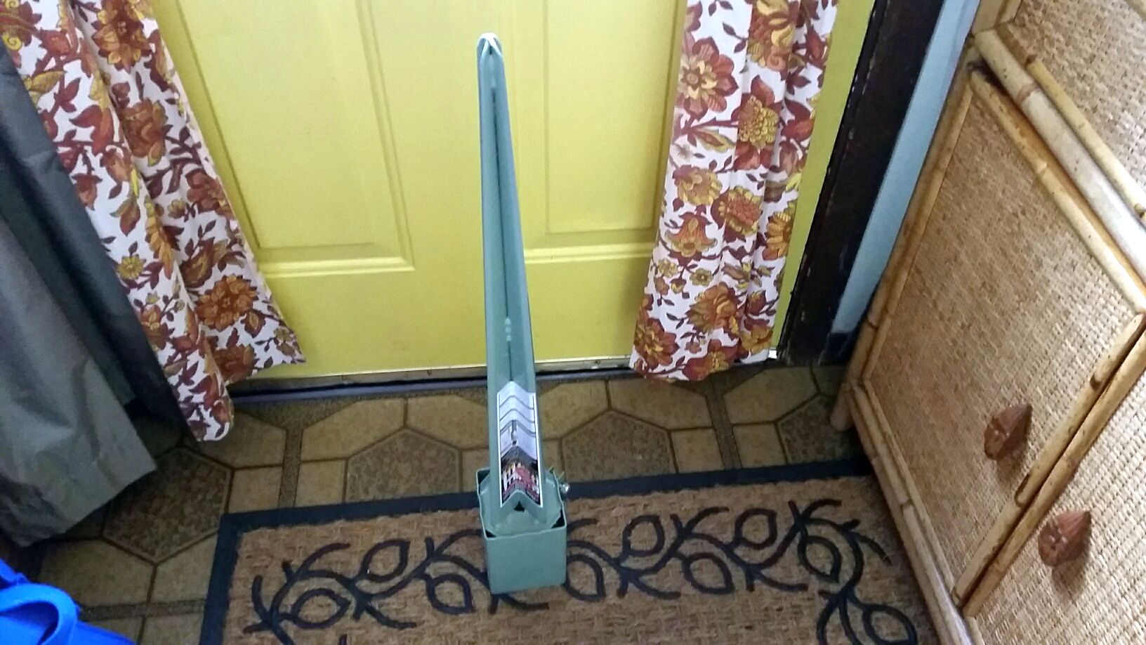

When I was out shopping at Menard's (yes they are having another 11% sale) I got this:
Shown inverted. You put a scrap piece of 4 x 4 then drive it in the ground, no digging required. This one is 24" deep which was the shorter one they sell. Once the frost is out of the ground I see how well it drives in.
The present post is going to be a pain to remove so I might mover over a foot or so and then cut the old post flat to the ground and let nature take is course.
Anyone use one of these and if so what did you think?
I'm wondering how easy it will be to get it to go straight, not a fan of tipped mail boxes.
