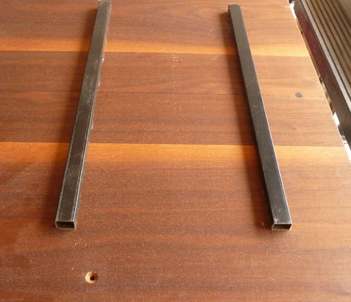

These are from a salvaged patio umbrella. I have several from two different ones. One was too wide. These are perfect and you can add a washer at the bottom easily. It doesn't help for now but with spring here some of those are going to be set out for trash pickup.

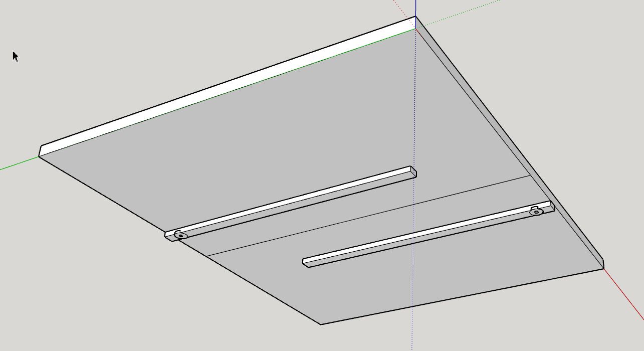

The shopsmith guides are about 19" long and if you were to use two of them and off set them as well as the location of the "T" you could make a pretty large sled. The bar for the 500 without the "T" is even longer at 21" so another possible solution is to get one of each.
Another thing to think about is both an infeed and an outfeed table so the sled has no place to tip to. I know I like to do this with my set up especially at the back.
Re: Miter Guides
In case it wasn't clear from the description here is a sketch. You could also add a wood runner before/after the bar to keep the slide smooth if need be. One advantage is that you have a "T" at the start and at the end of the cuts.
ScreenHunter 30.jpg (49.99 KiB) Viewed 11142 times
