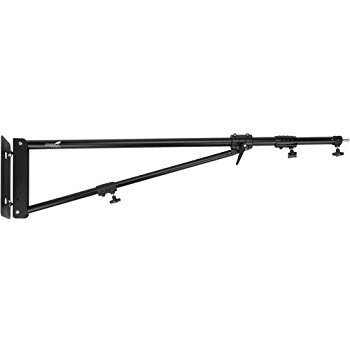

I'm guessing that the door is probably 16' wide? Probably also has an opener on it? That makes it a bit tougher. I want to add a light in my farm shop where it would fall about the center of the raised door but that door is only 10' wide. On it I can just run something like a 2"x6" across under the opened door, hang it from the door tracks and in my case also from a handy beam on each side. Then I can just mount the light under the 2"x6" and the door will open and close above it. 16' plus and an opener shoots that down.
How about a photo lighting boom arm like this pictured, or maybe even one in under the door from each side. No door interference and could swing back against the walls if needed. They could also be swung a bit to just "adjust" lighting. The one pictured said 7'. They could also be made DIY from something like thin-wall EMT or even wood.
