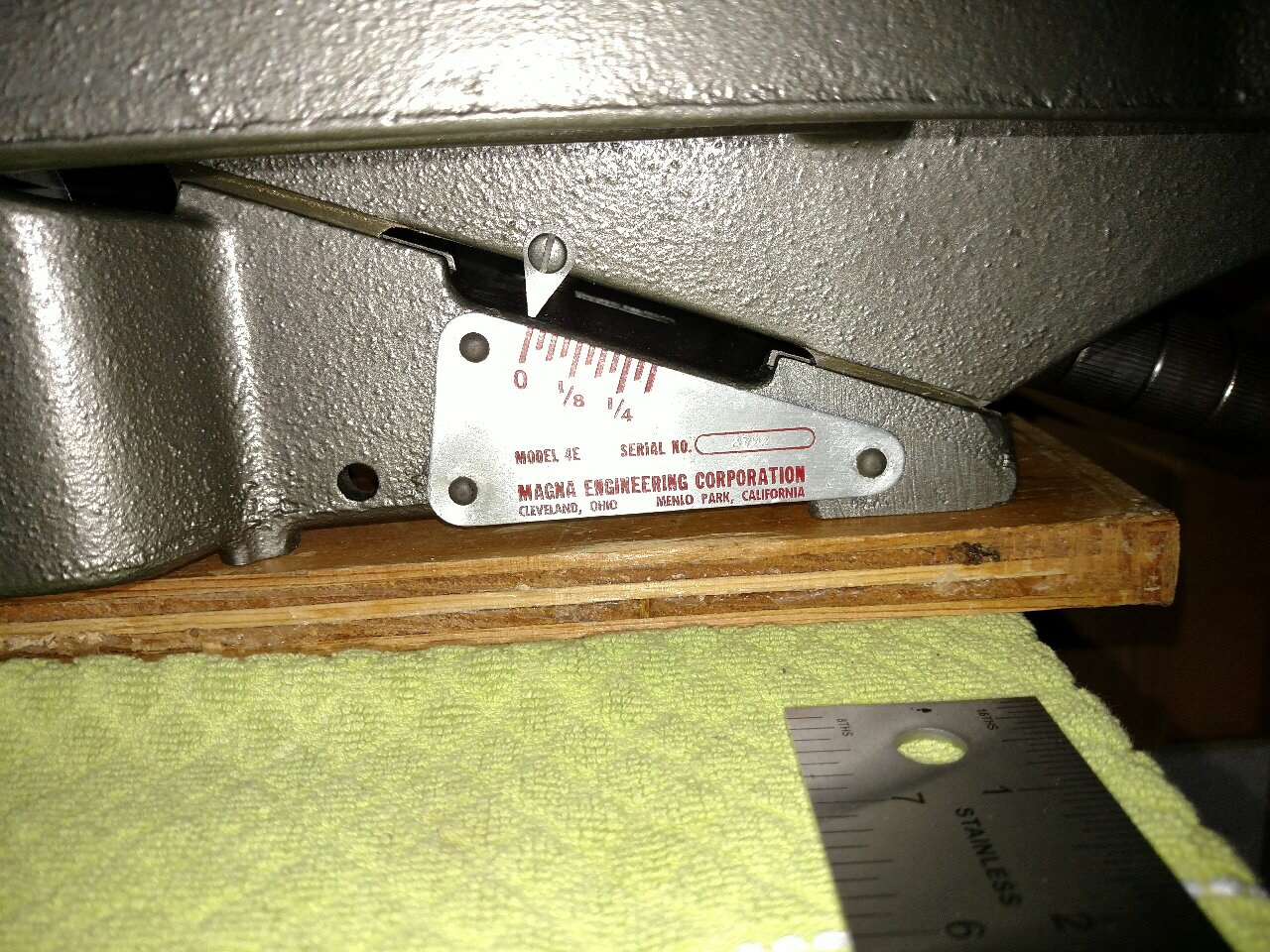

Serial 2792. Guess I’ve got an early one. Thanks for the info.

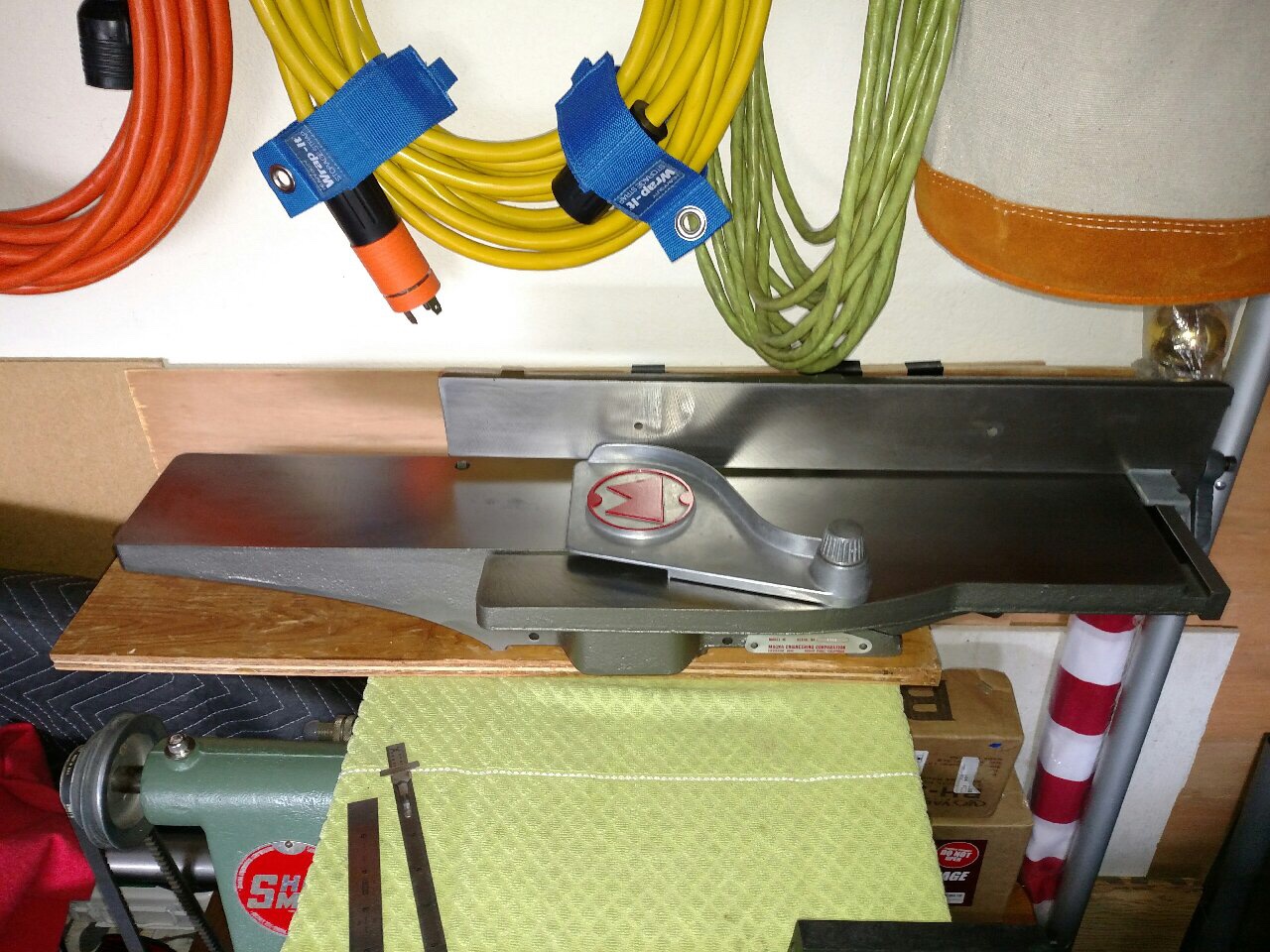

I agree with John, your 4E looks great. Nice touch with the red paint added to the guard's logo. I noticed in the pictures you have it sitting on a piece of plywood. Is it simply sitting there or is it attached to the plywood using the three bolt down holes in the base? Those holes are there to allow the Jointer to be mounted to a homemade table for separate use as a stand alone tool. That could be a start for a temporary mounting for it to use until you can get a replacement for your broken plate. If you do use it for a base do add a hole below the cutter head for chips/dust to go out. That could give you some dust collection not normally found with the Model 4E Jointer.
Below is my 4E Jointer S/N 2145 in front of one of my Jig Saws, both sitting on their storage platforms I made. The Jointer's was designed to protect the mounting plate attached to it while not on my Model 10ER. A slot cut in the platform allows the plate to still be attached to the Jointer during storage. It is made from a simple piece of extra 2" x 8" wood I had left over with blocks on each end to raise it up off the storage cart it sits on and allows the needed clearance for the mounting plate. The socket drive handle and socket on the left side are for tightening the bolt for attaching it the Model 10ER. Having it there always keeps it handy when needed. The picture does not show that they are stored under Shopsmith tool covers. A Regular Jointer cover and the 610 Jig Saw cover works well for the Model 10's Jig Saw too.

No, it is just sitting on a piece of plywood on top of one of my 10e’s table. I will manufacture a swivel plate soon. Have several ideas and drawings now since you provided the dimensions. Hey, I have a jigsaw similar to yours, however it does not have the built-in pulley cover as yours does. Those look really nice, nice storage idea too.

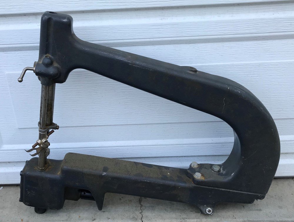

There were two versions of the Jig Saw made for the Model 10's. The first was the one without the built in belt guard and its gearbox cover plate has four screws to hold on the cover plate. The later Jig Saw like mine shown in the picture of my previous post has the belt guard, which really doesn't cover much of the belt. It has two screws that hold the gearbox cover in place. The biggest improvement for the second Jig Saw was the gearbox was no longer open to the rest of the lower frame. The early lower frame was open to the gearbox and saw dust could get in there. My other Jig Saw for the Model 10's is in the picture below. It is currently disassembled and waiting for restoration.
_ _
Unlike the Jointer made for the Shopsmith Model 10E and 10ER these Jig Saws had no serial number. The original version was part number 134-1X and when the lower frame was changed they still used the same number. When all part numbers changed in November 1951 their part number changed to 11 100. They were always Model Number A-34. If you want to know more about the Model 10's you can read my thread Shopsmith Model 10's What When and Where if you have not already. It is at the link below.

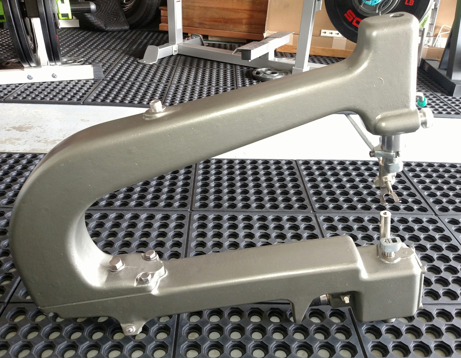

Thanks again for the info, you are a wealth of knowledge on these machines. Here are a couple photos of my newly refurbished jigsaw.
