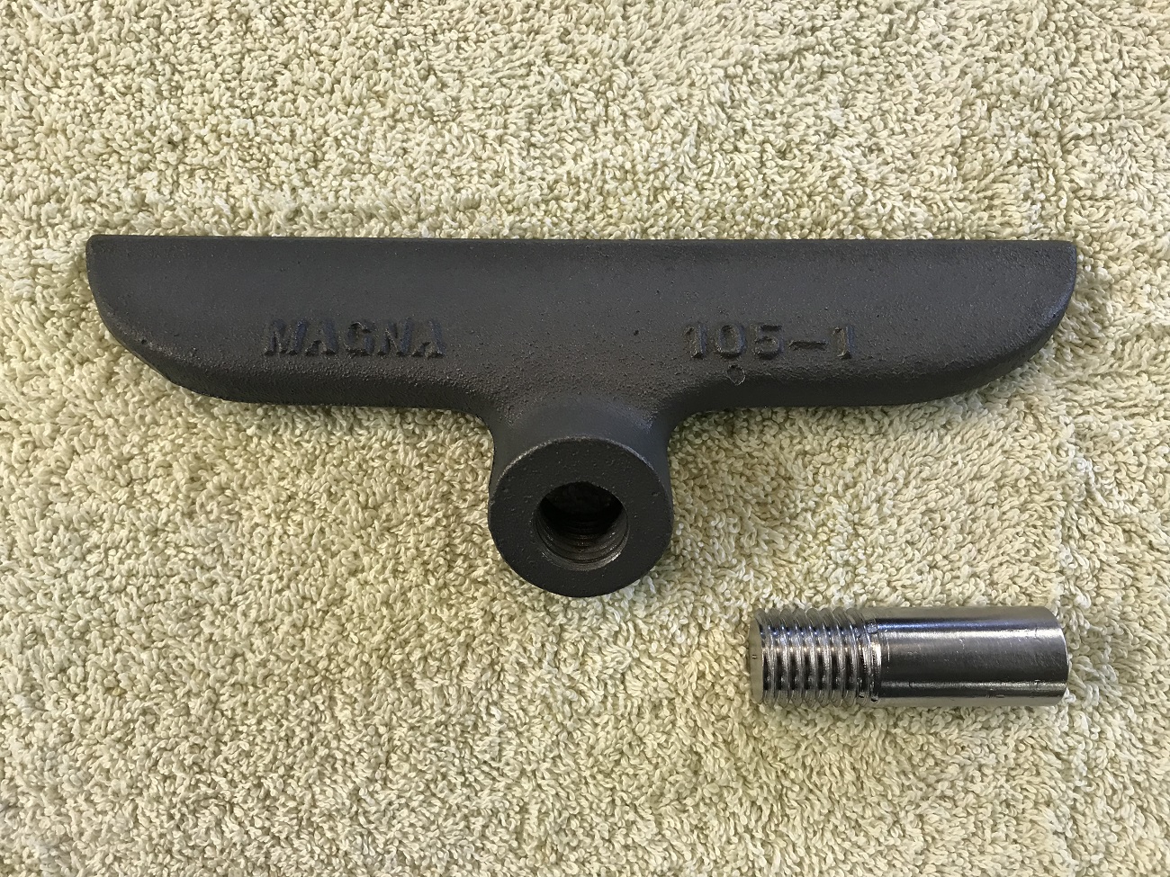

13 Different Lathe Tool Rest, has removable shaft for attaching to the Arm, later it was single Casting. Original Production models have this Tool Rest (S/N 1077)
14 It is hard to tell from the picture but the Base Plate may be different from the production model. The Base Plate in Fig. 1 appears to only have curved angle braces on the inside of the verticals that the Arm attaches to. The Production version of the Base Plate both large and small have a cross brace at the bottom between the two verticals. (Changed on Production Models)
Lastly the motor speed in the original manual is listed as 1750 RPM but actual motors are 1725 RPM. Motor speed listed incorrectly in other early 10E Manuals
Tool Rest from S/N 1077
105-1 Tool Rest with post back s.jpg (738.38 KiB) Viewed 24605 times

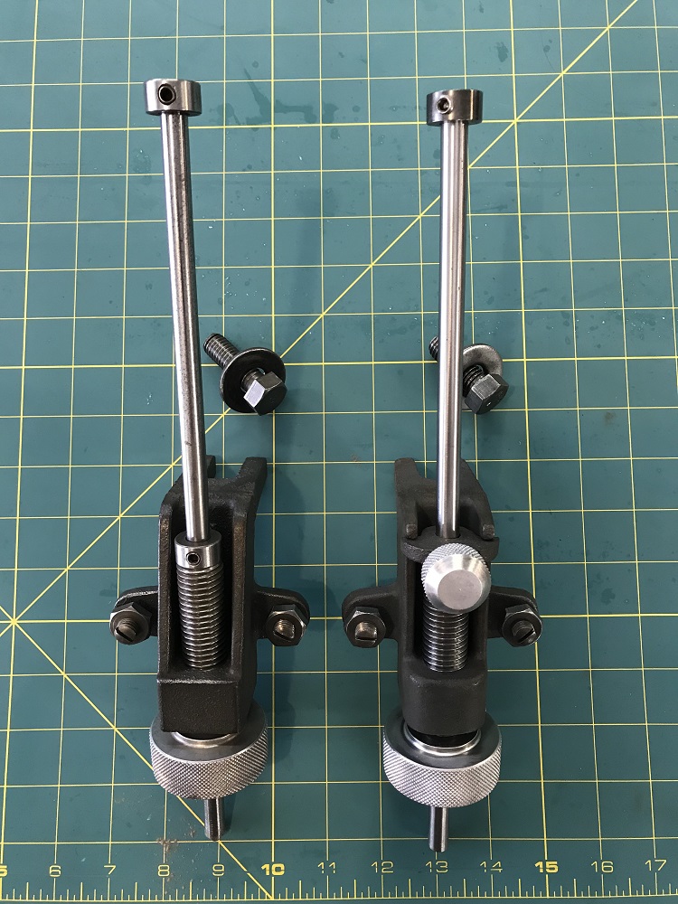

Did you know there is more than one version of this Table Raising Assembly?
Table Raising Assembly 123-1X r.jpg (266.15 KiB) Viewed 24556 times
The PDF shows a different adjustment ring with the set knob than the one on the left has. These are two that I have. I have a third one the same as the one on the right but has a repaired main casting near where it bolts to the carriage.

Yes I know that there are two versions because I have the one on the right in your picture and the document shows the one on the left.

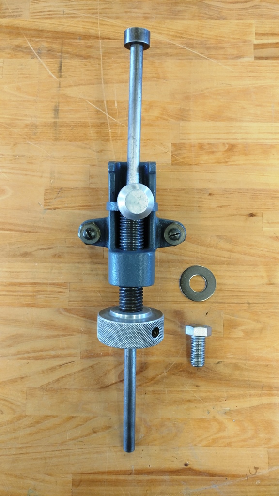

Now consider this, which I just noticed today when my original pristine document arrived from an eBay seller. I believe we have all thought this was the first table raiser from the 10E. The picture in the document in question shows what appears to be a 10E based on the fence. There is no date on the document so the logical conclusion is that this is the early 10E table raiser.
Here is a quote from the Magna document...
"Table is raised quickly to a position near the desired setting. It can then be raised by a screw adjustment to the precise setting required. No slow, tedious cranking to move the table up and down, but precision where precision is needed."
No slow, tedious cranking What does that mean if this is the first table raiser?
I submit that this table raiser was produced towards the end of the 10ER production. Magna obviously made an effort to improve the design so why were so few made unless they came at the end of the 10ER production. Also this table raiser is a much more sophisticated design than the common table raiser. It is an upgrade compared to the common table raiser (i.e. 10E to 10ER). Are there any dated documents to show something different?
