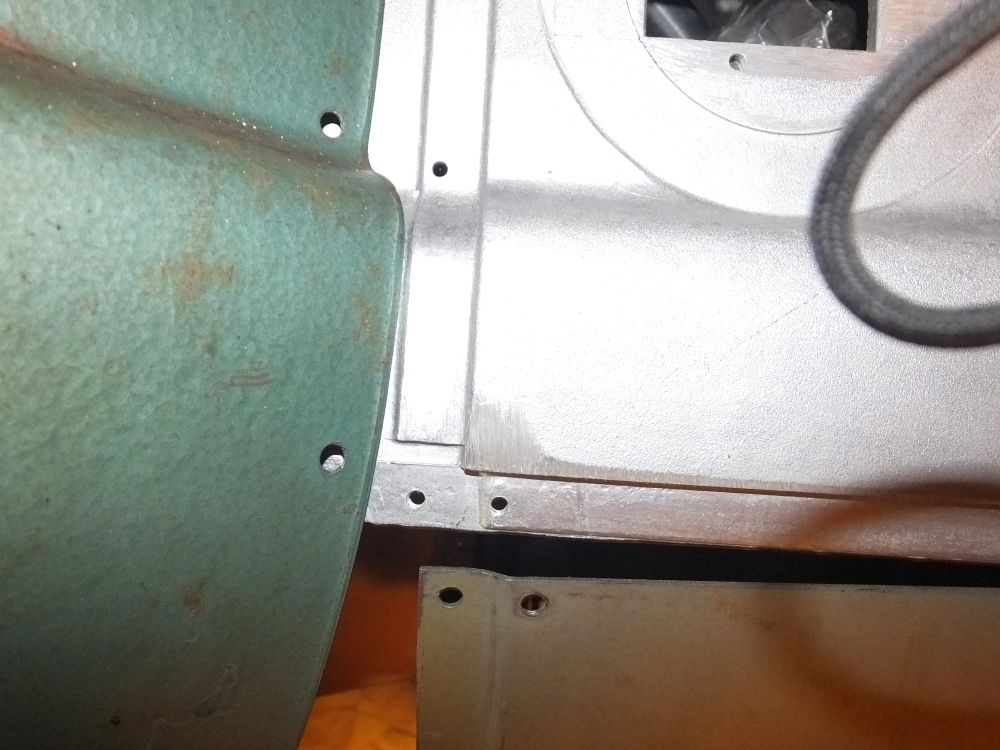

The "A" greenie headstock casting, belt cover and motor pan were e-bay purchases and I know nothing re their history(no vent plate/SN). The casting has the rectangular speed control hole and no access hole.
The 8 belt cover screws are one top, one bottom(motor pan), the usual two near the 'bump' two more at the casting motor pan juncture(very close to the typical motor pan screws) and 2 more low on the motor pan(the extra 2).
It is destined to be a Power Pro headstock(sigh some day!!!).

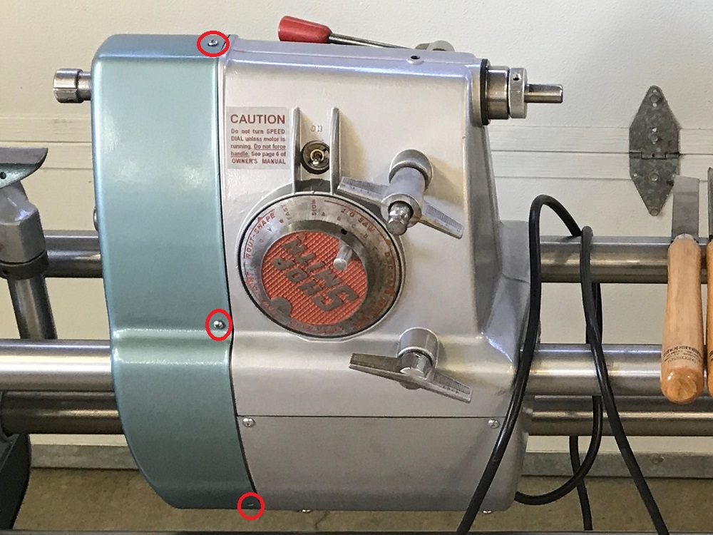

AS for the 8 screw holes
Below is a picture of one of the two "Geenie's" headstock that I restored. Note the screw hole locations circled in red. Sorry the lower one does not have the screw in it yet and of course we can't see the bottom one.

The other two(one on each side).
GREENIE 8 HOLE BELT COVER.jpg (157.43 KiB) Viewed 8125 times
I have to assume someone decided they were unnecessary.
They all appear to be 'original'.
Again history/vintage unknown.
Posts: 4534
Re: Improved Source of Information
It does all look original. Maybe one of the first Mark 5's produced.
