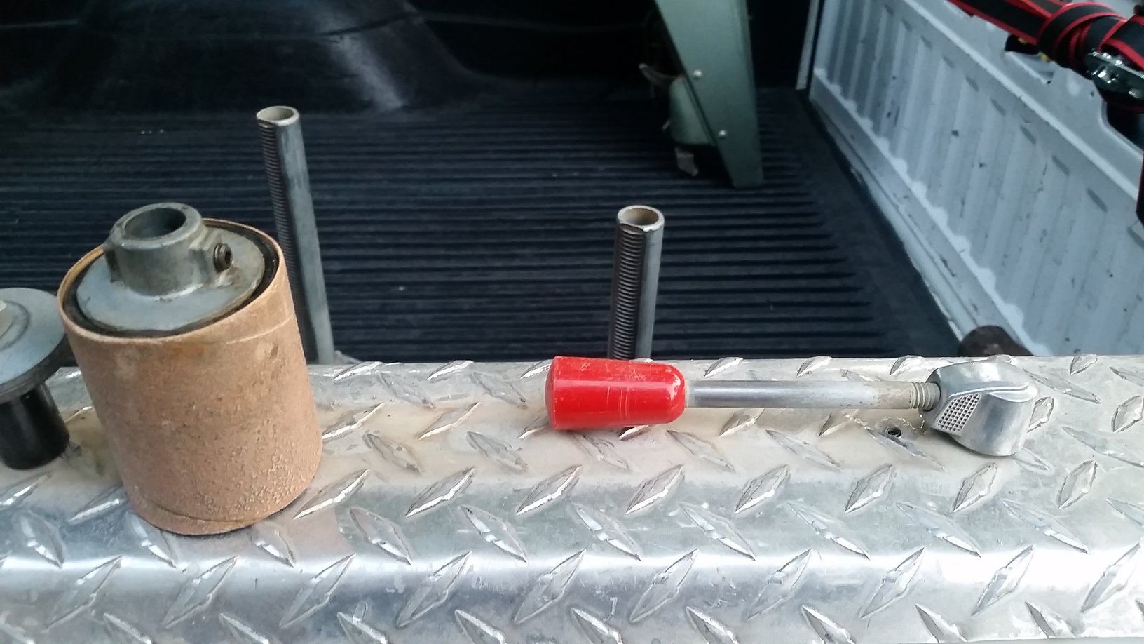

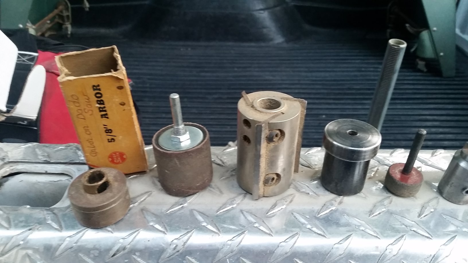

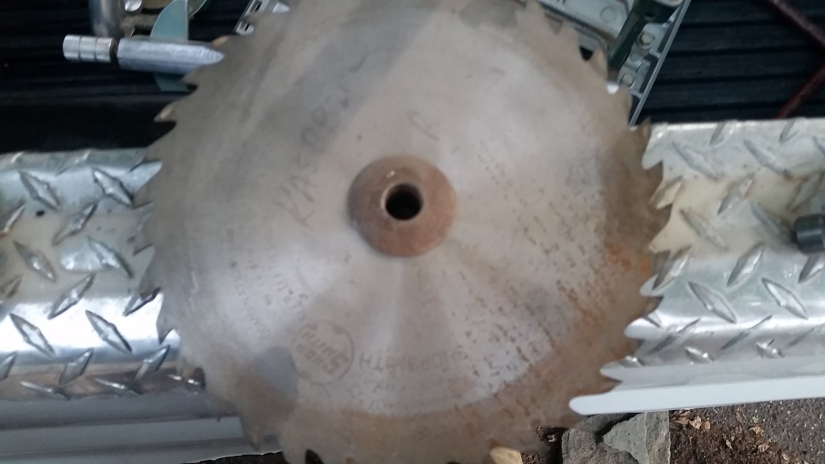

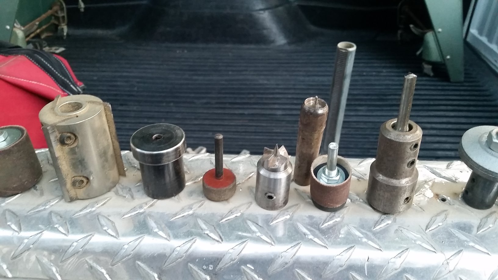

I finally resized my pictures they're spread over 2 posts on 2 pages. I'm all in this machine and accessories for $125 and it seems to work perfect. So I don't mind throwing some money at it make it the best it can be especially because I can do it over time, it's easier to spend 2000 dollars over 2 years than all in one shot. Plus I intend to buy every accessory possible.
