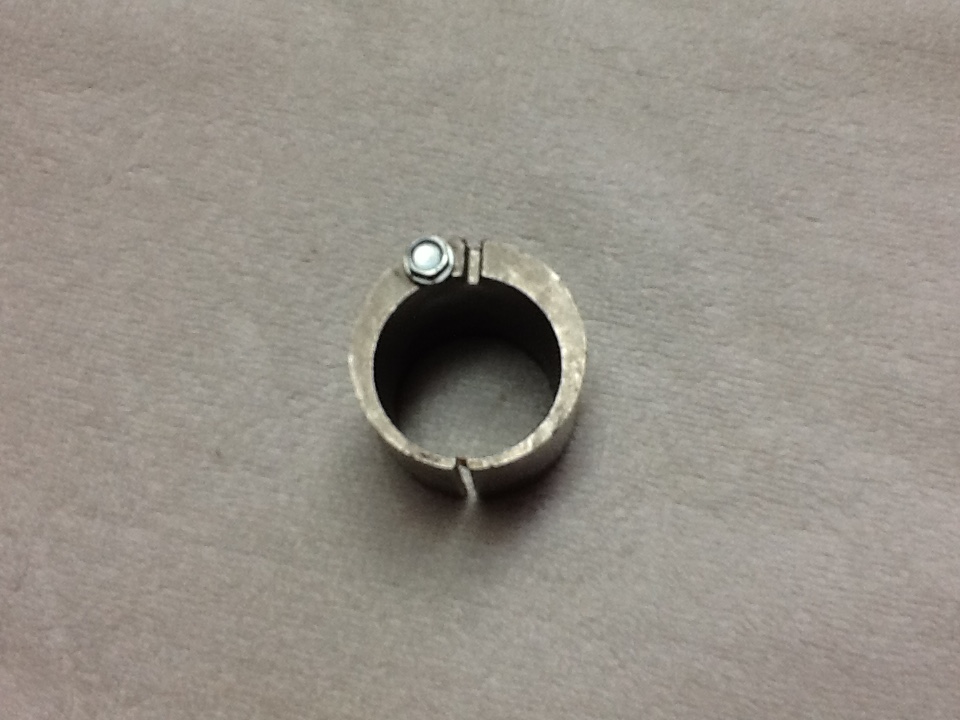

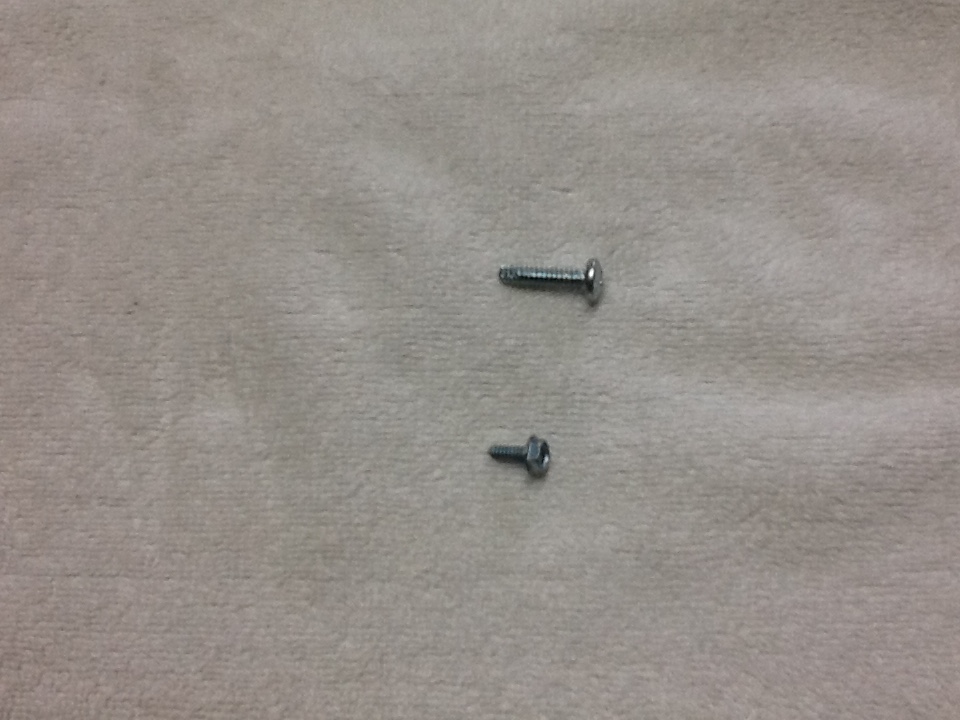

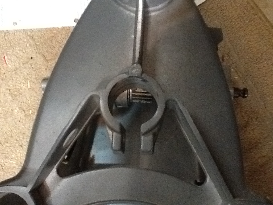

I bought both screws from Shopsmith (they were only $ .99) to see what I was looking at.
The bottom 3/8 inch screw is what I removed from eccentric bushing
holding the idler in the housing with the ears
eccentric bushing.JPG (177.84 KiB) Viewed 3897 times
Housing with ears.JPG (181.14 KiB) Viewed 3897 times

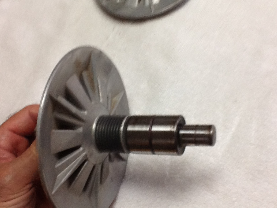

Here is the idler
(I didn't remove the key and the sheave.)
From the first picture from Everett, it looks like the top 3/4 inch screw served the same purpose in another configuration.
This clears up alot.
Thanks for all the help!

IIUC the two screws serve two different purpose.
The hex head screw prevents the BEARING from exiting out the rear of the eccentric.
The pan head screw prevents the ECCENTRIC from exiting the headstock.
Belt pressure against the idler sheave pushes the stuff out. The screws provide a limit.
