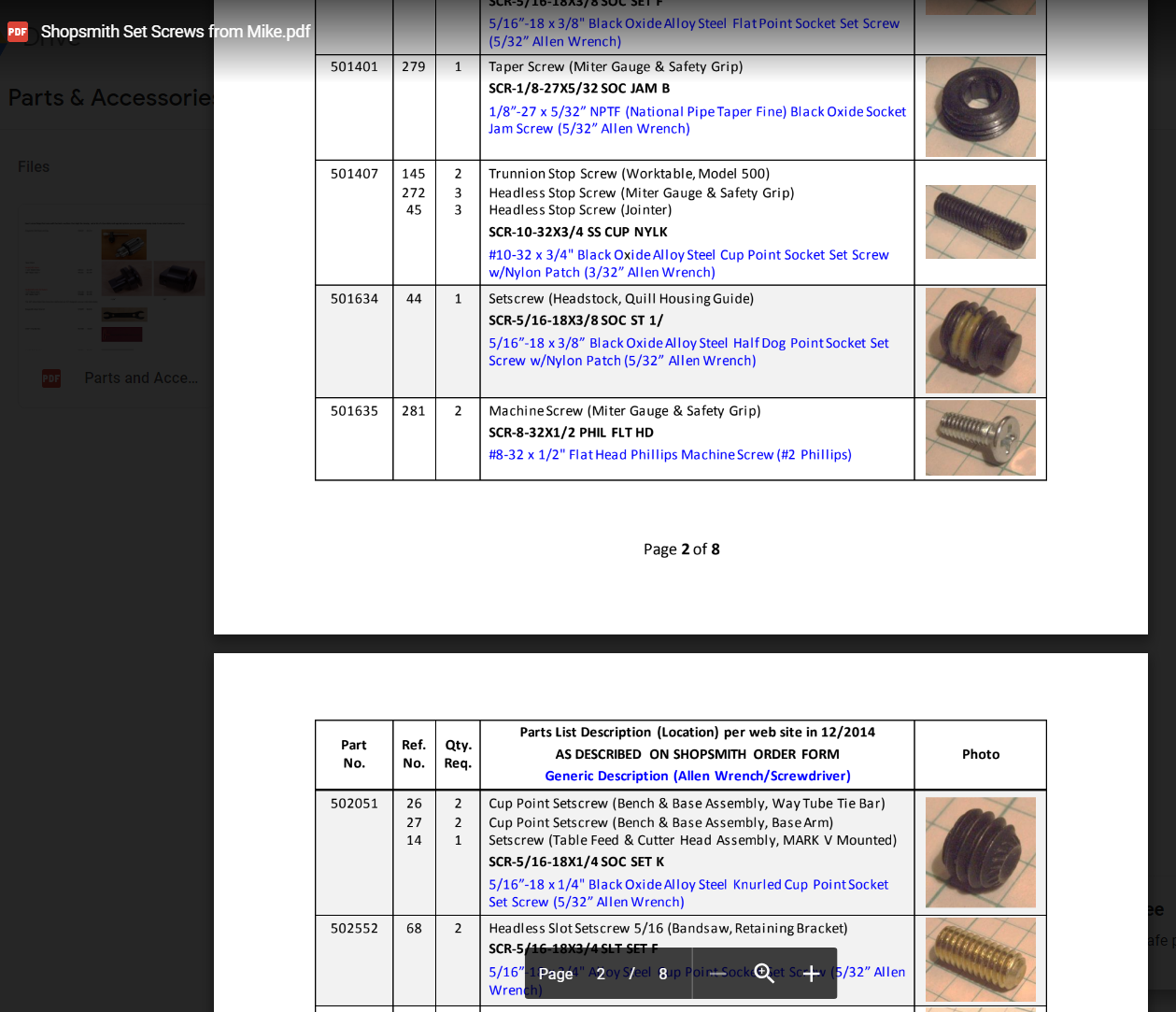

Just a follow-up... In the process of restoring the first 3 Shopsmith Mark 5 manuals, I would be remiss if I did not point out that even though part number revisions and such have happened through the years, if one looks up a screw or setscrew in the early manuals, the description included the dimensions of the screw within the text listing. Now it just says setscrew...
Here is an example
Current On-Line manual for Shopsmith Mark V Headstock:
44 501634 Screw 1 4.44
44 is the set screw on the back side holding the Quill Advance and is covered with putty and painted over at the factory.
In the early Greenies Version 3 Manual:
P1014 was the set screw for the current Item 44
However, the P1014 Description was Screw -- Soc. Set 5/16-18 x 5/16
In the "Shopsmith Set Screws from Mike.PDF" On My Google Drive - shows 501634 as 5/16-18 x 3/8
See photo from that Document below.
I agree it would be nice if it could be updated with the Mark 7 Metric Set Screws in the DVR Motor.
Everett
Set Screws from Mike.png (403.85 KiB) Viewed 6891 times

JPG wrote:They did not however include the tip information.
True, but I think they were all cup tips, at least in the beginning. Were there any "common" set screws back then that were other than cup?
Posts: 4547
Re: set screw
From John,
The Jig Saw also used an Oval, Cone and Full Dog set screws. The Mortise Attachment and Jointer/Shaper Fence used a Flat Point set screw. See the attached PDF for Model 10 and accessories set screws.
10E-ER Set Screws.pdf
(120.89 KiB) Downloaded 1092 times
Re: set screw
Quill stop/anti-rotation was half dog.
Arbor set screws were oval.
Eccentric retainer set screw was cone.
Yes most others(assembly fasteners) were cup point.
The anti-twist bench tube monster was oval.(first slotted, then hex socket).
Nylock was another variant.
