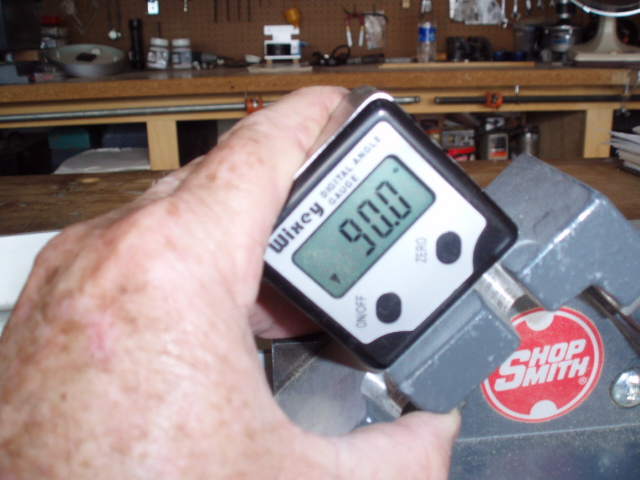

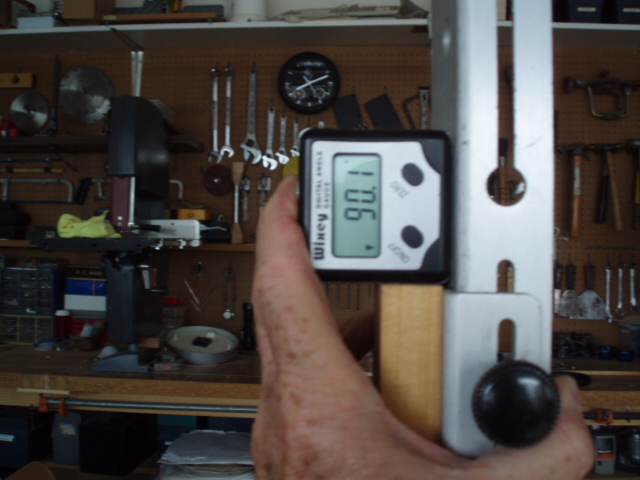

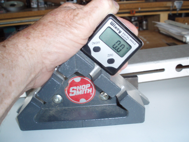

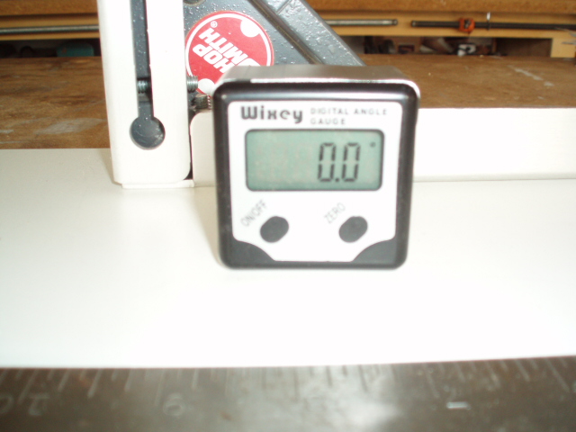

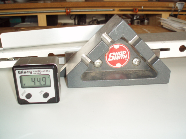

bettyt44720 wrote: i understand the concept of the miter-pro, however the miter-pro must have a perfect 90 degree angle regardless of a slight variation of it's relationship to the saw blade. mine and i suspect the one that spike had is not a perfect 90. if you put a square on my miter-pro there are gaps not a good 90 degree corner.
Have you completely dismantled your miter-pro so that you could accurately measure the machined corner bracket]1931[/ATTACH]

dusty, no i haven't taken it apart yet. i don't have a wixey yet. on my wish list though. in the first picture where your hand is i put a large framing square. over both of the extensions and it is not square. will probably have to use some shims to make it square. however for the money the miter-pro should in my opinion be square. the paper work does not include alignment instructions like it does with the mark 5. and certainly the one used in the ta should have been squared up. spike said it was because 8 different people made the parts. there was only one setup, each person pushed a board through with feather boards on the table and on the fence. the miter-pro had only one setup. the stop was never moved. the frame was/is not square.

Use of the Wixey is obviously not a necessity. A good square will show you what you need to know; and I believe that is to verify the accuracy of the square corner on the milled aluminum part.
I will be real surprised if it is not very nearly perfectly square.
In other words, I believe something other that this part is causing your problem
